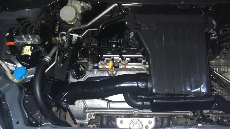

By Vacuum Leaks, I mean the air piping in the engine, go look at your engine bay patiently and you'll see, that there are three sets of pipes. One set is thin pipes, those are the fuel lines, the medium sized ones are the vacuum pipes (Air Pipes) and the large ones are cooling pipes (Radiator Pipes). Check if any of the air pipes are leaking/cracked/soiled/unplugged. You can check for leaks by getting a Carb Cleaner spray.
Start a cold engine, and then briefly spray over each vacuum pipe, if you find a leak the RPM will change instantly and you'll notice, if no leak is found in the pipes, the leak could be in the Brake Booster, to check that grab a plier (Plass
) and squeeze the air pipe going to the brake booster, if your RPM changes the leak is in the Brake Booster.
Now that this is out of the way, unfortunately my CEL hasn't vanished, I've been busy so haven't been able to give the car any time. I've personally checked the Vacuum pipes by the above method, I found no leaks in mine which is more of a disappointment than a relief, cause this problem is still a mystery. as for the situation, let me describe my car to you, since we both own the same thing.
The car looks absolutely perfect, as you can see in pictures, works flawlessly, no hiccups, no hesitation, no misfires, no weird sounds, nothing at all. Everything is perfect. The only problem, is that it gives a CEL with P0130 Oxygen Sensor Circuit Malfunction Bank 1 Sensor 1 code, and gives 8-10km/l fuel economy, which I know for JDM Swift is bad.
