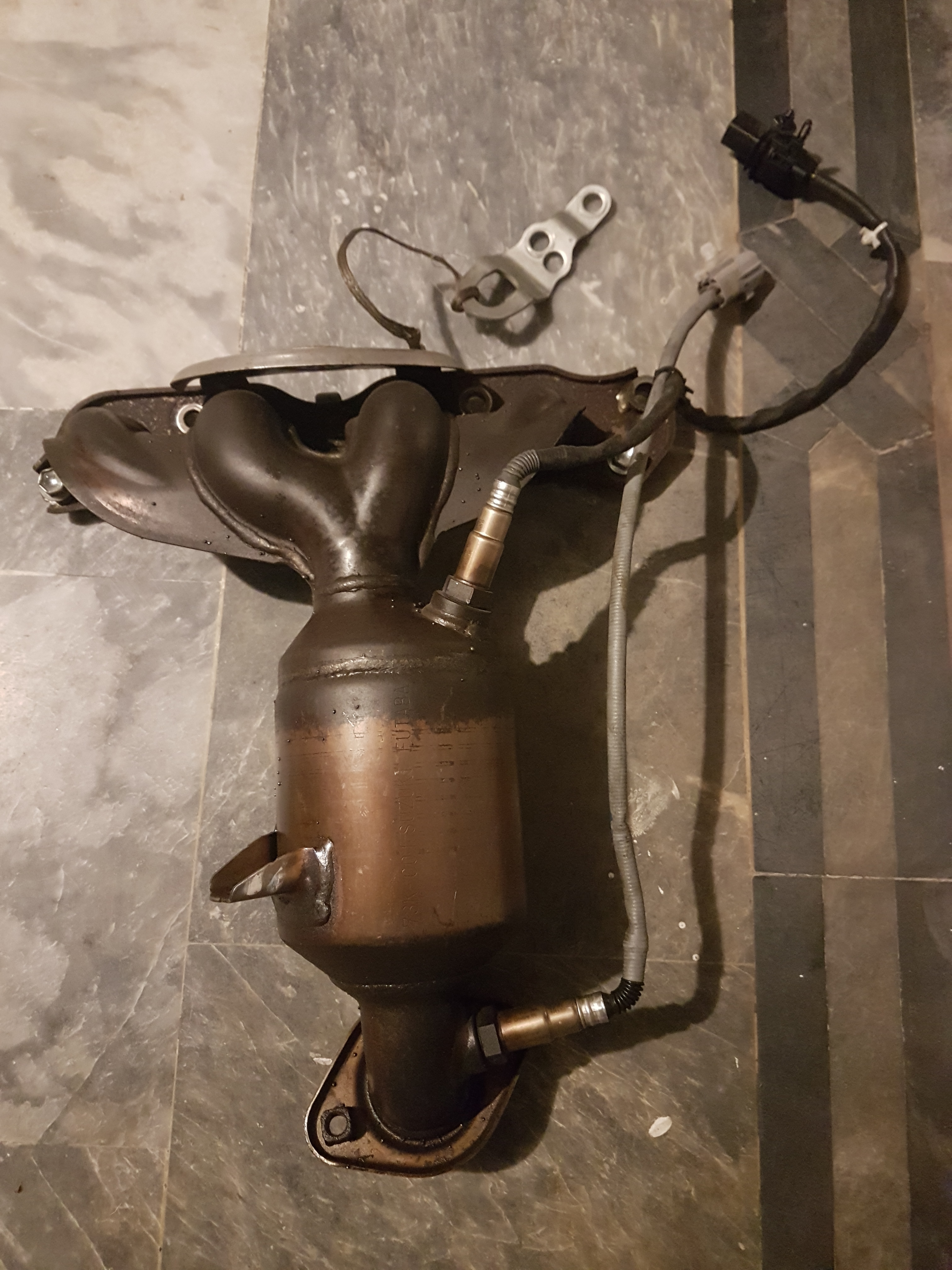

Apparently, the most major problem, was the CAT. From the point of view of the O2 Sensors socket, it looked fine. But, eventually, I had it taken out to get it cleaned in case that might work, to my surprise, it was only visible after the CAT was taken out that it was completely BUSTED. Choked from all the sides, and a molted mess from the center, the only part actually normal was the part visible from the O2 sensor socket
What luck, eh? Not having the budget for a new CAT at the time, I chose to get it emptied, and voilà! The car was perfect, the mileage shot up from 9km/l to 15-16km/l I was so dang impressed, I thought this was the problem. The car was perfect, except the CEL still came on, with the same code. I thought maybe it's cause the CAT is empty so the computer isn't receiving the proper signals. One thing I did, after emptying the CAT was replacing the new primary O2 sensor( the one I ordered) with the old genuine one, thinking that now the problem is solved so no need for this one, I should replace it with the original. I couldn't care less about the CEL at this point since the car was perfect, great fuel economy, acceleration and everything.
