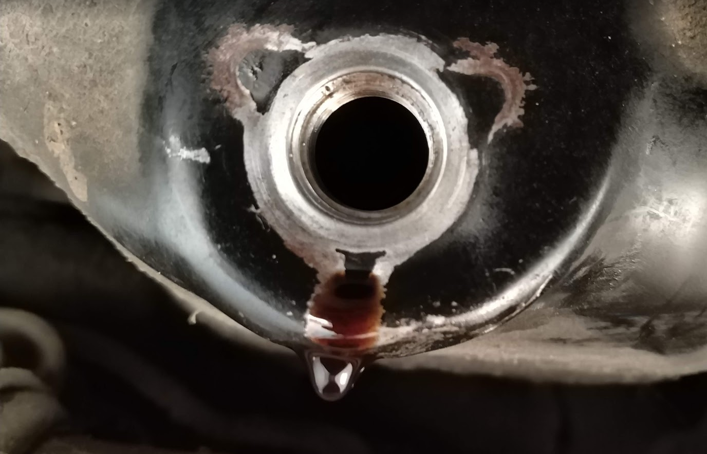

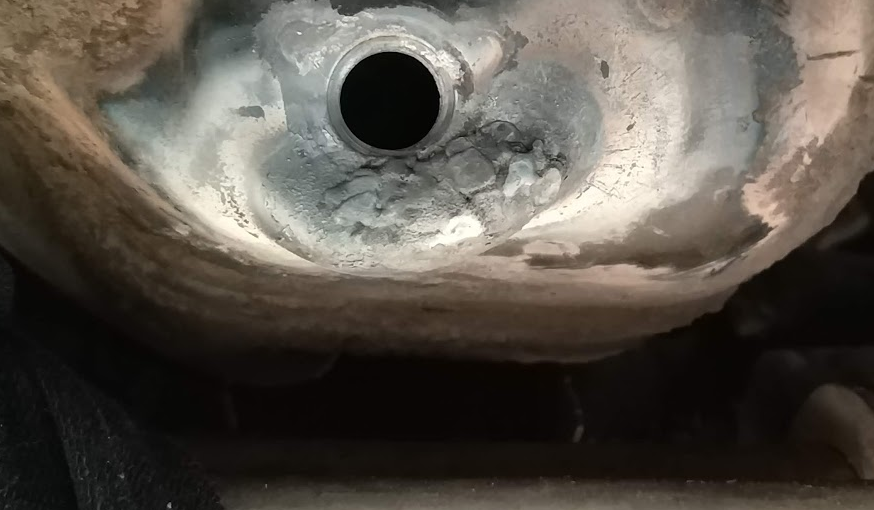

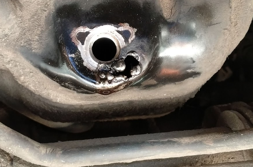

After 4000KM running I opted to oil change and found there was a tiny leak just under the drain bolt, which was not leaking before because of washer covering it.
Made a mistake of using electric welding to cure it, but welder bro went a bit wild,

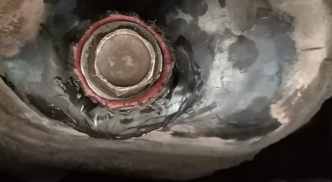

Next day, fixed it with gas welding at closest denter,
Finalized by magic epoxy,

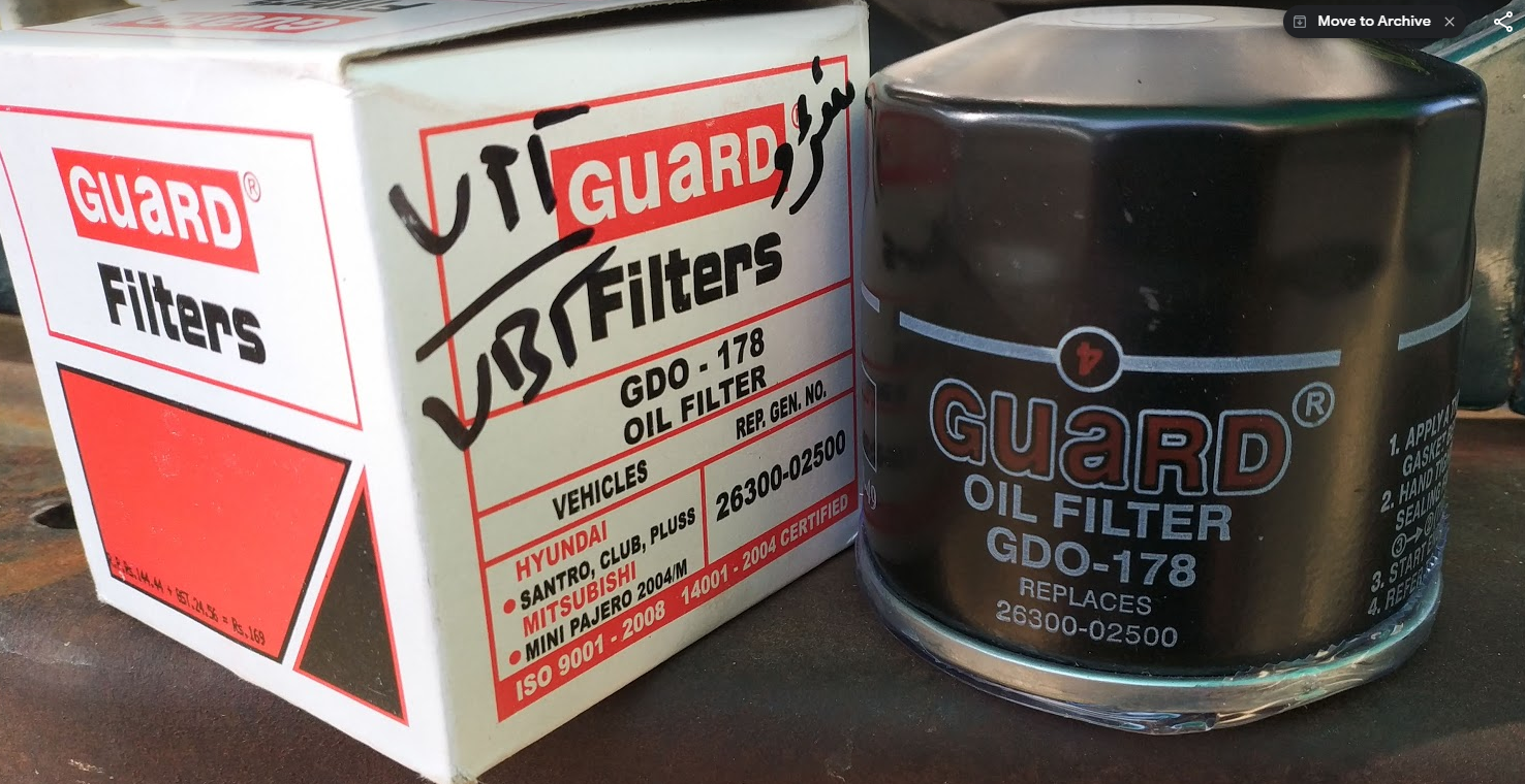

I forgot to purchase VIC 901 oil filter from Plaza, so had to buy another brand from nearby shop. Guard GDO-178 is compatible with Pajero Mini,

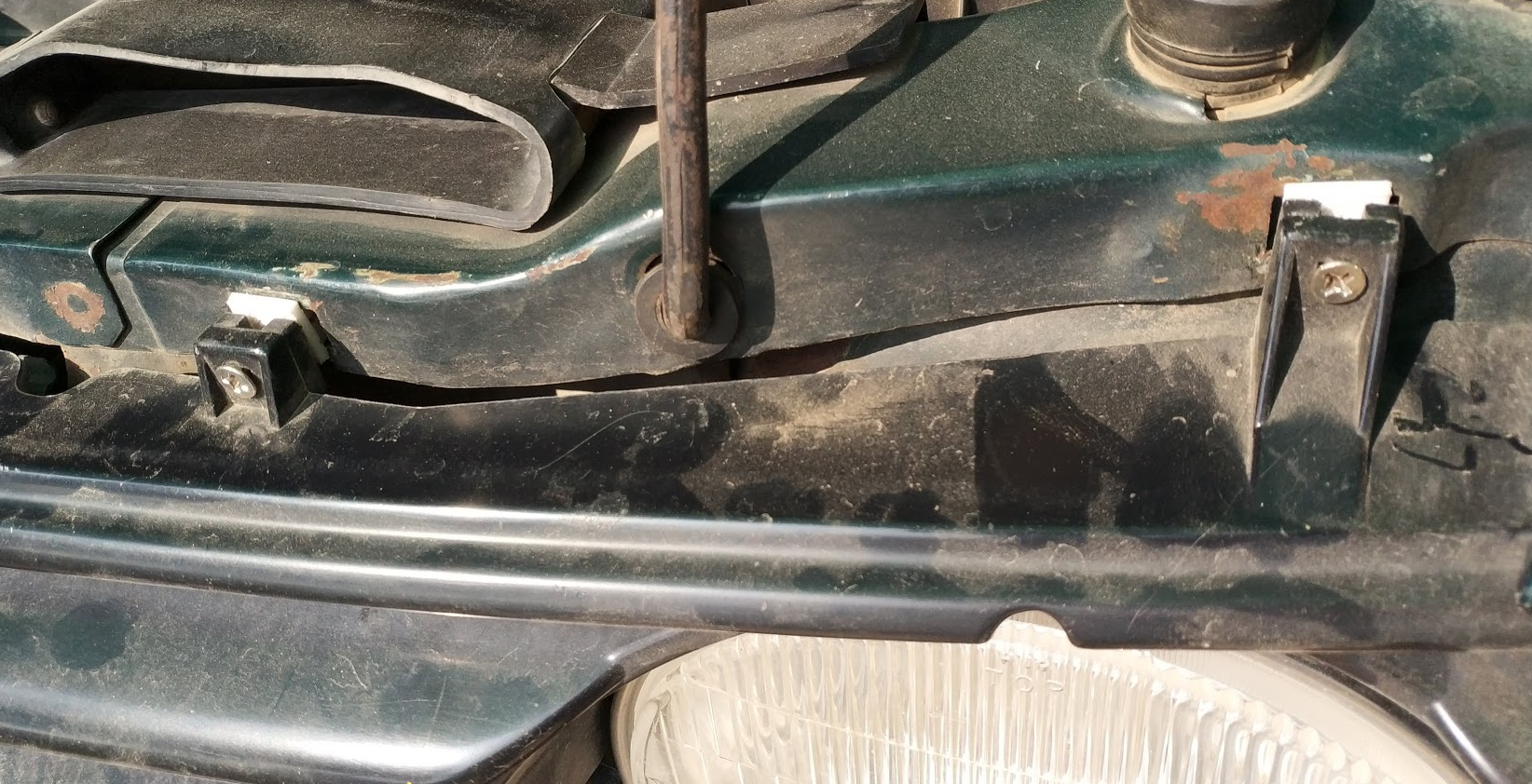

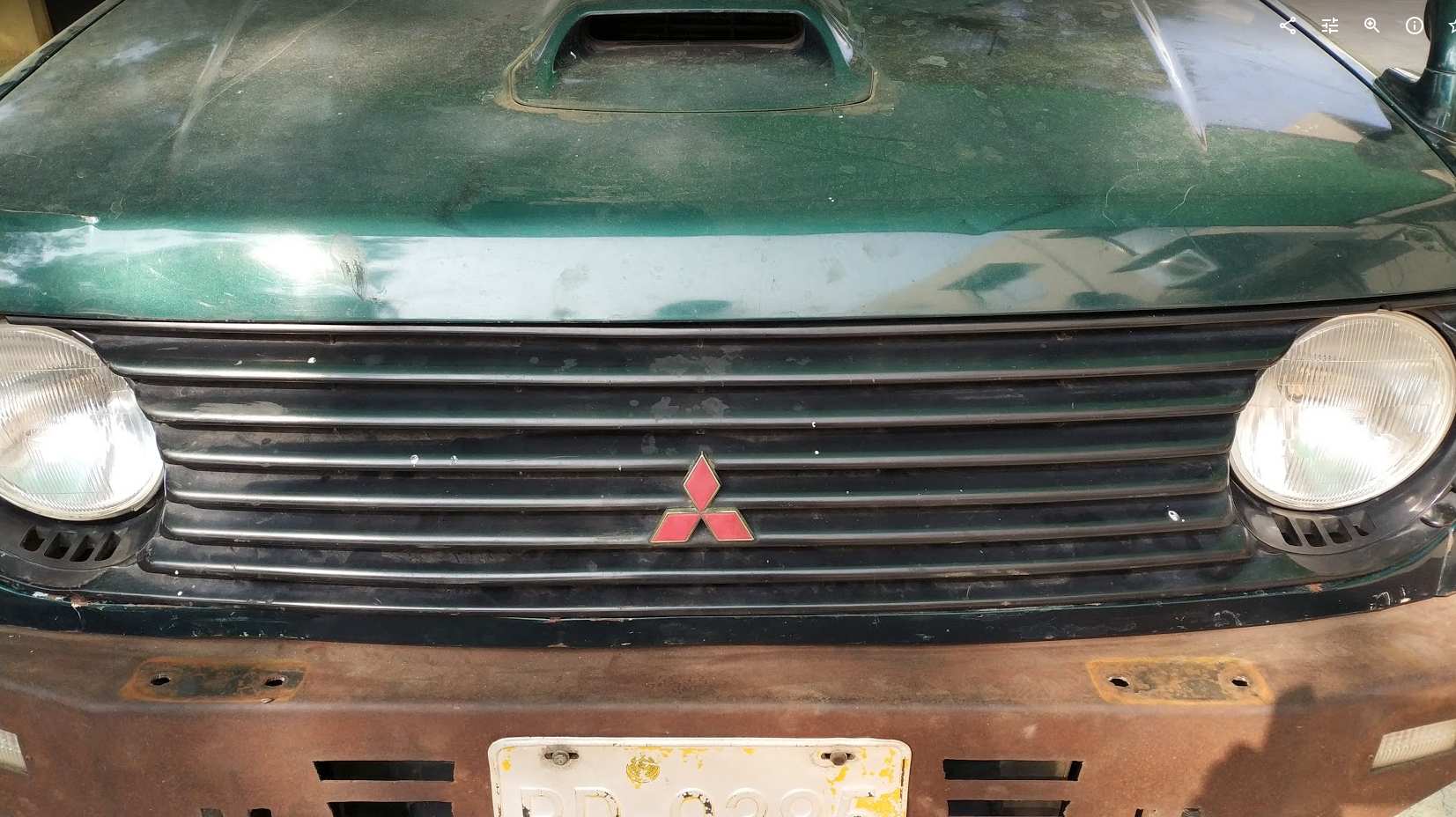

- Front Grill Fixed with 3D Printed Clips

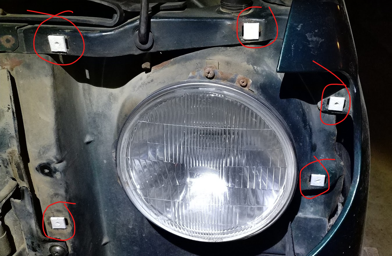

After I removed AC radiator fan with burnt motor, I needed to fix the front grill back. But those 18mm X 10mm plastic clips were nowhere to be found in market. Previously, I got it fix with nut-bolt combos from denter, but putting it back would be really tedious job for myself.

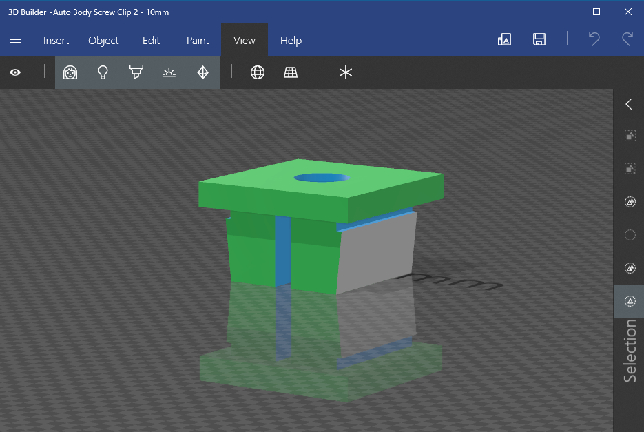

So, I fired up 3D Builder tool on my laptop, designed the clip in couple of iterations,

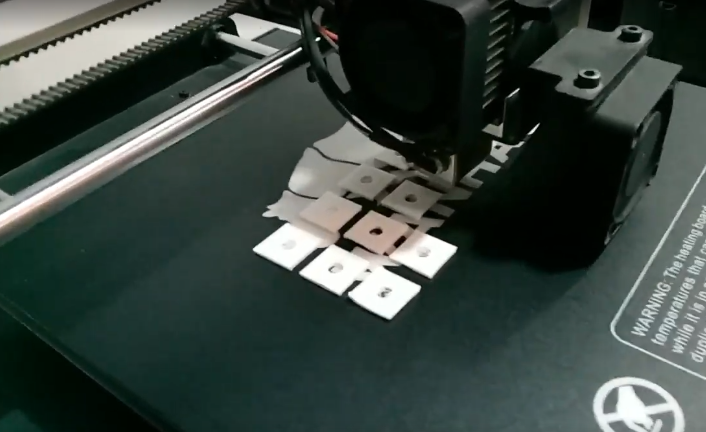

3D Printing 14 of them took about 2 hours,
The clips came out perfect,
Front grill is back on temporarily, and this time it was really easy to fix,
Lesson learned, don't use wrong tool for the tiny job.
