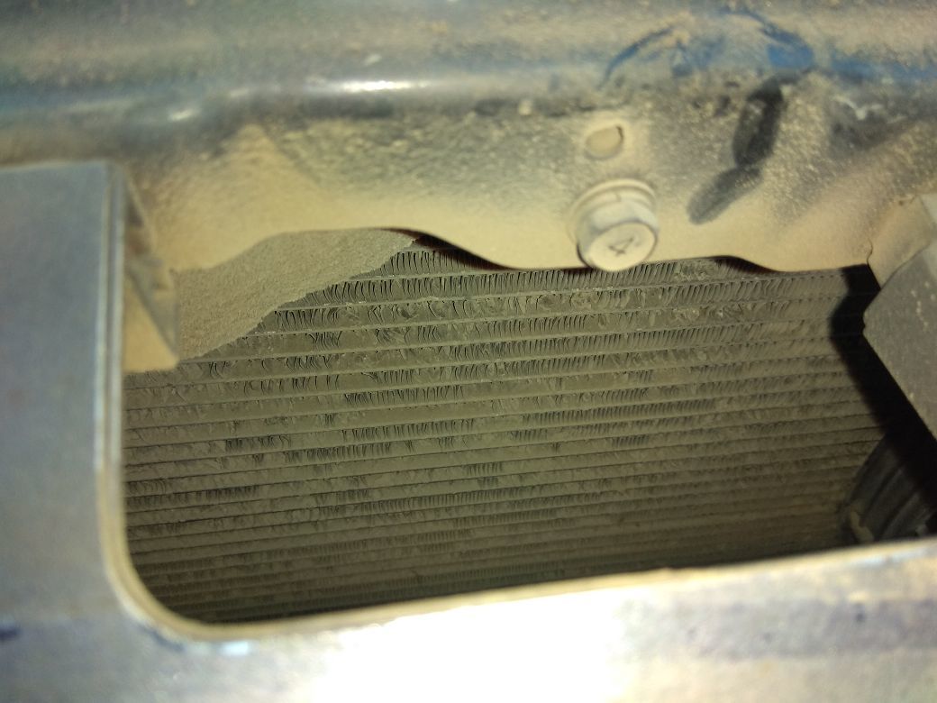

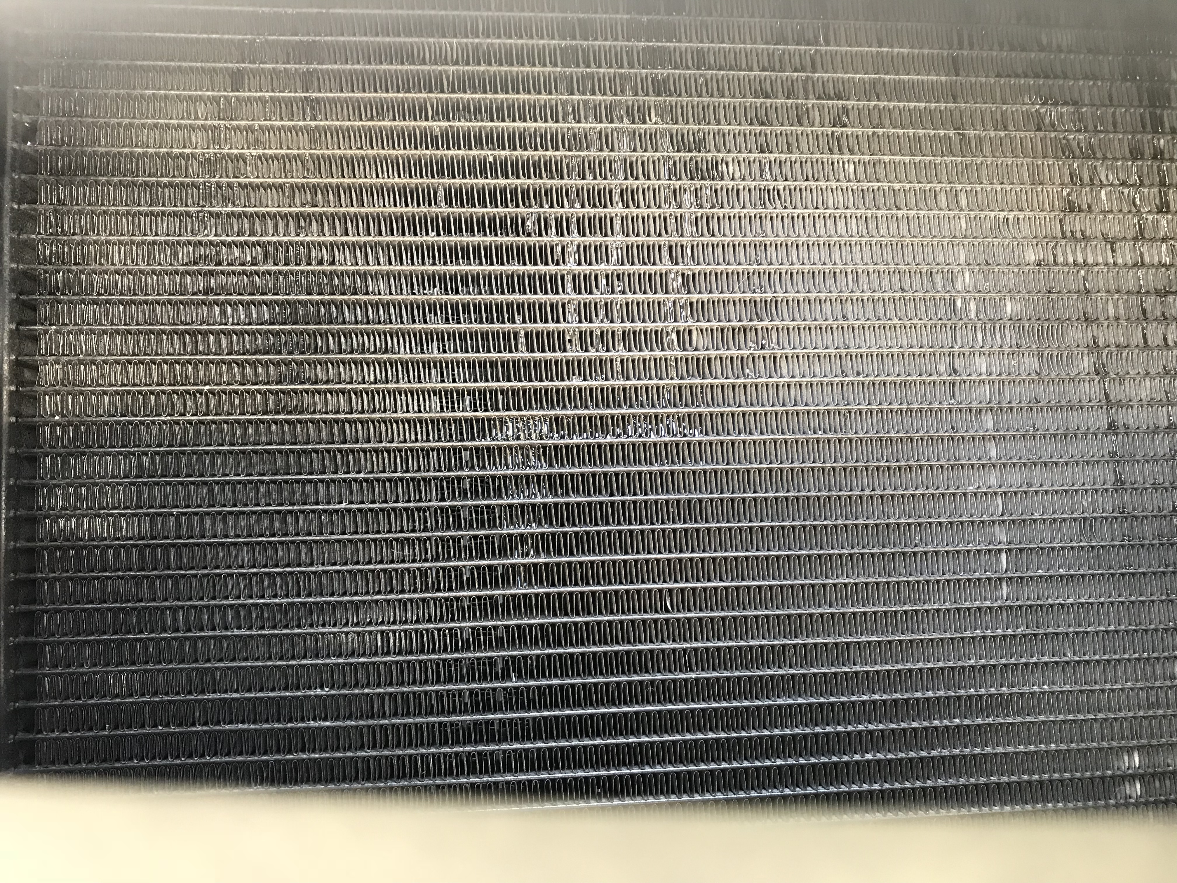

A/c wasn’t working properly, the technician diagnosed a faulty condenser.
Asked the distributor of Mitsubishi parts, he had nothing in store, and said that the new shipment will take some time as his minimum order quantity is 35 pieces, but he could get one from Singapore through airfreight with a 3k Premium, which will be delivered in 3-4 days. Searched for a used at Shershah, there were only 2 available, got one delivered (10k) and the technician said it wasn’t up to his liking. He went to Shershah himself next day and said the other one wasn’t good either. He suggested a Chinese copy (11-12k), but I said no. Finally he procured a Thailand made new one (13.5k), got it installed, working flawlessly, but still needs to be tested on a long run to be doubly sure.
