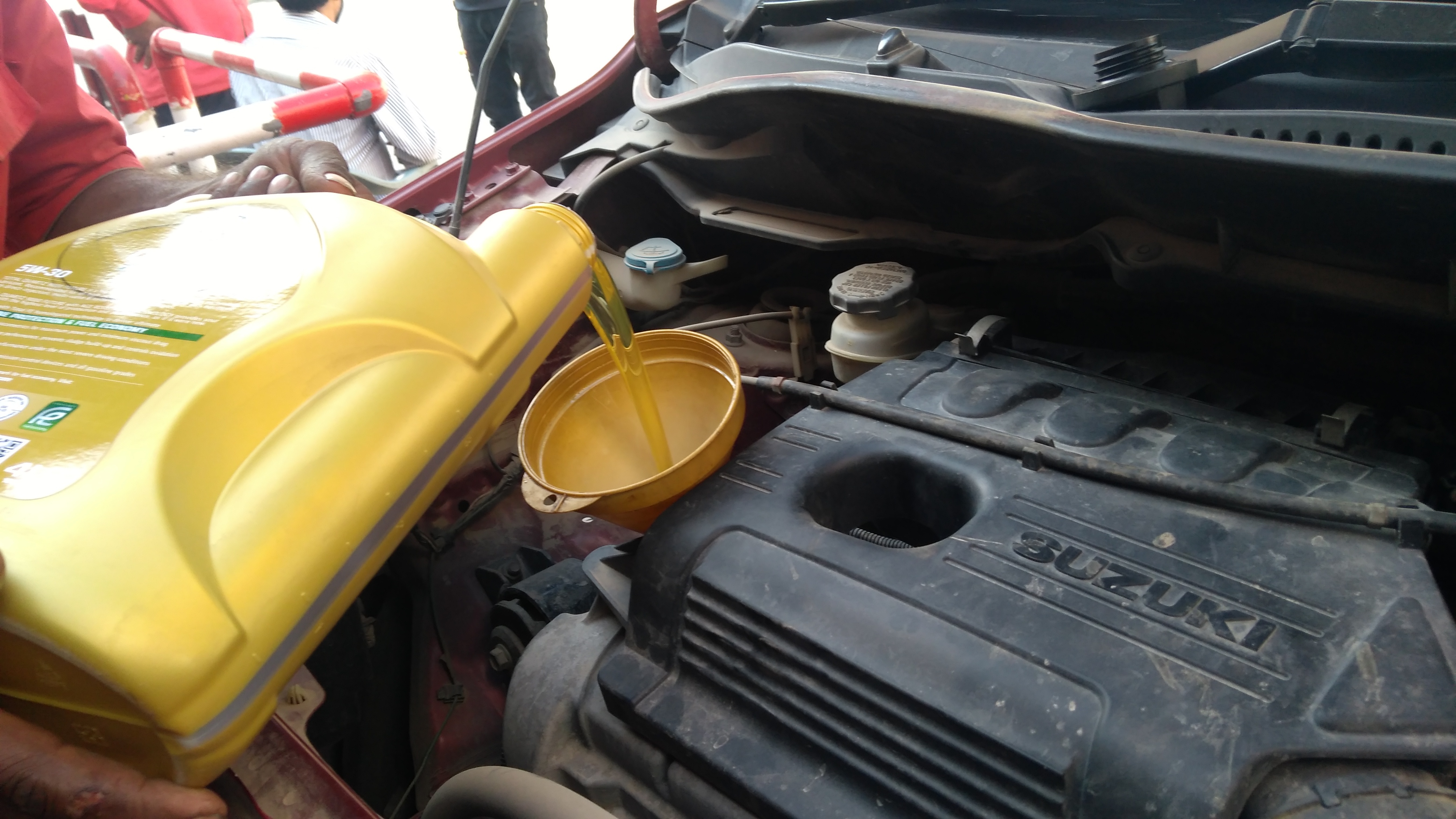

2 months free from car troubles and I cannot imagine how much life has improved. Makes one more productive and focused on more important tasks. Since the warranty period is over, I now took the car to get oil changed locally.
The biggest problem I faced is of unreliable shopkeepers in my area that force us to pour 20W-50 in cars. So I drove to the nearest dealer of Total to get my car rejuvenated (Near lucky one). They were really thorough and I decide to switch from Total Quartz 9000 0W-20 fully synthetic to Total Quartz 9000 5W.30 fully synthetic.
Reason was
increased engine noise in 0w-20, probably hinting at
improper lubrication for engine. Fully synthetic will be my go to and Suzuki Dealerships don't give that option in 5w-30.

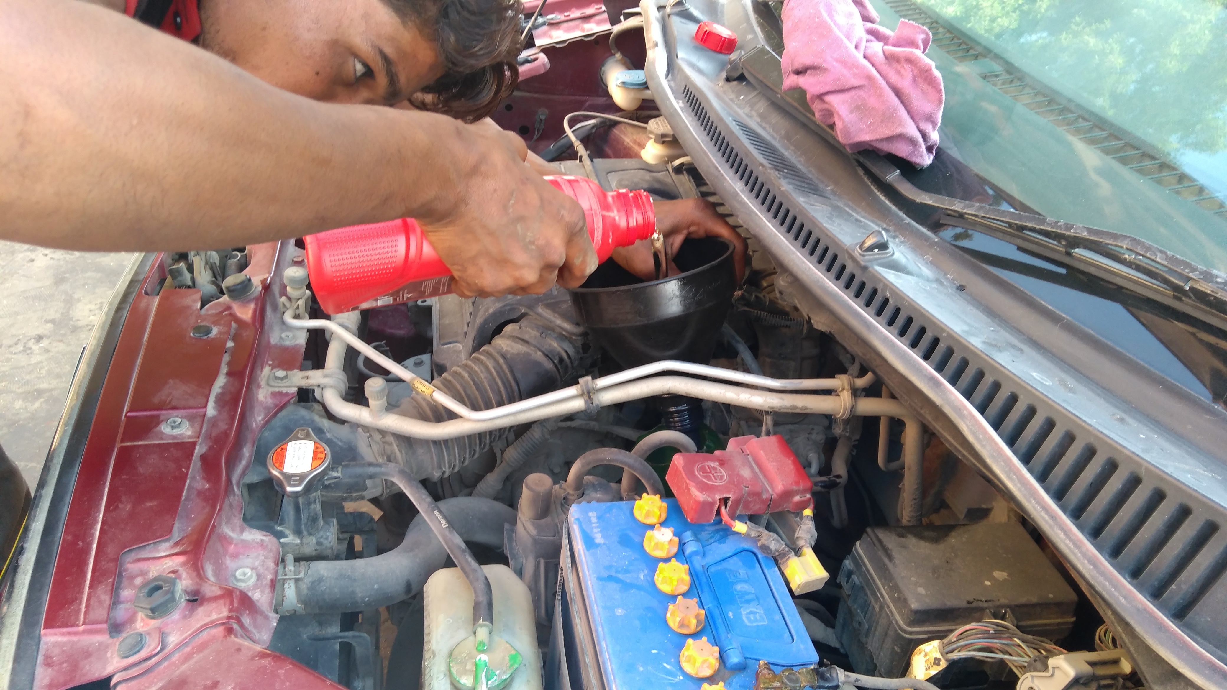

Gear Oil Change:
Rs.2500
Paksuzuki Wagon R requires exactly 2.2 Litres of Manual Transmission oil (API - GL4).
The best option was ZIC FF 75W-85 Fully Synthetic.
Immediately, I can feel the car shifts gear with much more ease. Although a good oil cannot fix a crappy Suzuki Gearbox, it has solved all my grinding problems, gear sticking problems, and Not getting into first gear problems. Satisfied.
