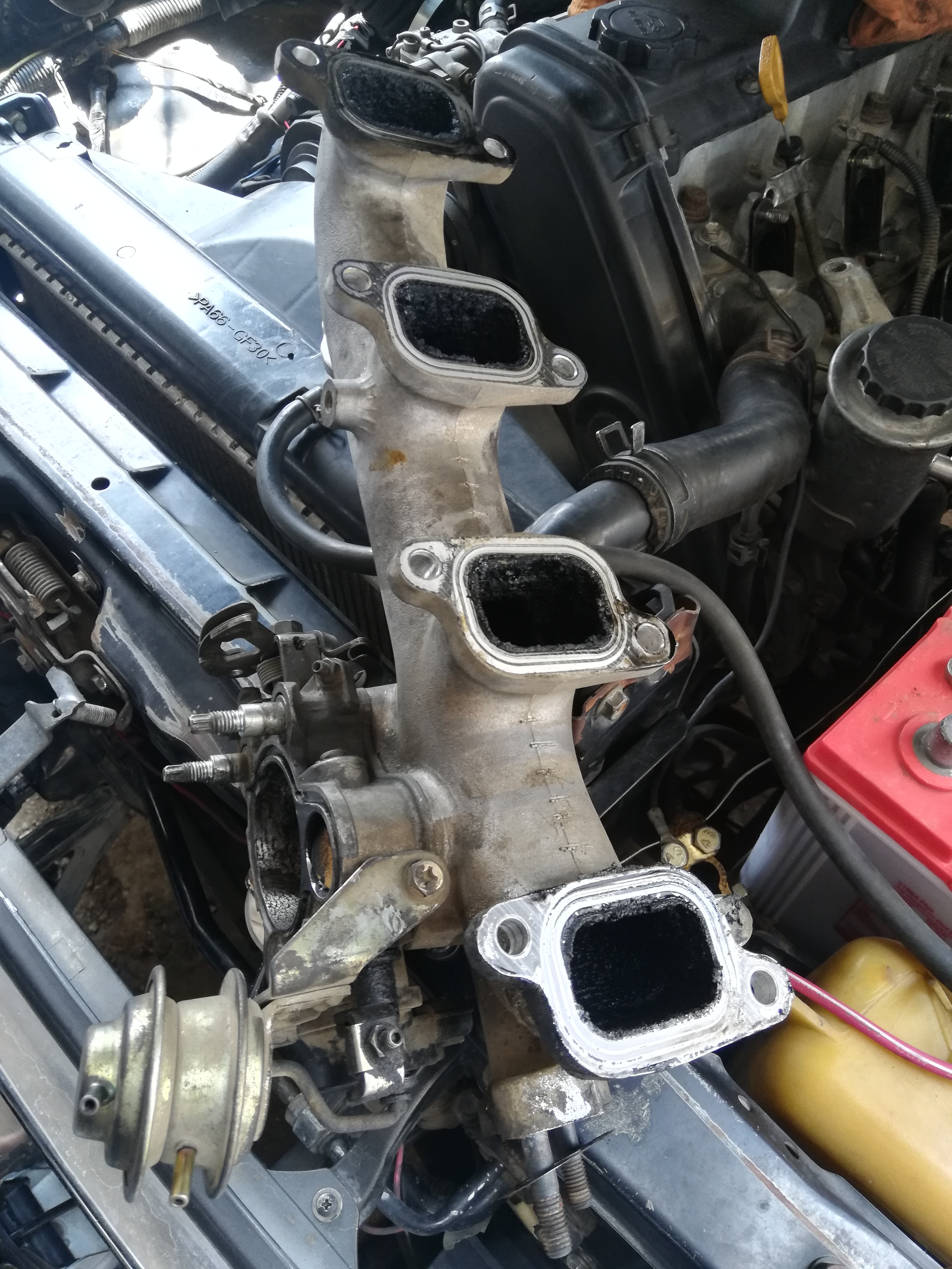

In addition to these changes to driving style, there are other options to reduce EGTs like increasing the boost and fitting an intercooler to the system. I have not yet opted for these and am more in favor of driving style changes. But within a maintenance regime I got the EGR deleted (which was stuck open) and the intake manifold cleaned of soot build up. This soott build up reduces airflow into the engine, as a result EGTs can rise.

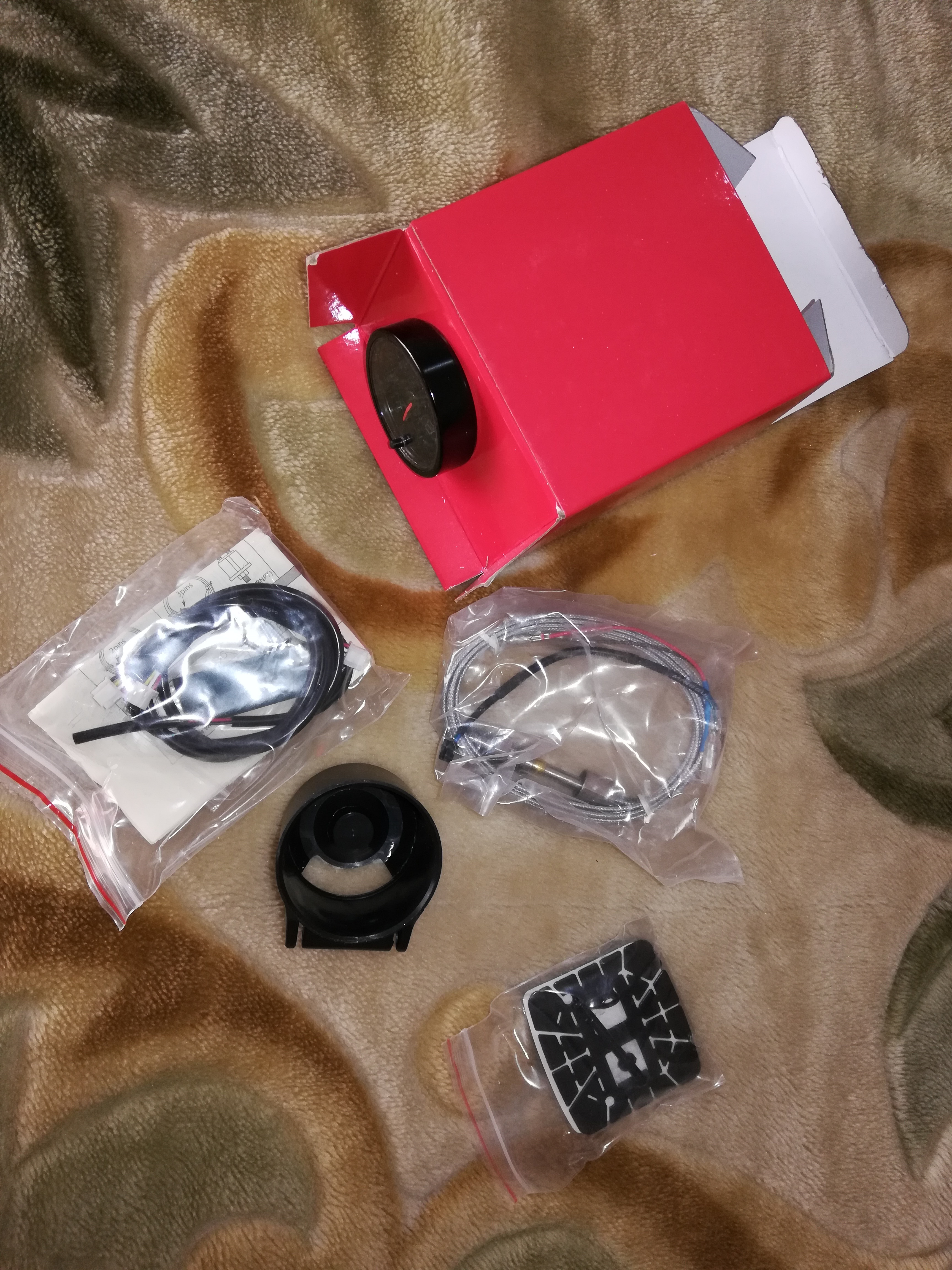

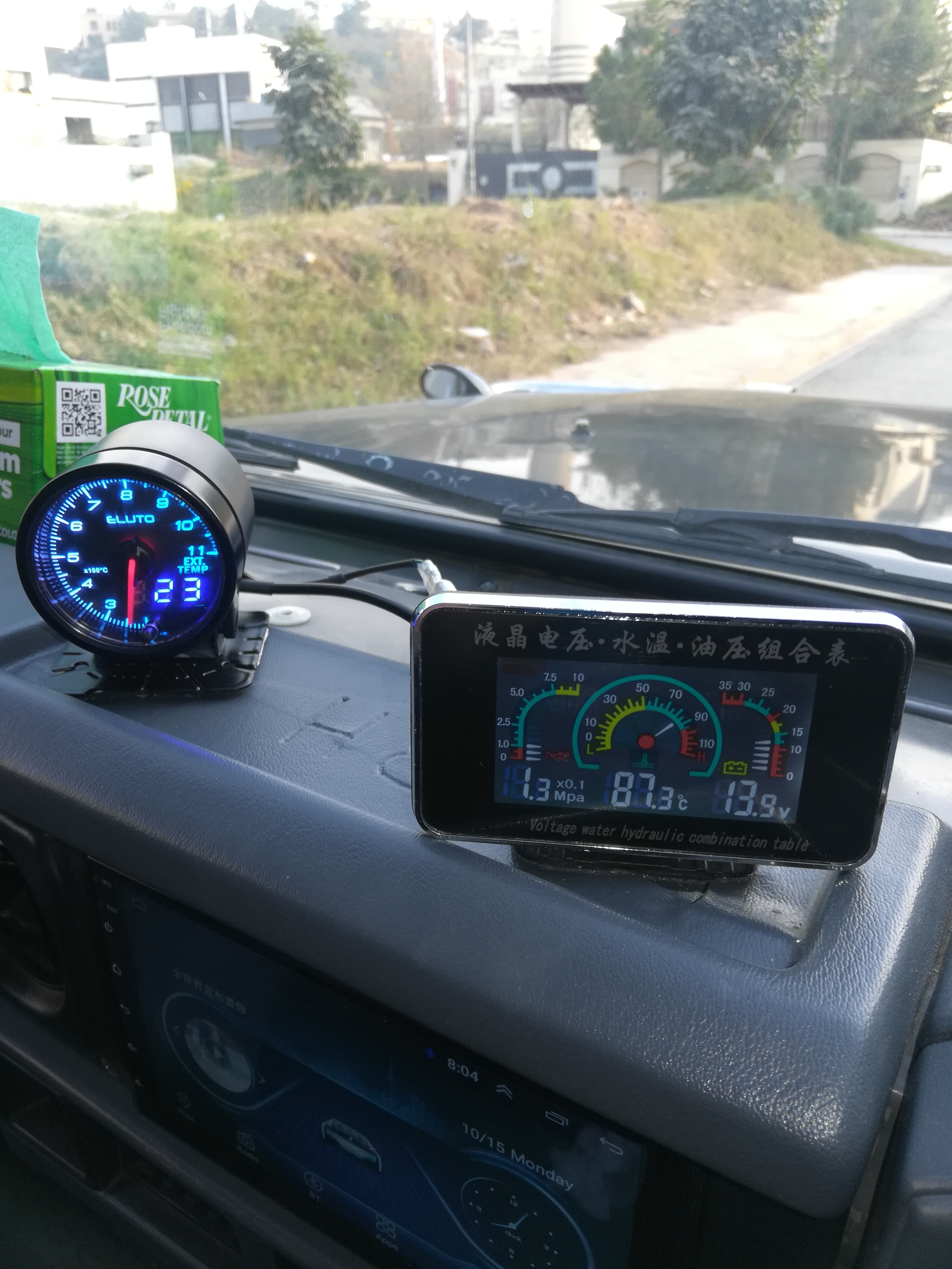

Secondly, an after market EGT gauge has been fitted to monitor the high temperatures. I know most of the times EGT probe is fitted pre - turbo (as it gives better picture of engine temp not affected by turbo) but I opted for post - turbo (in the down - pipe) mainly to avoid exhaust manifold dismantling (which involves a lot of work like removing air induction pipe, accelerator and transmission cables, exhaust heat shield etc.)
Since exhaust temps post - turbo are usually lesser than those of pre - turbo, so slight adjustment is required here i.e by considering 450 - 500 degree C post - turbo as the red line for EGTs. I may fit another gauge pre - turbo in future but right now contending with this.
