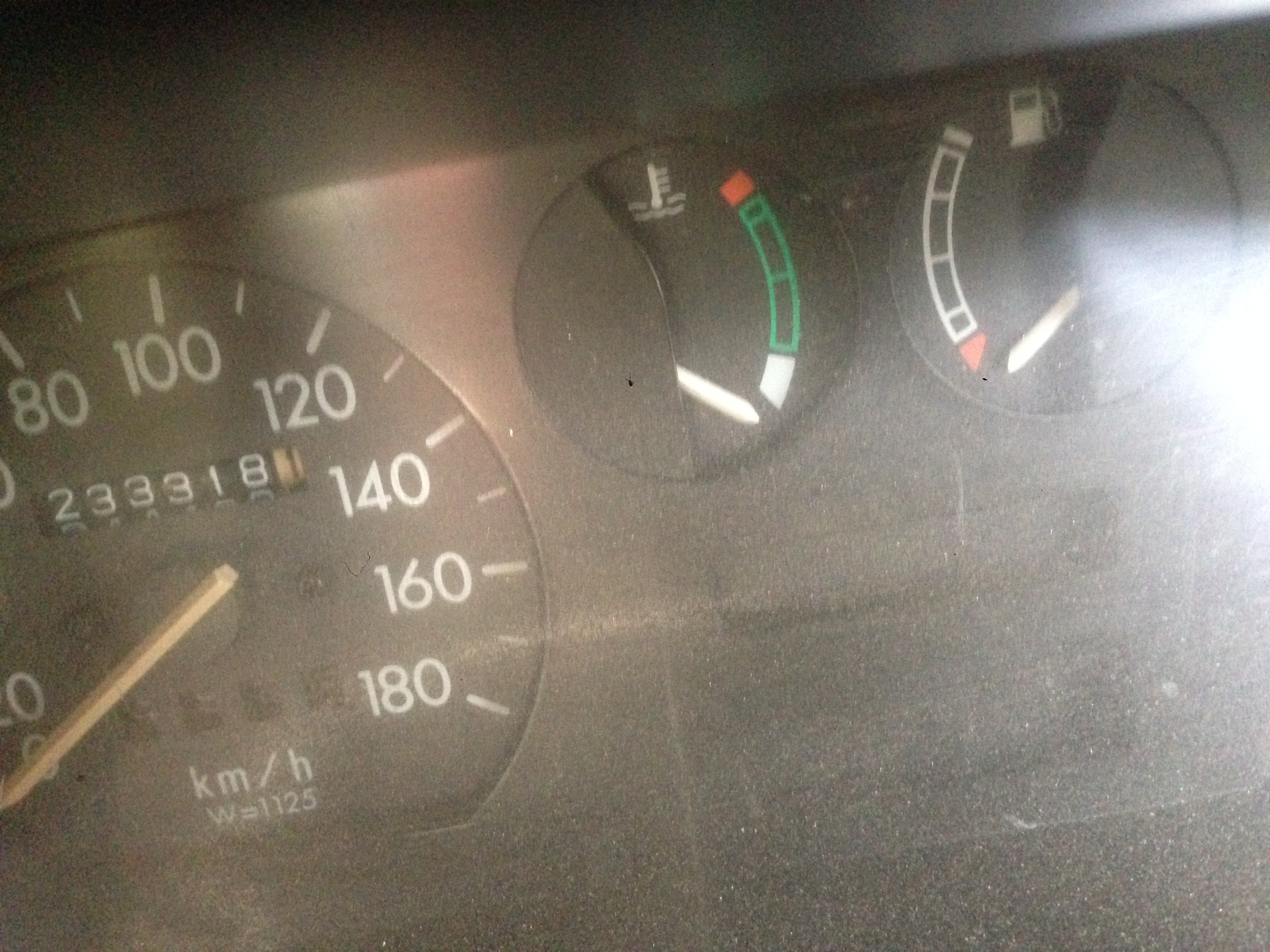

My car is daewoo racer SOHC,1996.
When I bought the car in march this year,its radiator fan was running directly,but there was no additional cutout installed for it,rather it was made direct using the relays and fuse which are present in the fuse box.
So after some time the fuse box and fuse got melted ,( picture attached).so I went to the laktrecian,since there is no one who know any thing about daewoo wiring.so he attached additional cutout and made it run directly with the battery.
The car has travelled almost 4000 km,and there has been no issue of wiring or heating up.the temp gauge sits on top of white area.and never cross it, no matter how much weather is hot and even with ac(btw condenser has additional fan.)
ISSUE is
Now winter has come and yesterday when I travelled even after 50 km . Mostly was highway,the gauge didn't even touch the begning of white area (meant running too cold).
Kindly suggest me what option do I have.
OR should keep running it as it is.
