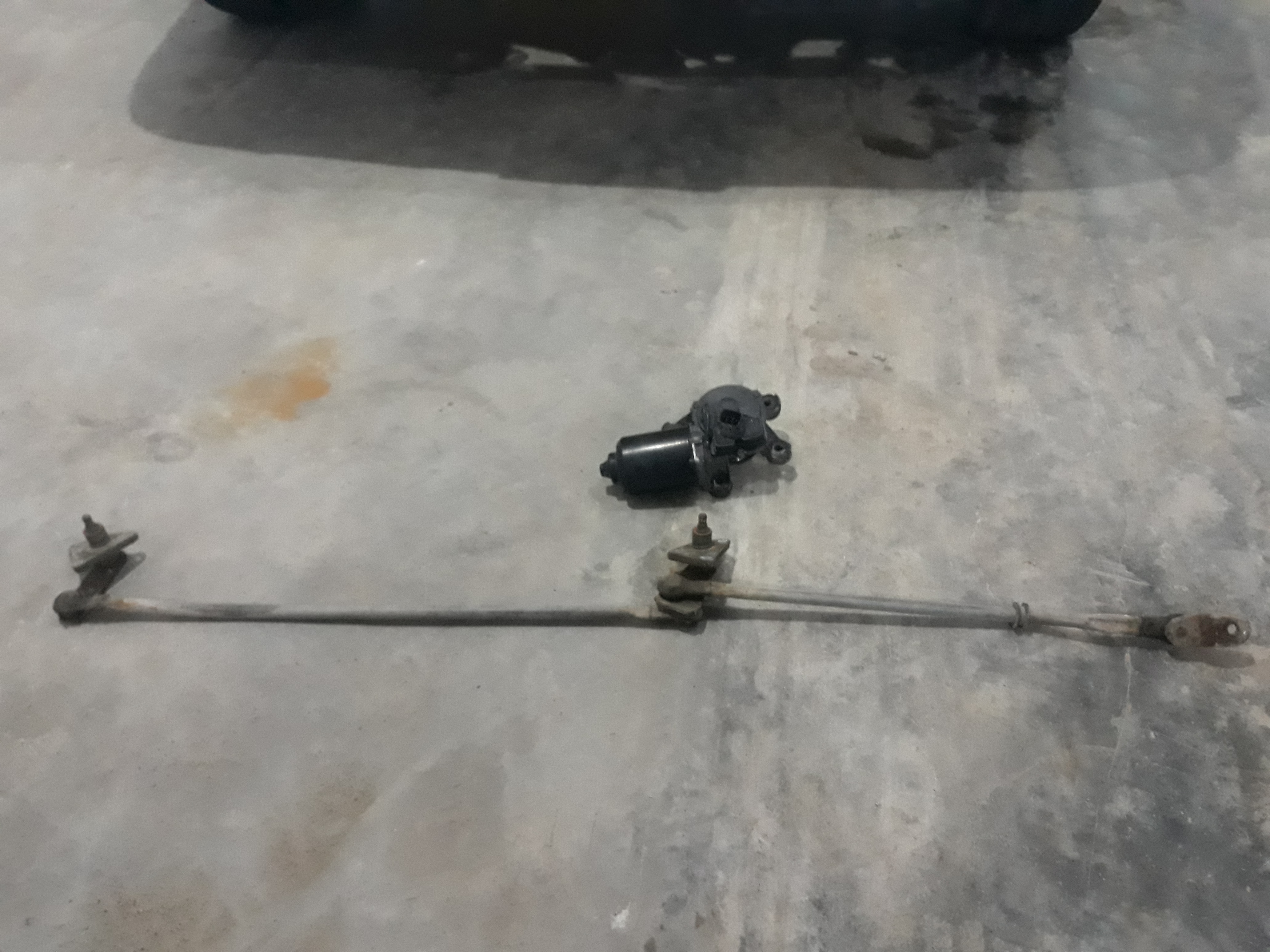

Removed the motor & wiper arms from the car.

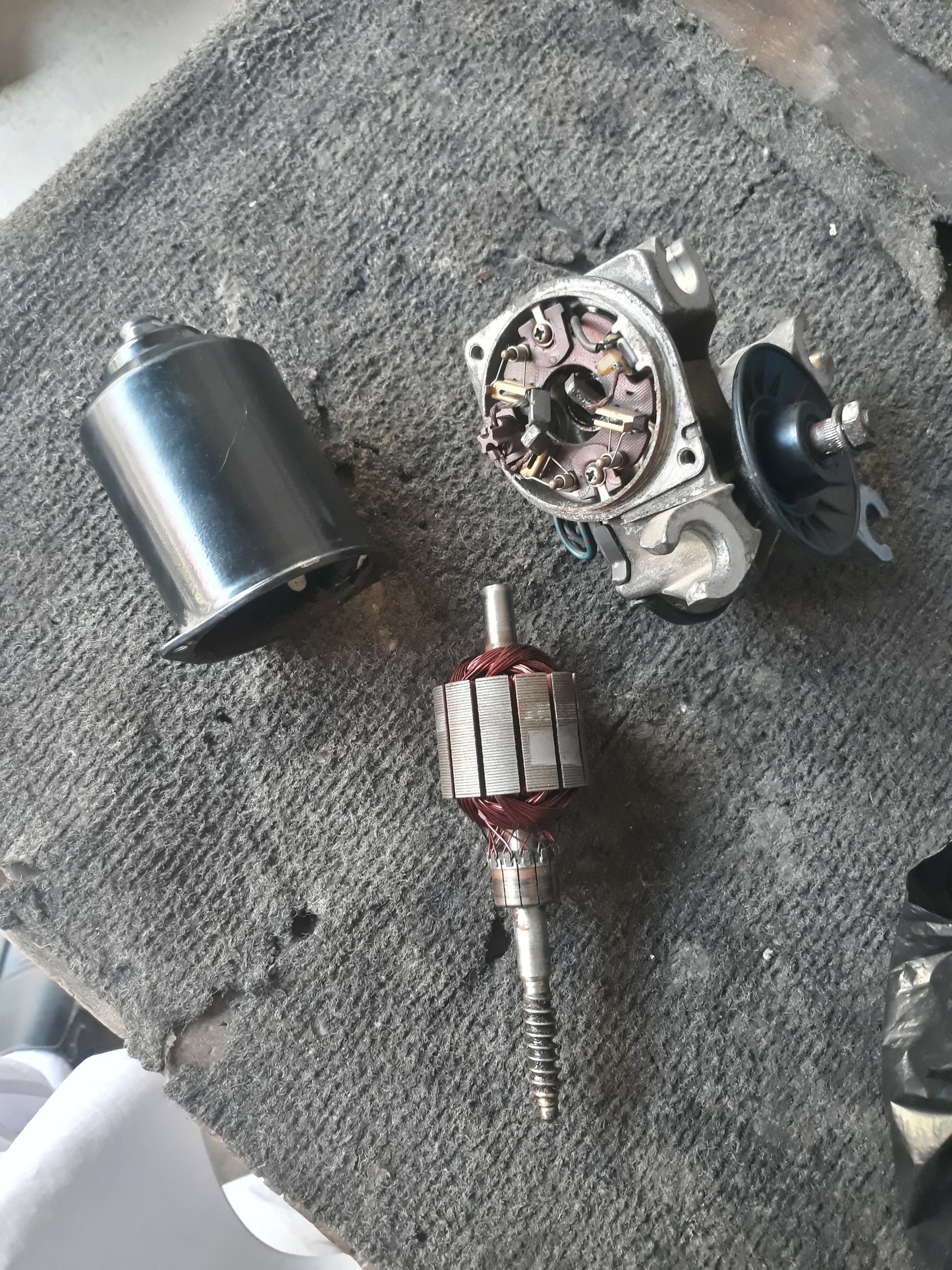

open-heart surgery of motor. It was fine, opened it up just to increase my knowledge that how things work inside it. Also inspected its carbon brushes & bearing, which was fine.
Old grease is all gone bad, time to clean it up.
After Clean-up
The wiper arms were pretty jammed up at these points.
- First of all I dipped it into kerosene oil for half an hout but to no avail.
- Sprayed alot of WD-40
- Then injected some fresh ATF (as it also acts as a penetrative fluid) into the joints but still of no use.
Finally, as per friend's suggestion, heated it on a stove for like 3 minutes & it immediately became free.
- Lubed it & intalled everything back.
