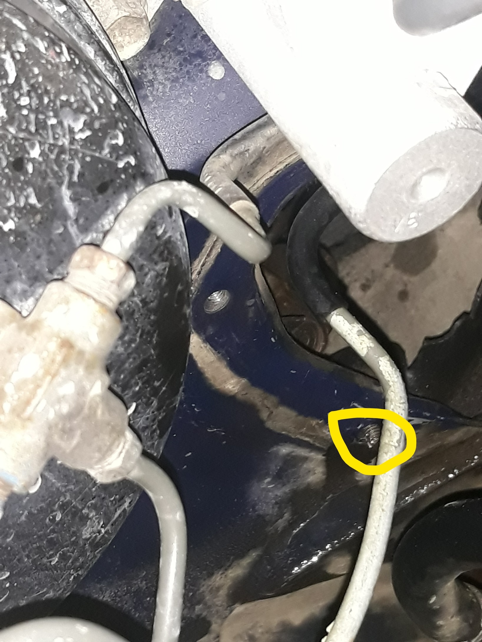

Yellow encircled one is the fresh cover, while the other one is old that came out of the car. You can clearly see that the old one broken from the lower/under side while the fresh one is all intact.

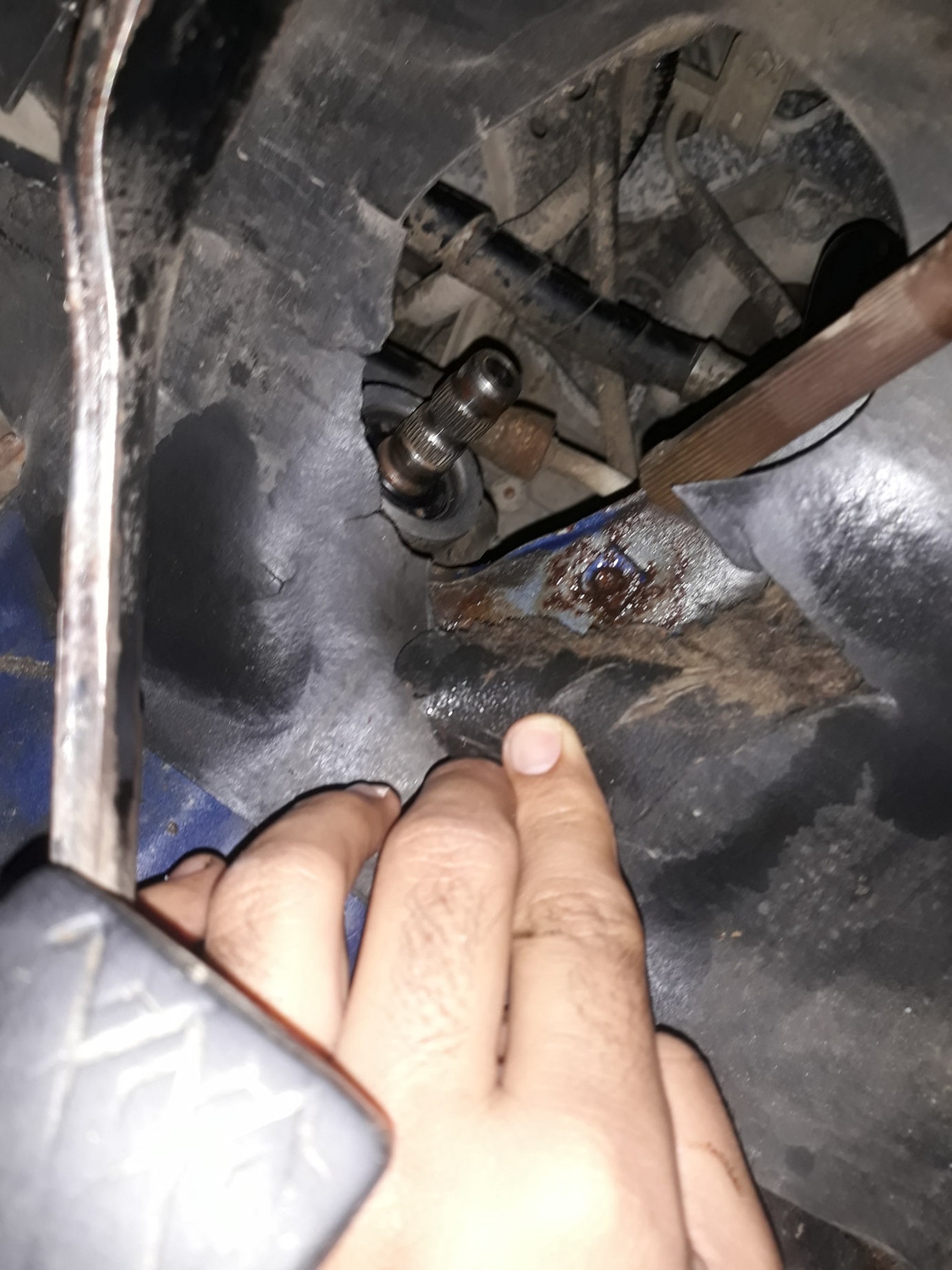

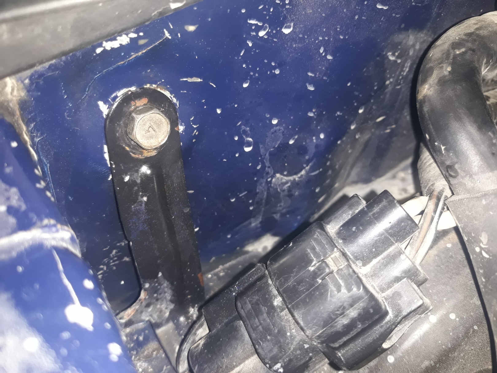

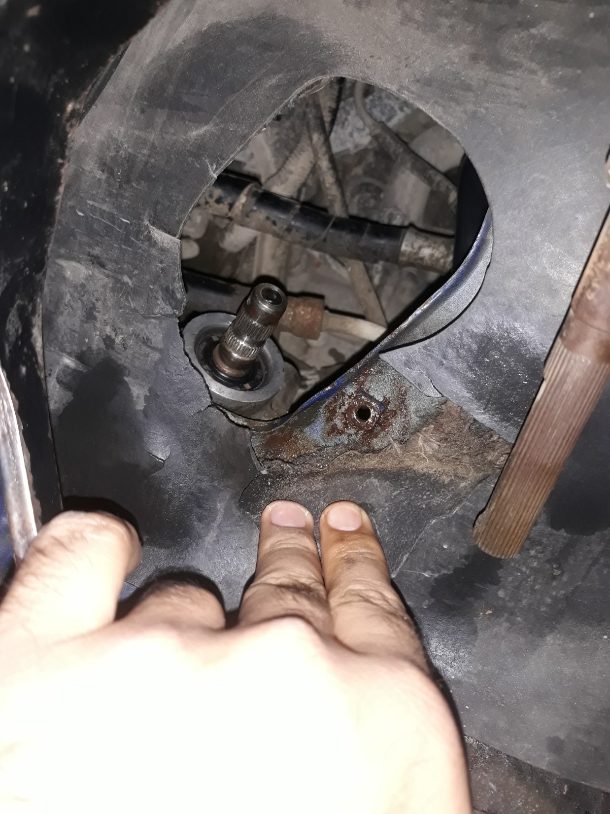

Removing the old cover was the most difficult task, upon removal got to know that one of the bolt is broken & some sh*thead mechanic ustaad left it as it is. Take a look ...
Getting rid of that broken bolt was another challenge for a noob like me and the working space was really tight in that area, my hand weren't reaching there completely, got alot of cuts & scrubs on my arms
It was almost impossible to work on that broken bolt from the engine bay so we decided to work out things from the interior side. And things got slightly easy on us.

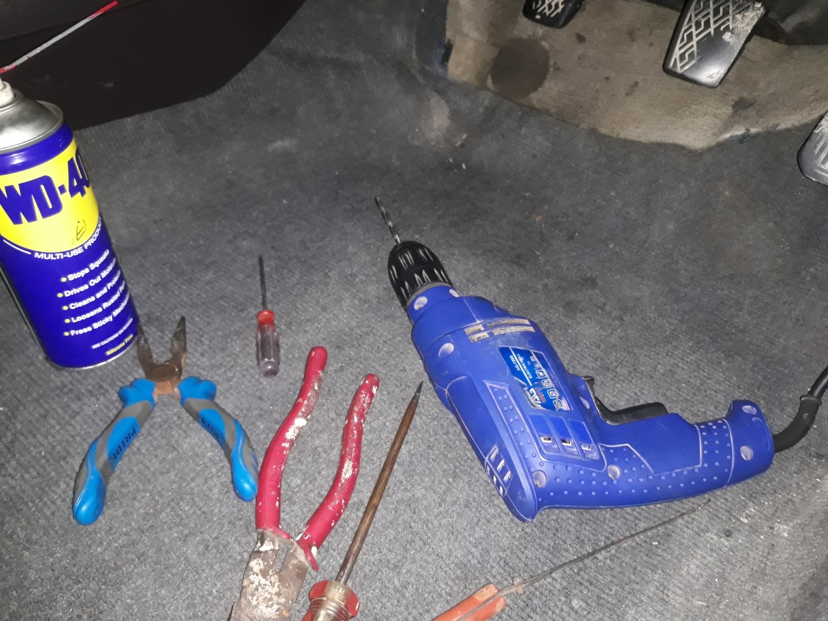

Bad boys which helped me getting this mess sort out.
After drilling the broken bolt out, I used a thread-tap (aka moose in local lingo) to fresh out the threads.
