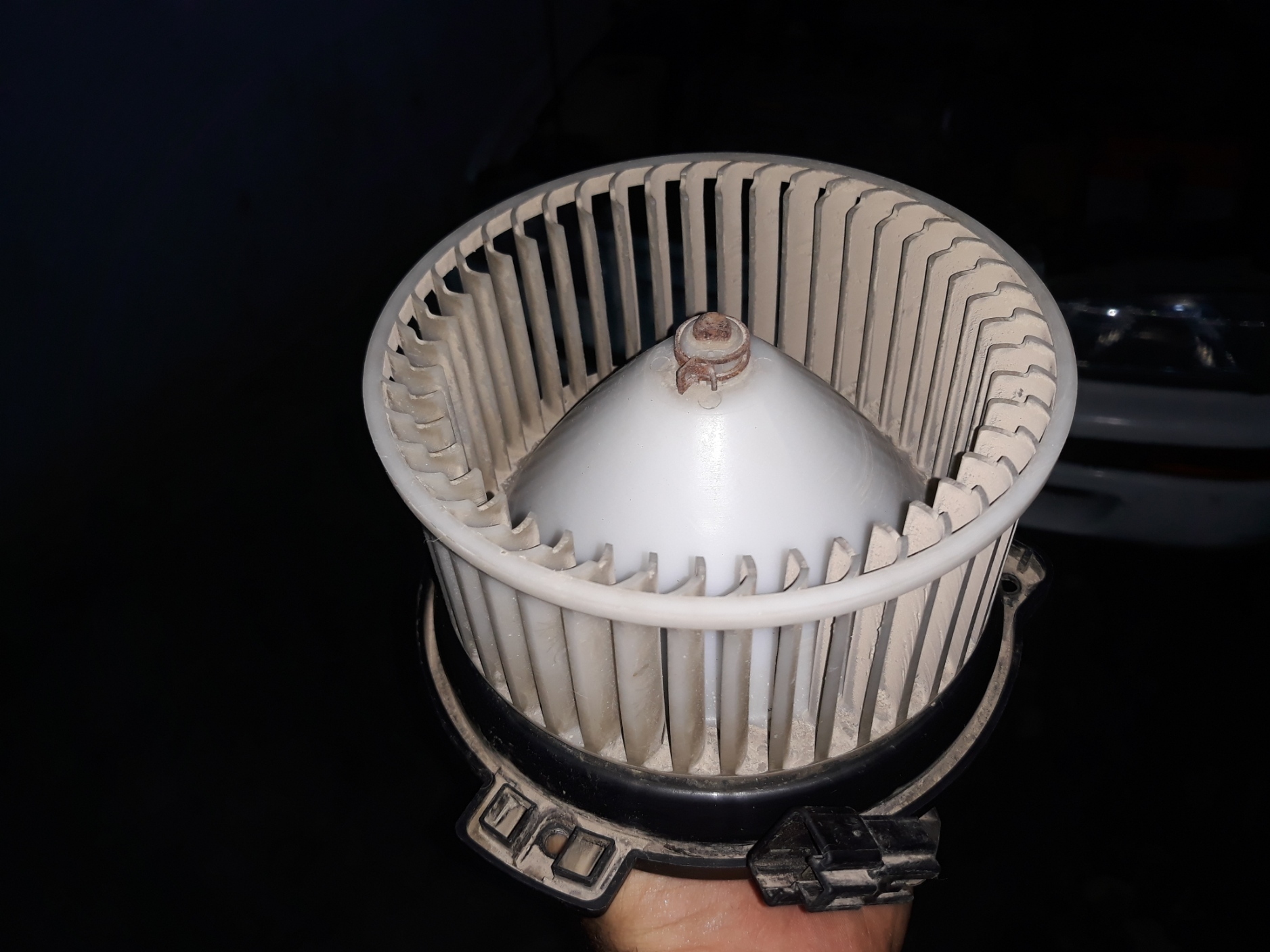

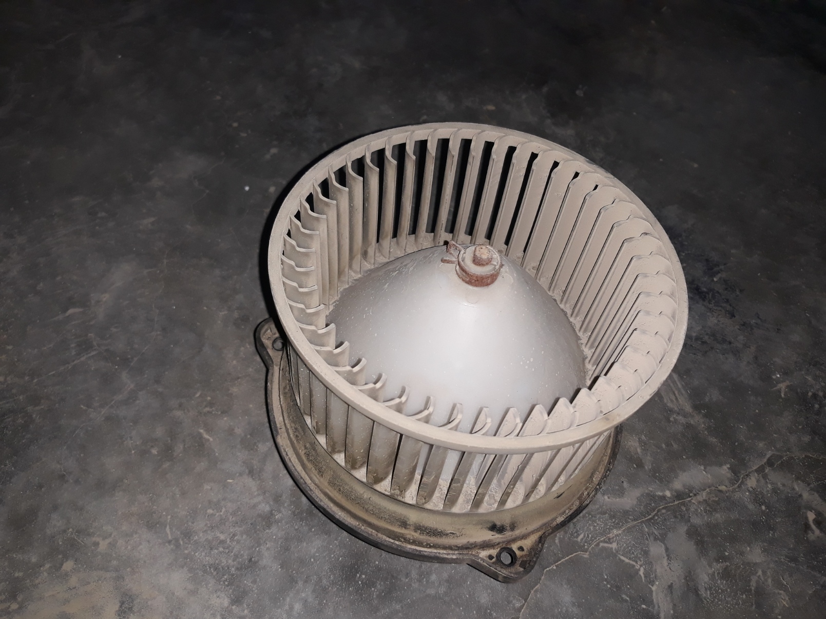

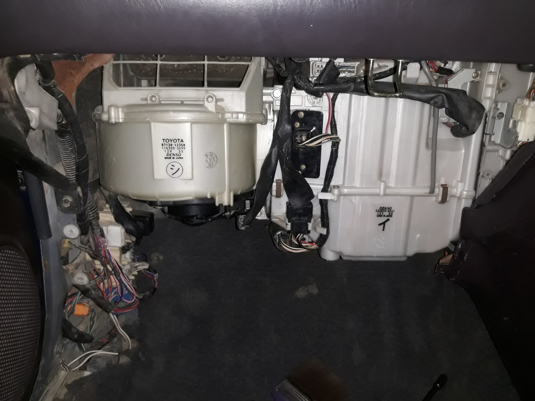

First of all, removed the dashboard glove box, then removed air blower fan motor. It was dusty.
Cleaned it & placed it aside.

Before doing the cleanup, I removed the passenger front seat, then removed all the carpet & underlay from the passenger side.
Also covered the ECU with a piece of cloth, to protect it from water splashes.

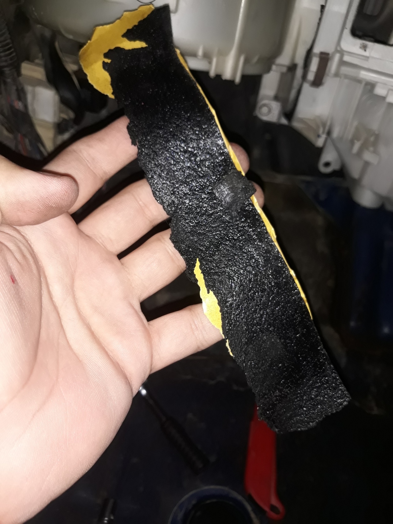

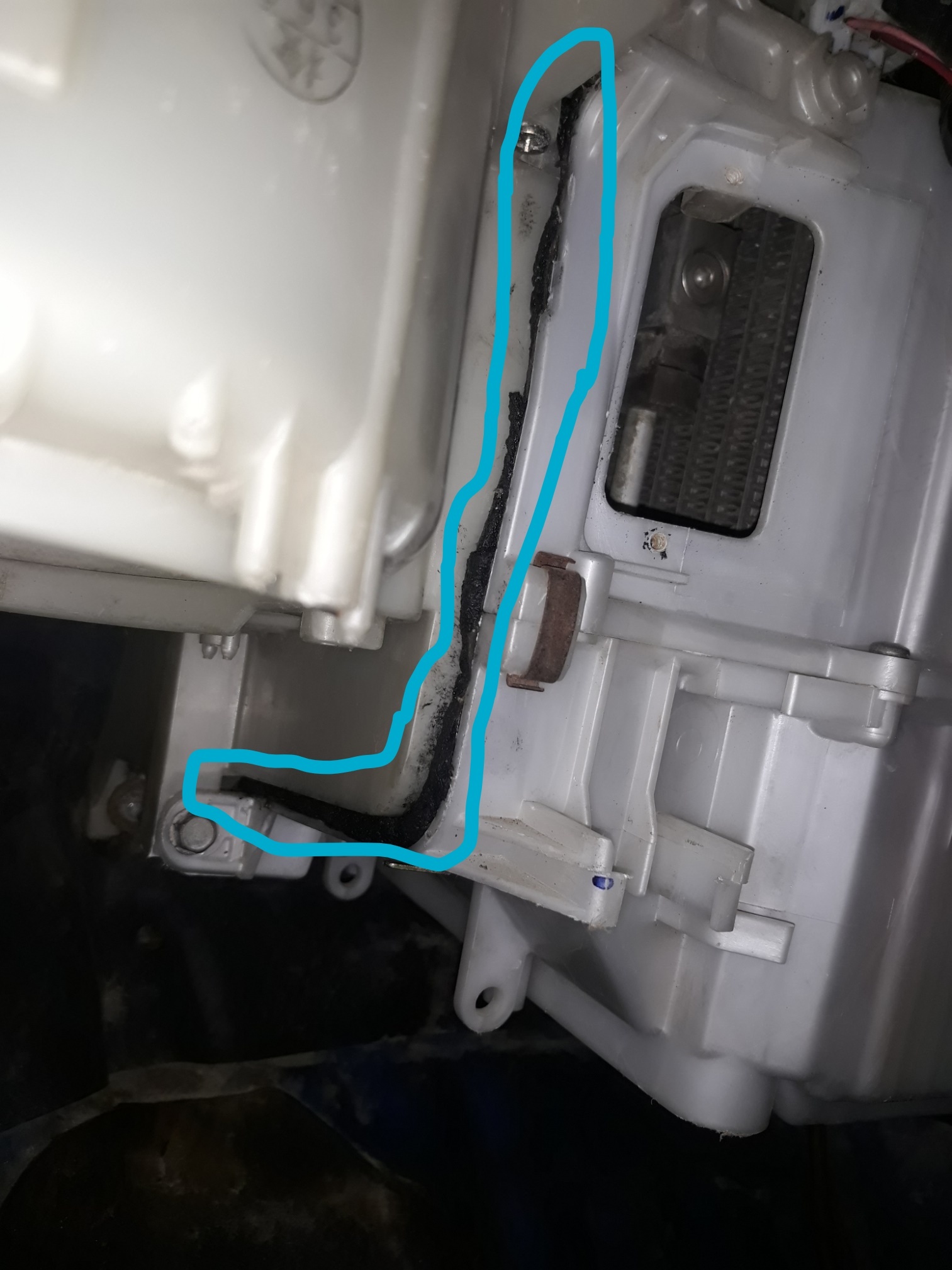

In the end, noticed a very minute air leakage from the highlighted joint, so added cork tape aka 'kachi rubber' for better insulation & to prevent air leaks.
