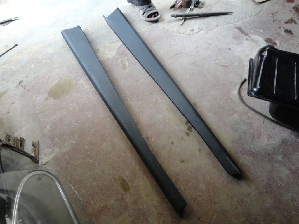

btw do us a favor and dont use the rusty tools you showed on the car, no car deserves neglected tools. On being in karachi buy a can of 3m underbody spray and body cavity wax, when the car is fully assembled, all rubbers in place, all hole plugs in place, spray the fenders with the coating (light is good - thick is bad) - the body cavity wax is sprayed into the jack holes and other cavities like the little areas right behind the floor tunnel and also under the fuel tank area. dont spray over moving mechanical parts. It protects from rusting.
