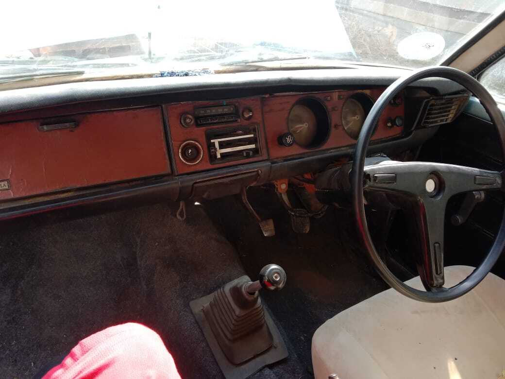

2nd, inspect physically by hand, what things are loose like front frill, headlight bezels, bumpers, doors, window channels or window winders, loose bits inside the dashboard area. fix what can be easily fix.

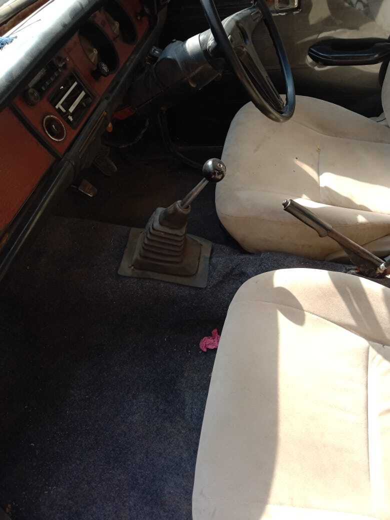

Inspect the floor by removing carpet. Get it weld if required.

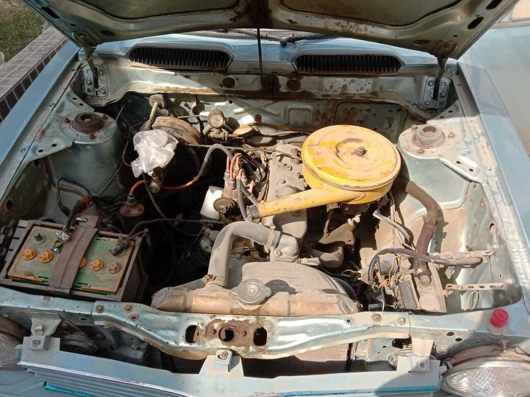

AS FOR ENGINE BAY:
Where is the TIKLI?
Brake cylinder missing cap
Expansion tank for radiator is missing
The bend of radiator pipe needs to be addresses.
the engine room needs a good wash, just paint the air cleaner with new paint, brake booster in black and the fan shroud. the engine room will start looking good.
You can do a full engine room redo when u send the car for full paint.
