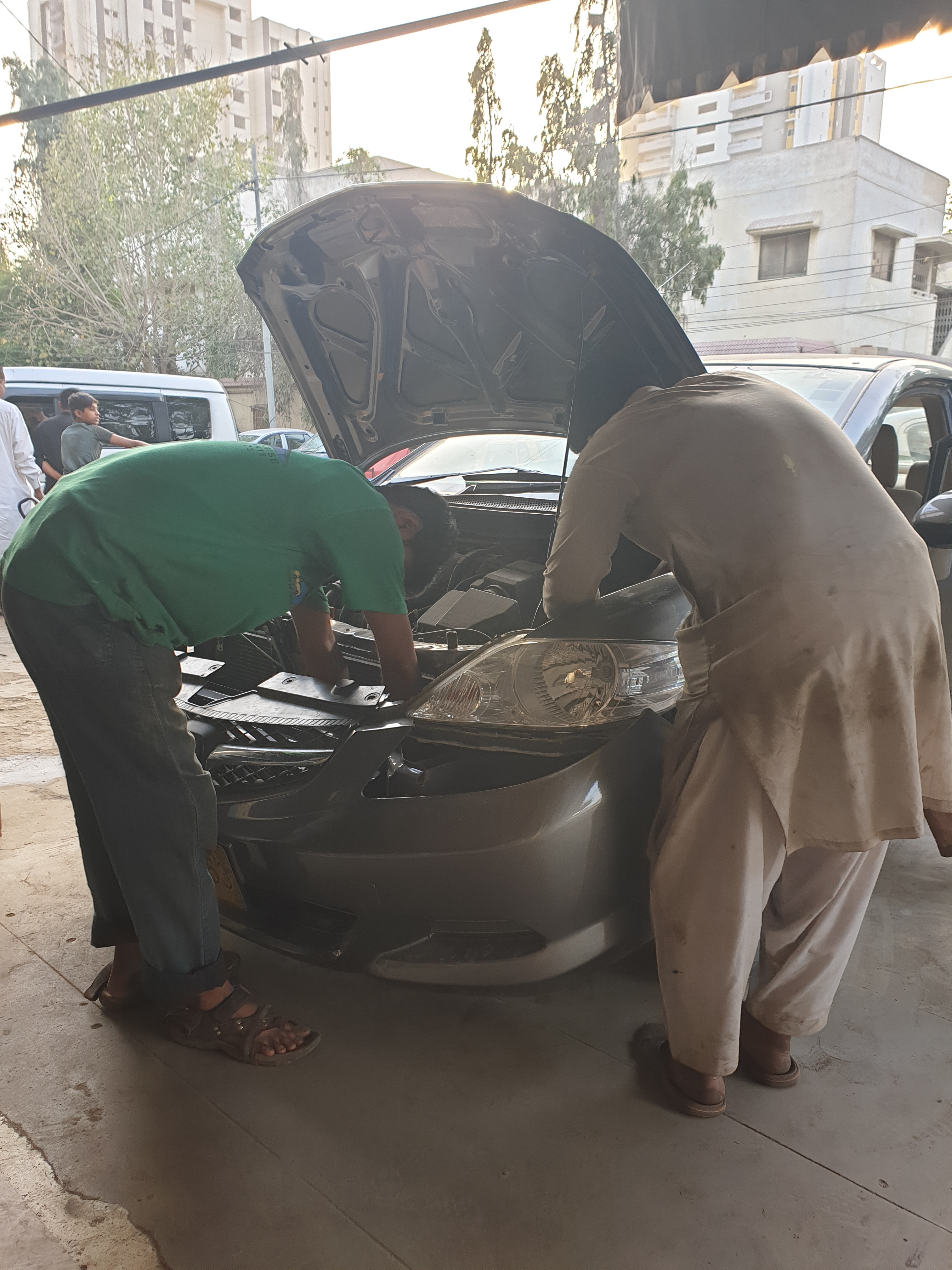

Picked up the car in the morning. Opened the hubs for bearings. The hubs needed to be changed. Rotors were okayish but had no space to be grinded on the lathe machine.
So got new rotors aswell. Replaced rear wheel bearings.
The left axcel did made us skeptical, got a new set of axels aswell just to be safe.

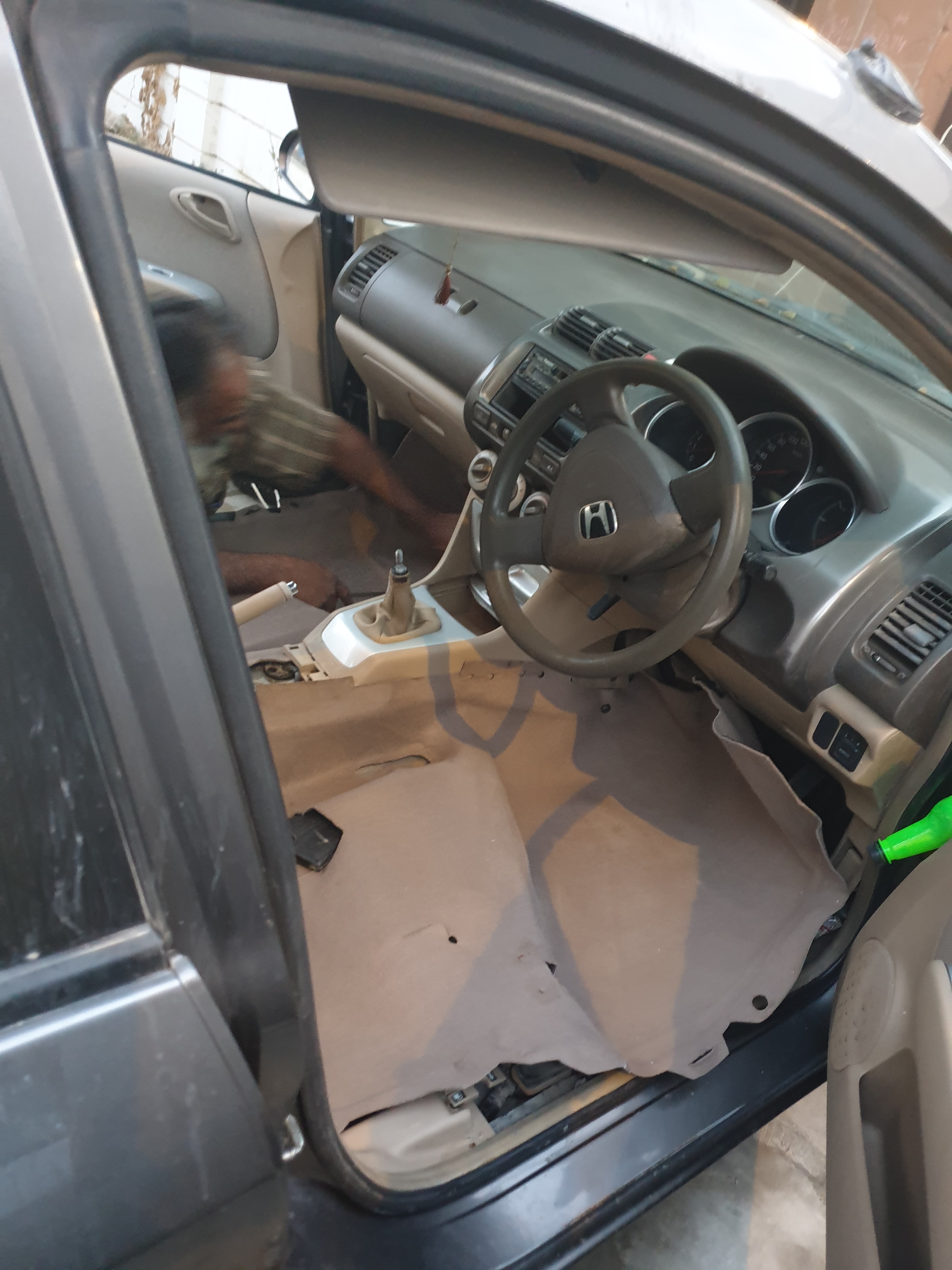

Fixed the side mirror, replaced master switch for power window, driver door auto working, orange light on the panel now.

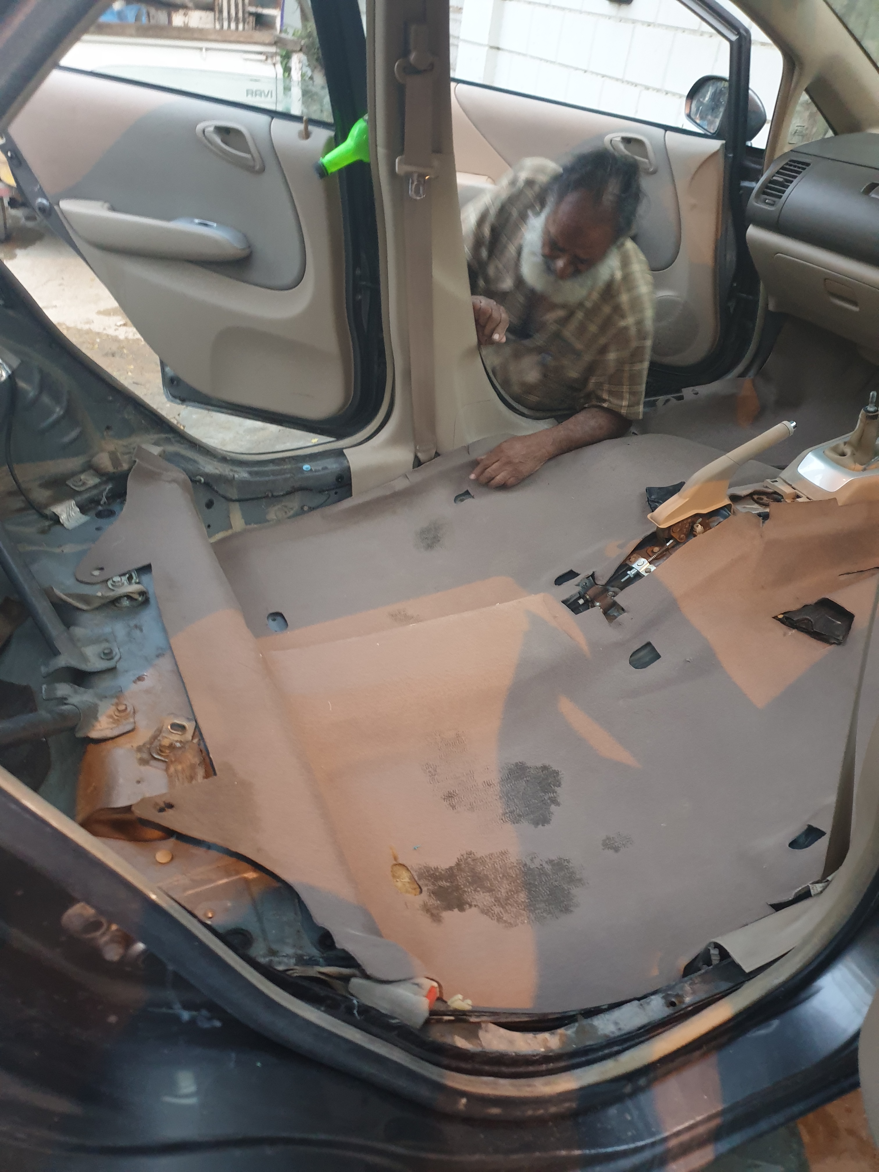

-Inter cleaning.
