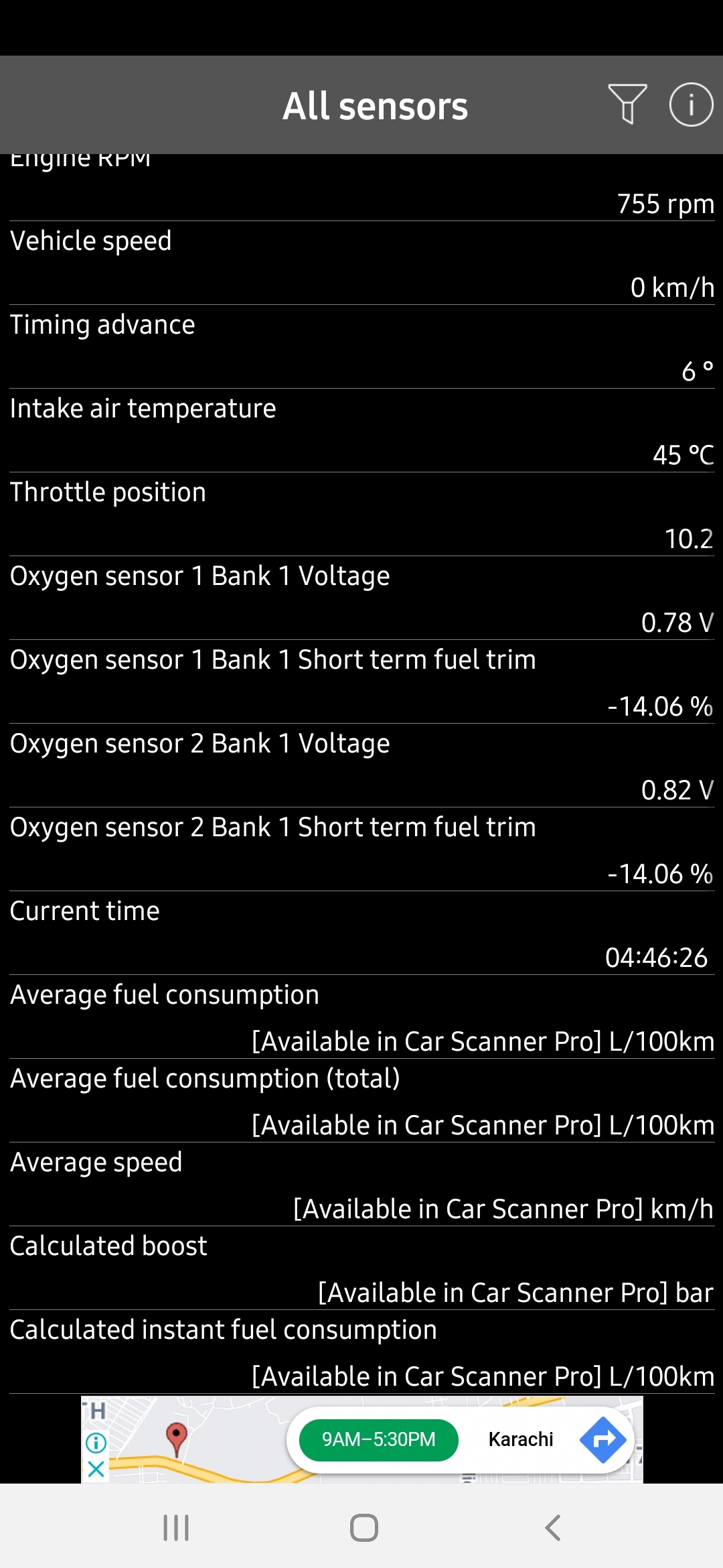

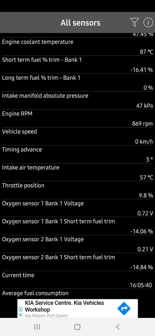

4- O2 Sensor was Cleaned ( reading keep Fluctuating alot at Idle or running )

the O2 Sensor Reading was Showing 0.75 0.55 0.9 0.85 Readings and i heard it should not be more than 0.45 and if it is then its using RICH fuel in the Combustion. I guess something Wrong with O2 Sensor or Since Engine is changed and there is no EGR Sensor in this PKDM Version and Assembly is of Another Country.

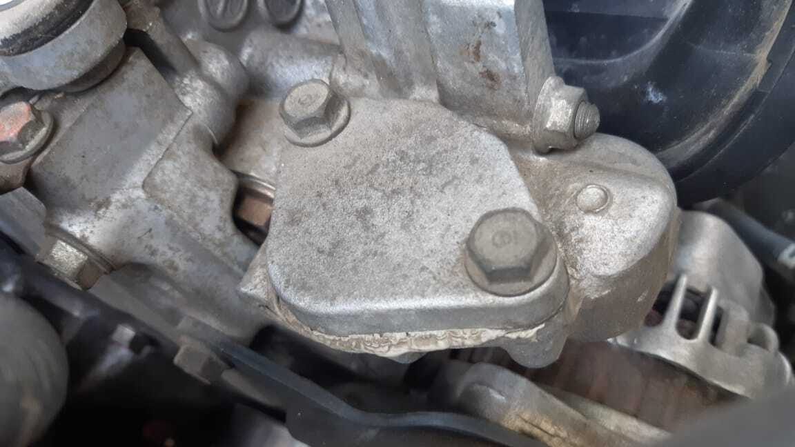

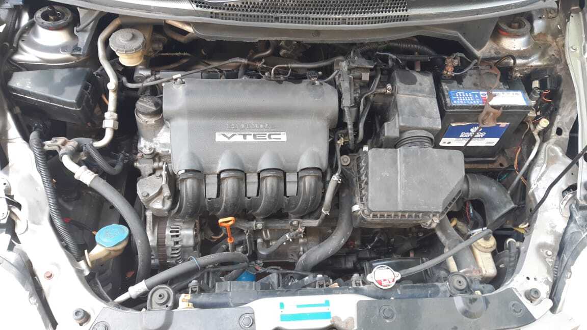

See Some Pics Below
