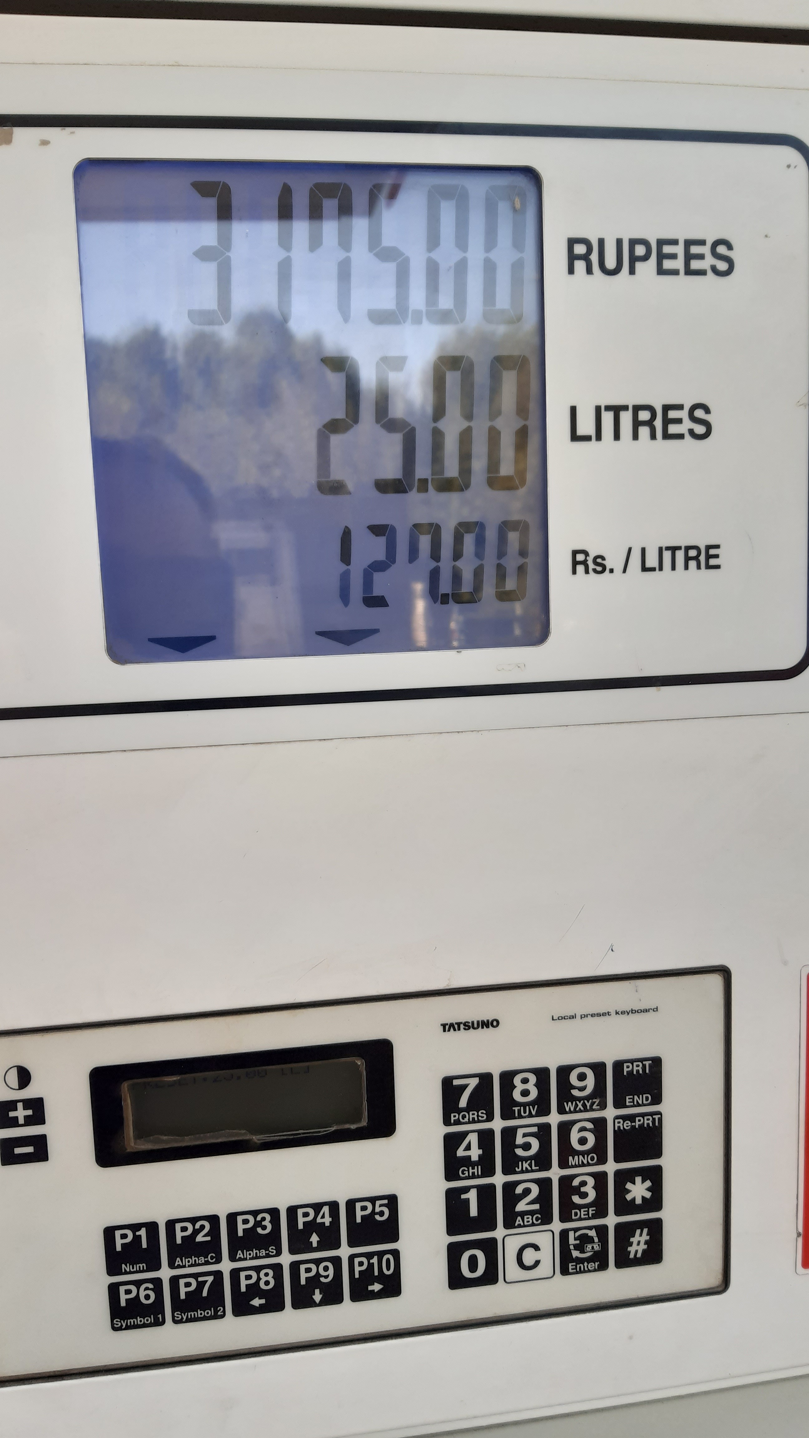

Right now i am getting approx 7.5 Milage which is worst , before tuning i was getting 9 Km per liter, I feel like idleing on AC consume more fuel which Corolla 2nzfe never did that much.
Any suggestion how to Improve the milage. or Simply i can change the O2 Sensor ?
