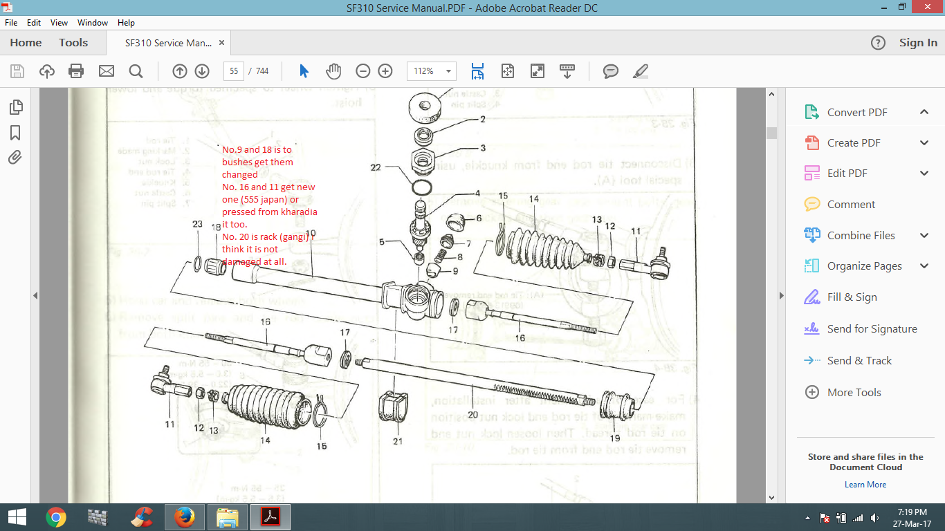

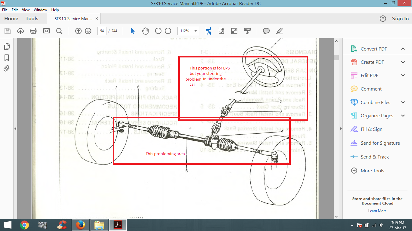

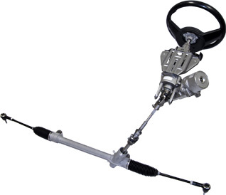

almost 5 months ago i felt dhug dhug sound from front of my car i went to a suspension wala he checked and said kanghi change hogi. At that time i dint have budget. Ao he greesed and thora hard hogya steering but it was okay after e days. Ab 1 mah pehly awaz ziada hogai i went to mechanic and he tightened the steering rack ab steering bhot ziada hard higya hai like u i had to use full power to turn it back and some times its very dangerous hile taking uturn. But 3 din pehly phir dheela hogya hai. Ab steering sedha ho to dhug fhug karta hai normal turn pe steering thek hai but thora sa ziada turn ho to steering wese he hard hai. What should i do? Should i go for kangi? What if i change to eps? Tab b kanghi change karni paraygi? Ya eps k sath apna steering rack ata hai?
