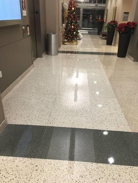

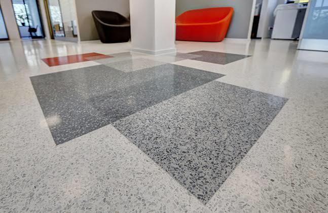

I have a 325 sqft simple Terrazzo floor(without any squares of Glass or Marble border) the mason and Grinder guy together done a terrible job it is visibly uneven therefore I want to put "Master porcelain tiles" over it but I don't want to raise the level so much.
