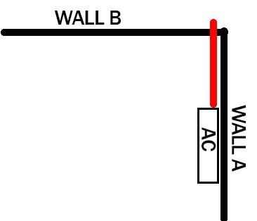

Salaam, I have seen split airconditioners in other markets where water+refrigerant copper tube can be pulled from side of the ac instead of the back but I am unsure about pakistan. I do not want to make a hole in the same wall as the ac but rather in the adjacent wall. I am yet to stroll the market for this. Please see attachment for better understanding of my query (refrigerant+water tube in red), ac to be fixed in Wall A but the hole for refrigerant/water tube needed in Wall B. Does anyone have experience with this? What issues did you face with such scenario or even after such installation?

Yes i already planned for 3" pipe but outdoor unit on roof wont be efficient as this is a 3 storey house, But i want to know if its possible to have the hole in an adjacent wall rather than same wall as the ac, I havent seen this type of arrangement in pakistan. Do you know if local aircon manufacturers provide the tube placement sideways too?

Yes, it's no big deal. Any of the pipes can be routed on either side
Great....thanks.
