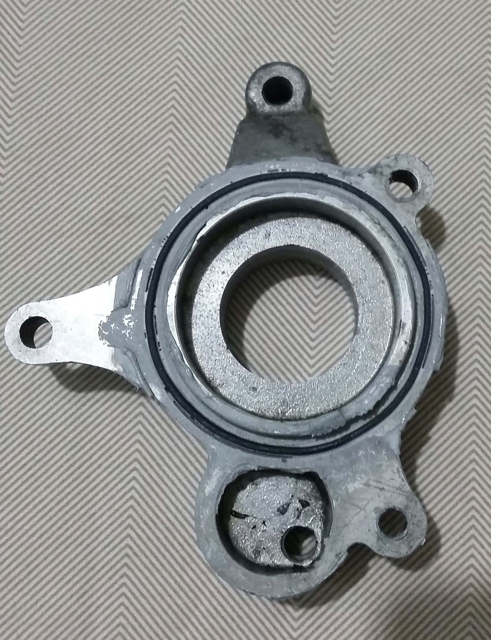

Thanks. I will try to find "Mega Grey" instead of Mannol. But u r right, base point is that until & unless we put proper sized seal, that oil leakage will not stop
