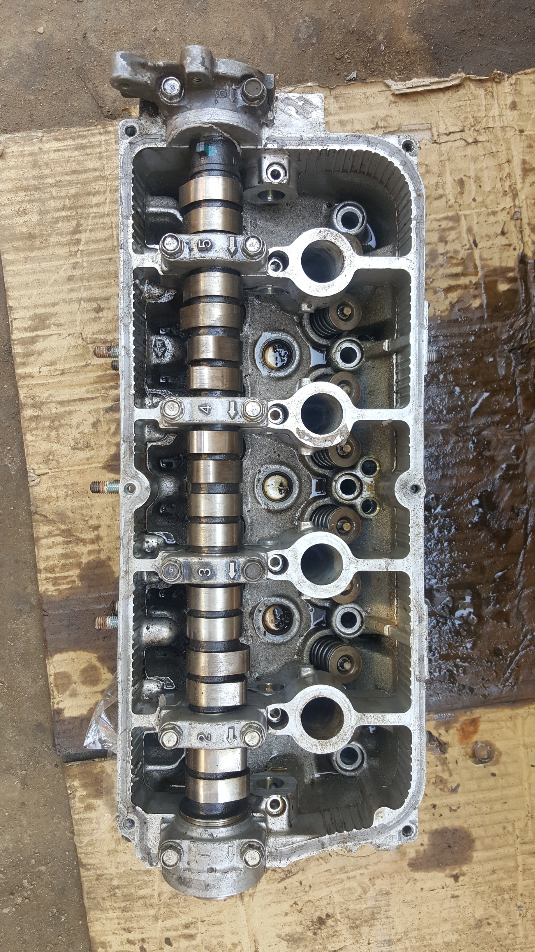

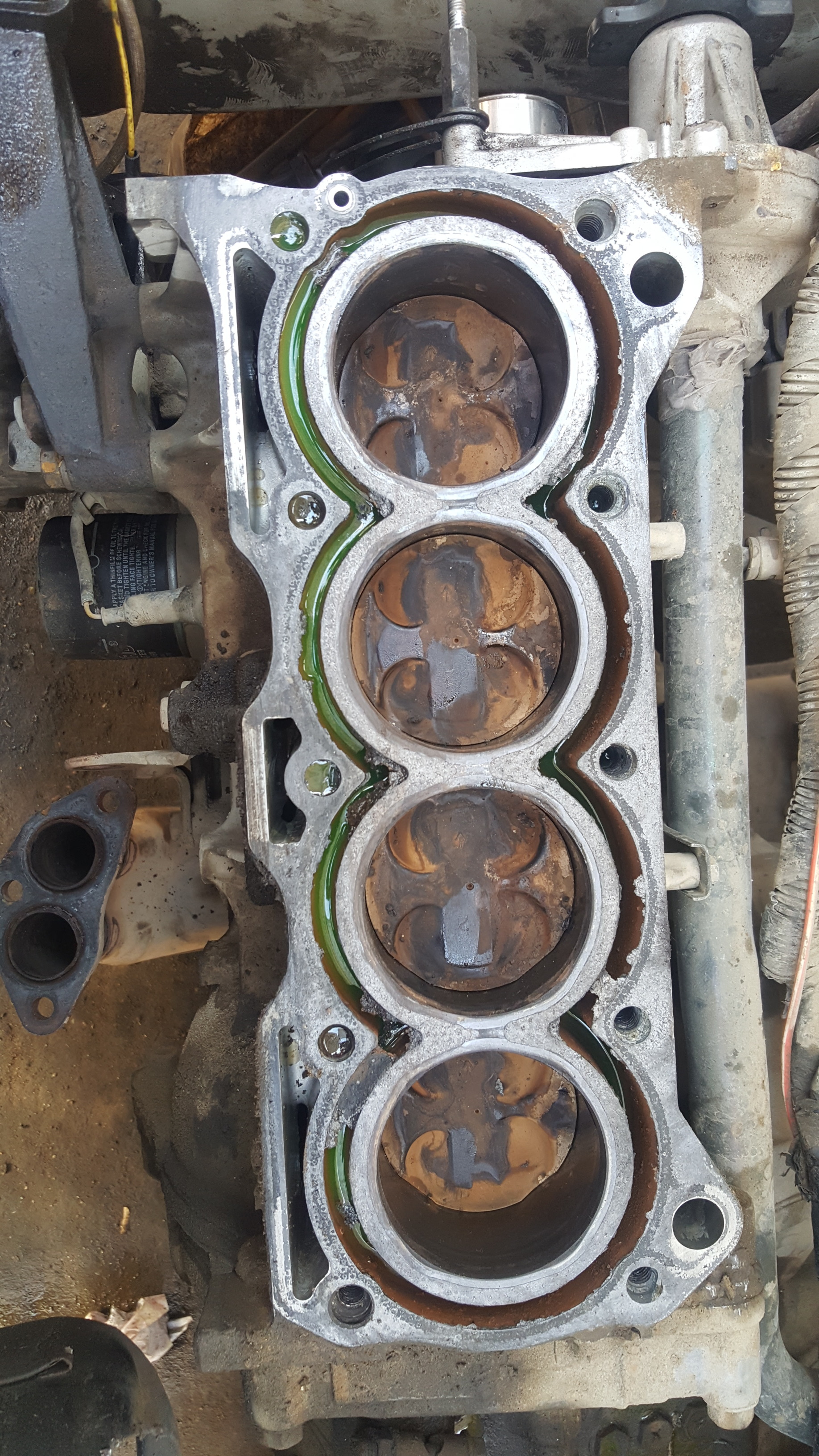

No once crank bearings get bad, they don't stop this noise unless they're replaced and you've to do complete crankshaft job.
And no @hassan1991 it's a single cam sohc engine without shims..
So you need to do crankshaft job along with diagnosing the fault, which caused this maybe bad oil or bad oil pump.
