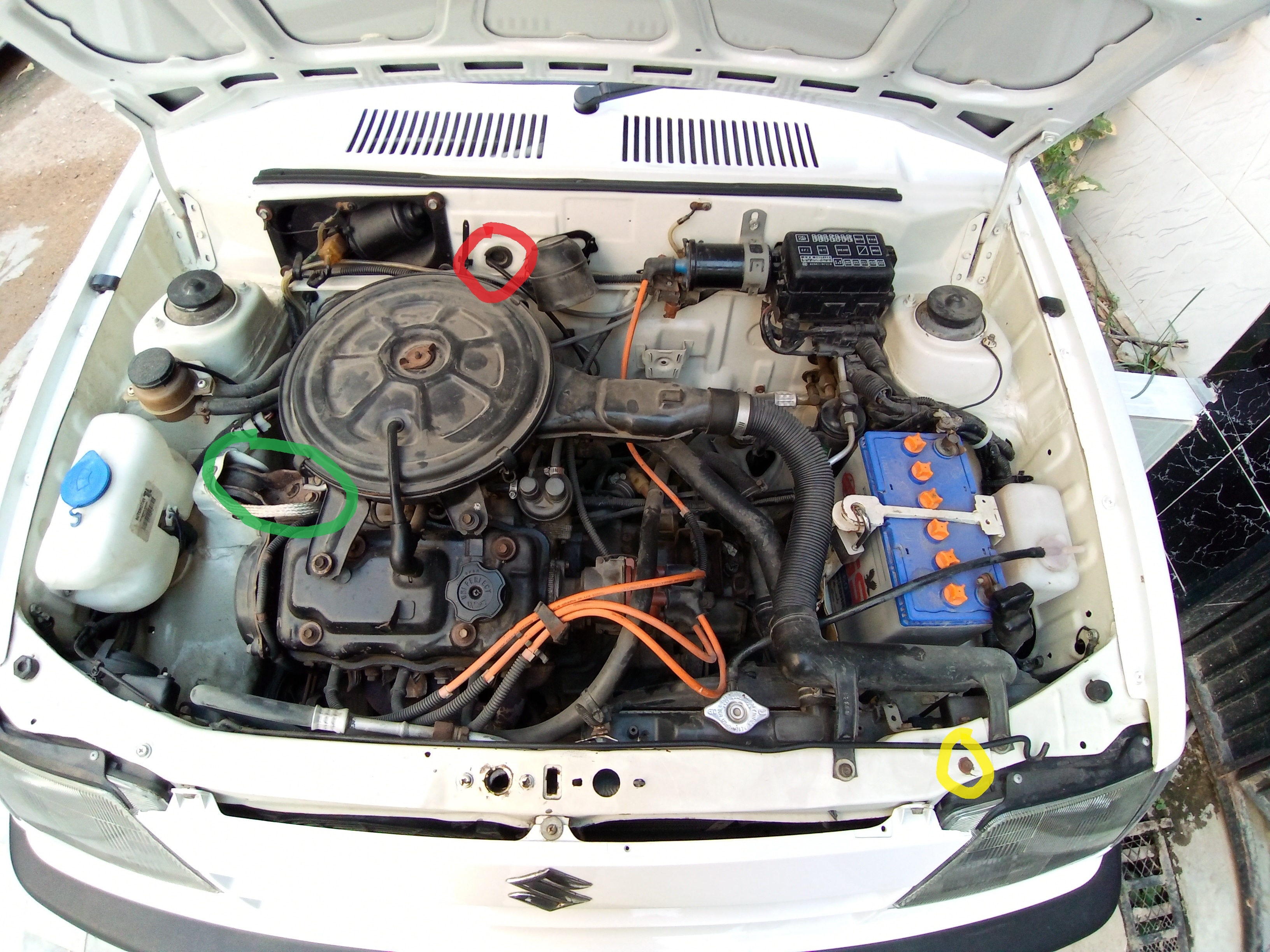

lift the hood take pictures & share, please
