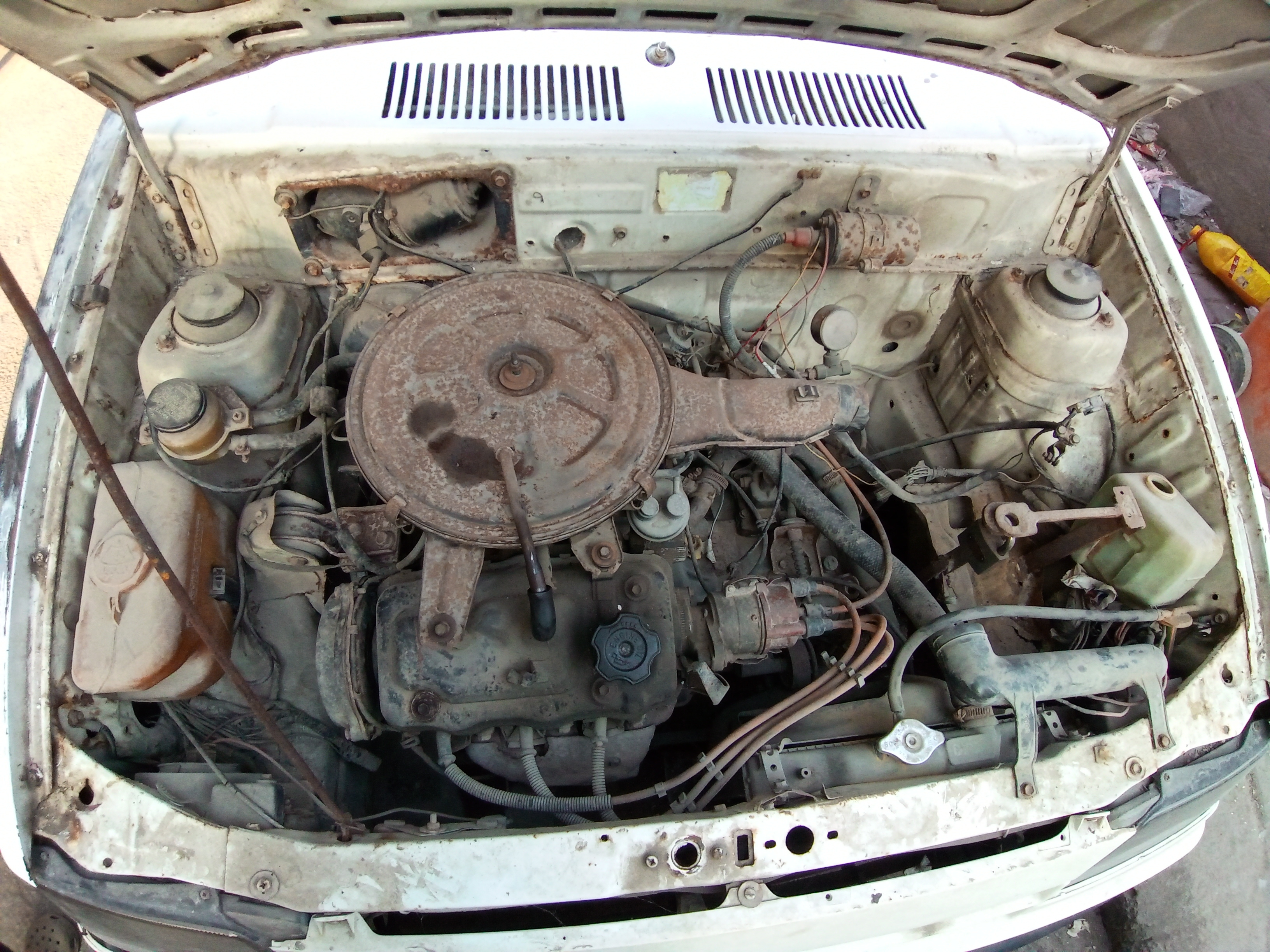

Yesterday, Me and my brother talked and showed the car to nearby skilled mechanic and he confirmed that piston rings were weak as car was emitting huge amount of white/blue smoke from exhaust. Another reason that rings need to be change is that we have another senior mechanic who is much experienced and skillful and told us the same thing. Anyway, we told him that we want the engine in factory state with thermostat installed and fan on auto. Also, told him to weld these circled parts below, resurface block, install new rockers and values if necessary and install OEM gasket. He gave the rough estimate of 45k with Taiwan parts and 55k with Japanese parts and asked us to buy parts for our satisfaction.
Your engine is in severe damaged state.Seems poorly maintained. Now you have to keep close eye on mechanic for proper repairing.

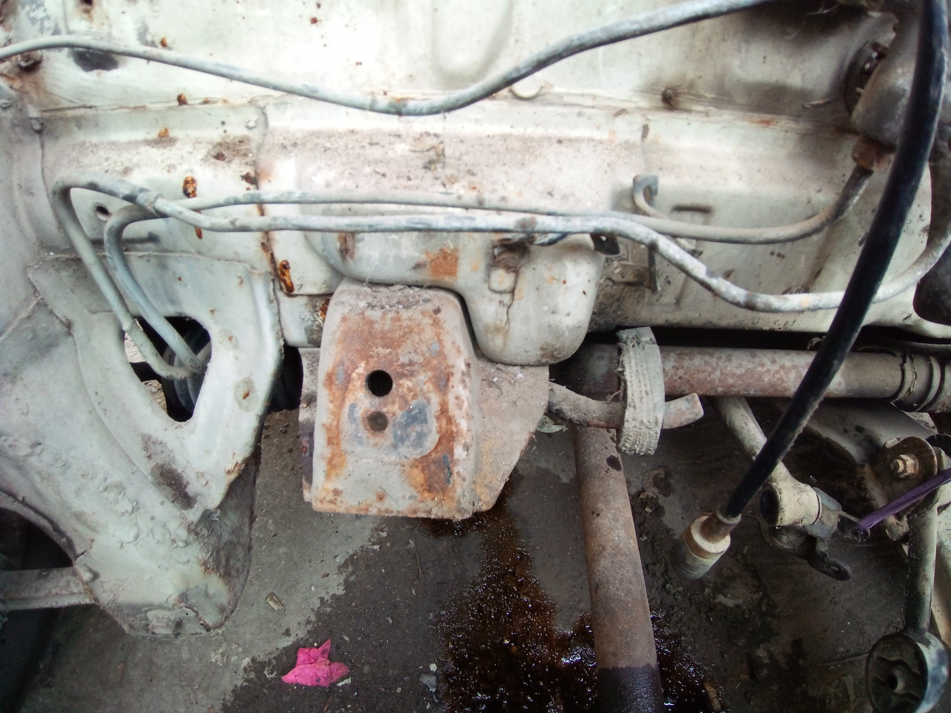

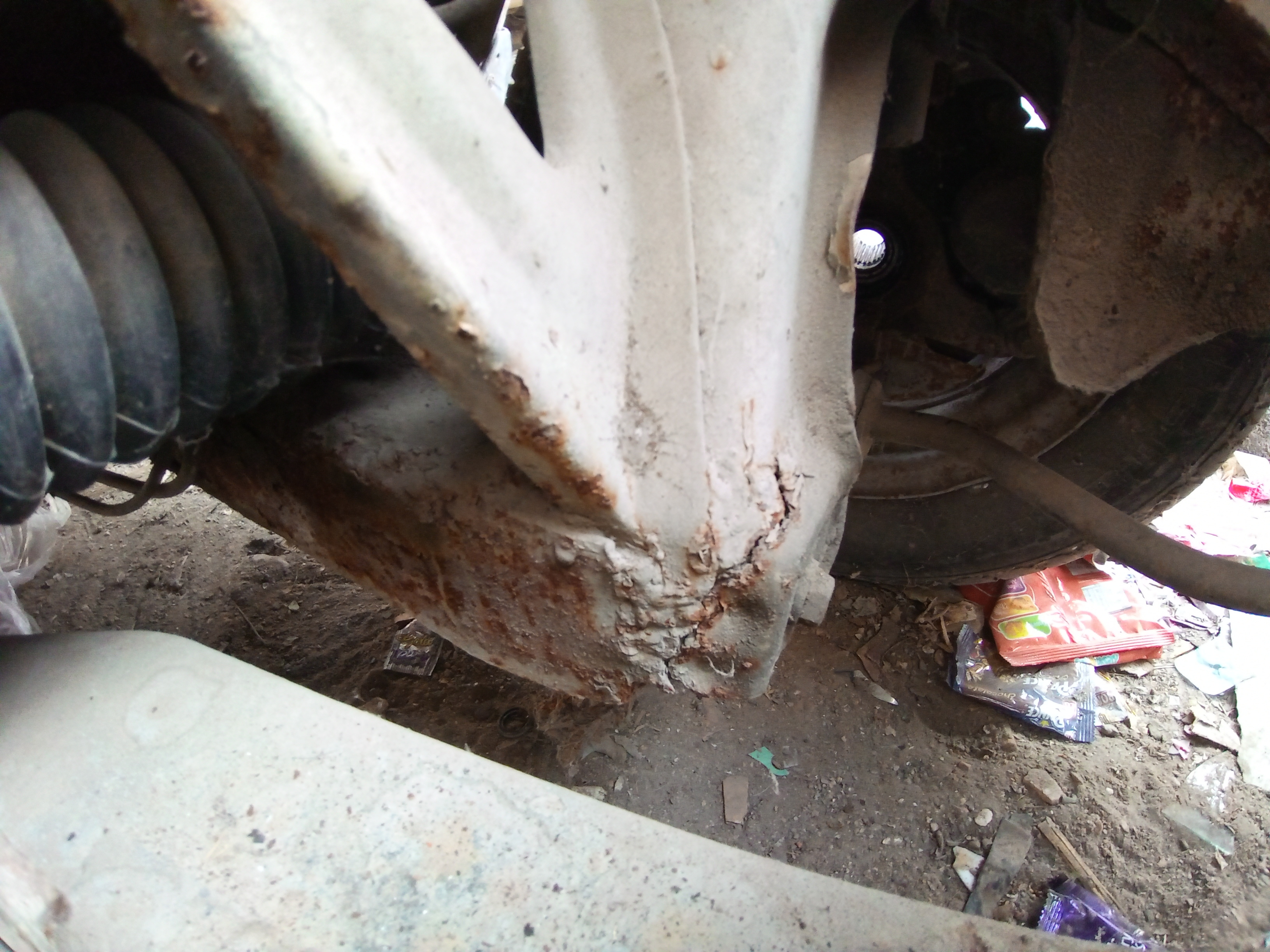

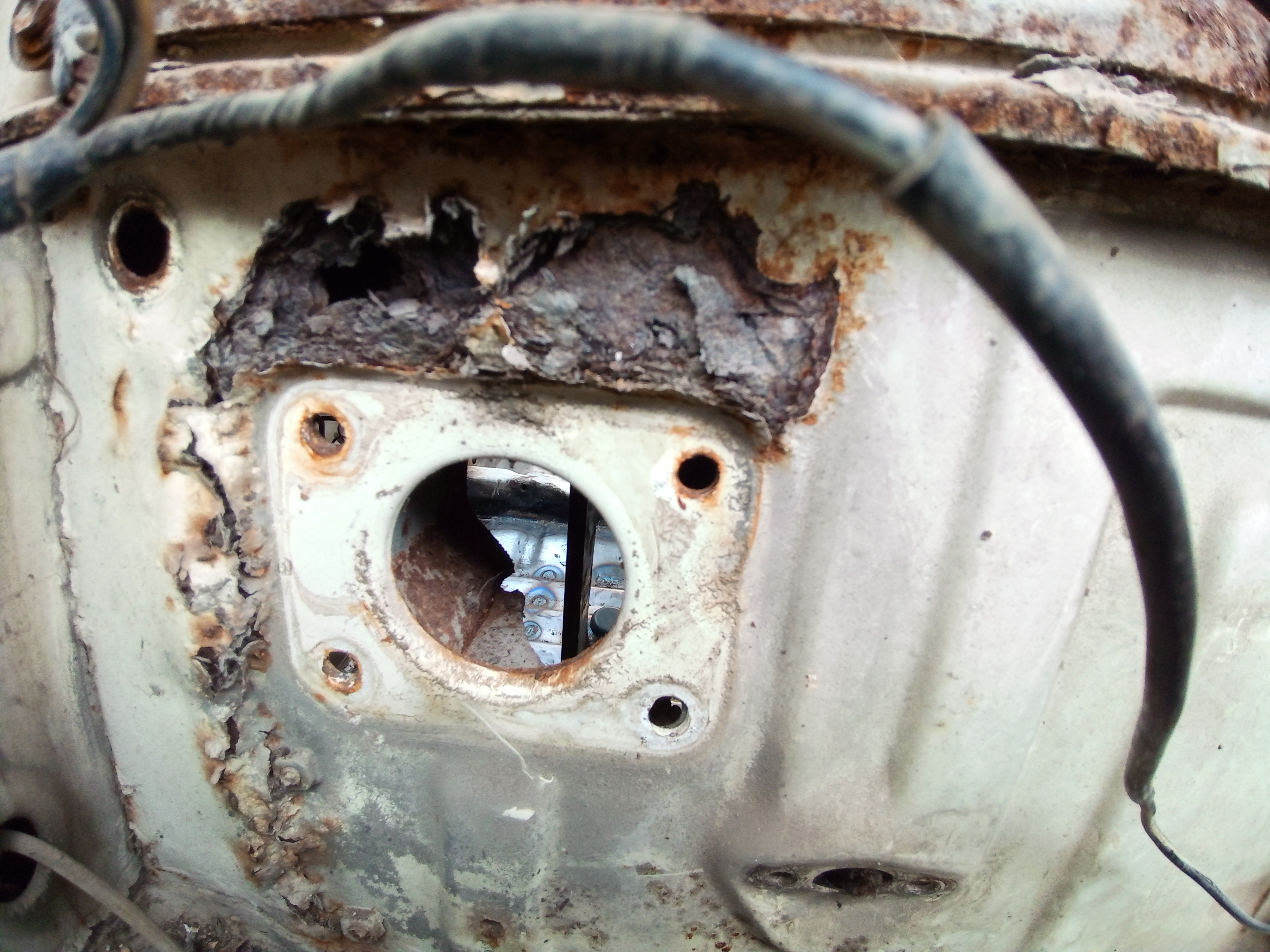

Rust spots revealed:Behind brake booster:

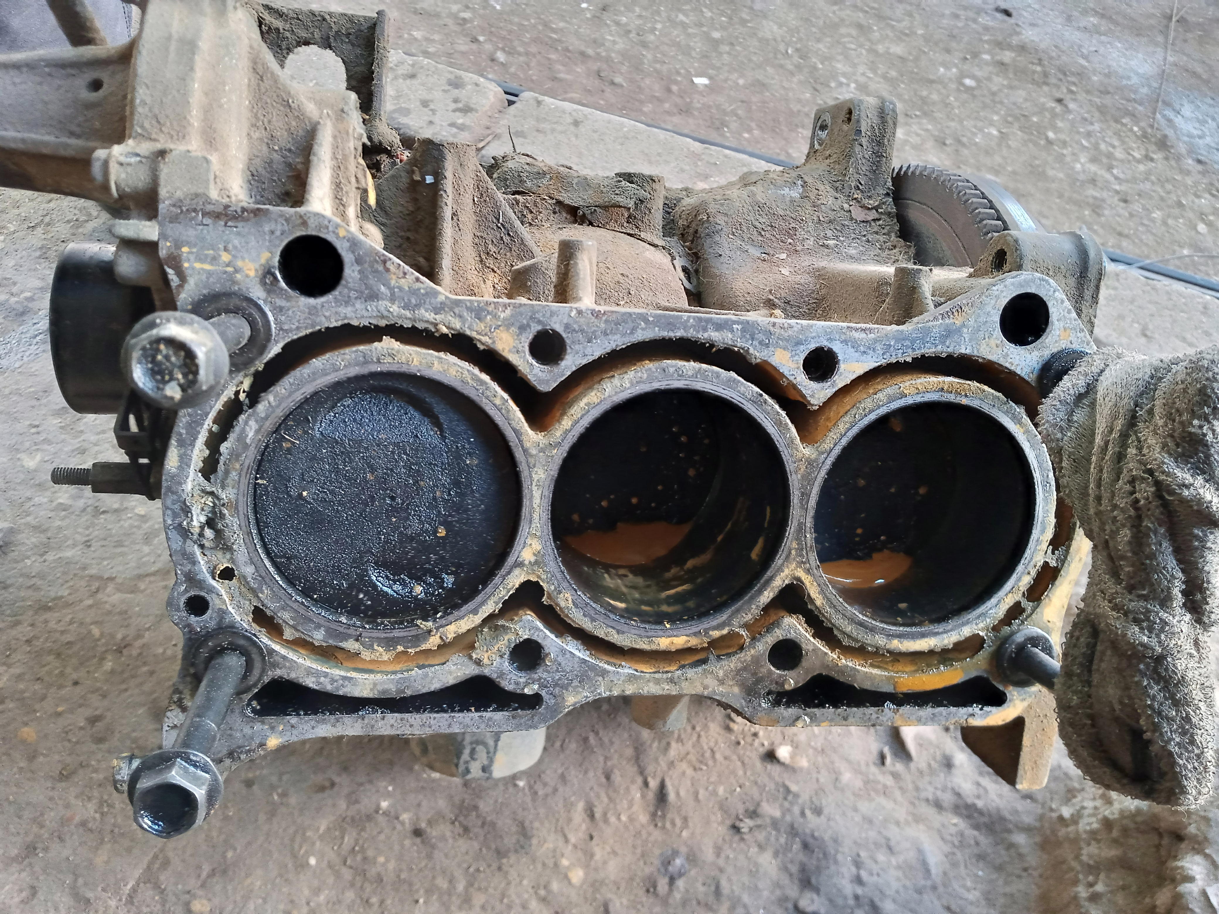

Engine Situation:
Both body and Engine are in too bad condition but Best of Luck for your project.

Woooowww. The rust... Best of luck with that...
