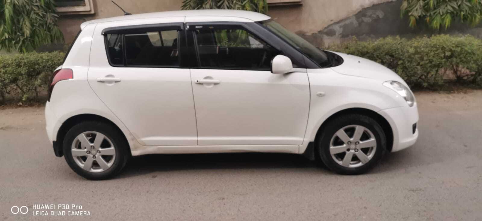

yesterday went to sultan kho to check the issue which ive mentioned very rattling kinda noise from left tyre on bumpy roads n breakers and culprit was the left shock. It was not aligned (bended a bit from bottom) then i get the both front shocks replaced kabli one for 8k pair including spings now its smooth n no noise at all loving back my swift again handling was also disturbed due to that shock thing.
