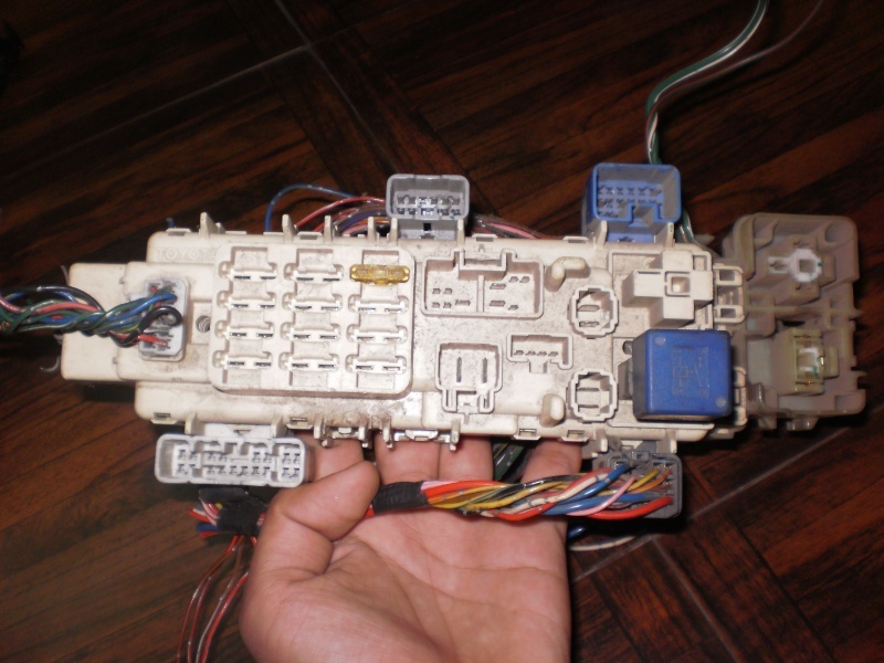

Hi brothersin following of swap efi engineIn iran there is a little #toyota corolla before 2006 And ther is not good electrician in my city.My main problem for swap engine is wiringI reaserch and find wiring diagramNext step is findin method for supply power for #ECU.I want to do it from Junction Box NO 1I need one wire Hot In ALL Time for ecu memory with fuseand 2 wire Hot In ACC for ecu powerwhat your advice for wiring this? at following is diagram of JB no1
yes sir this is the right method. Many people doesn't give direct positive to ecu. Only given through switch which is not right.

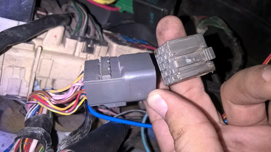

first picture id1 connector, where fule pump is prewired. only thing you do, find the true wire Blue-black
