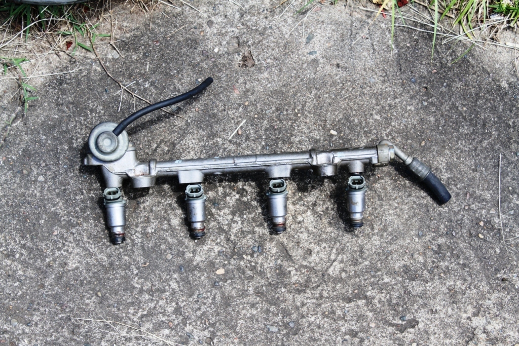

How many mounts are there in total? The one on the left near the belts is fine?Where on fuel rail is the regulator? Is it indie the engine bay?
4 mountsShow you by picture
Fule Rail
Engine mounts

Vibration can be due to bad motor mounts as Hassan1991 stated. Fuel Pressure Regulator is located at the end of fuel rail (visible on the left hand end of fuel rail picture posted by byazdaani)
