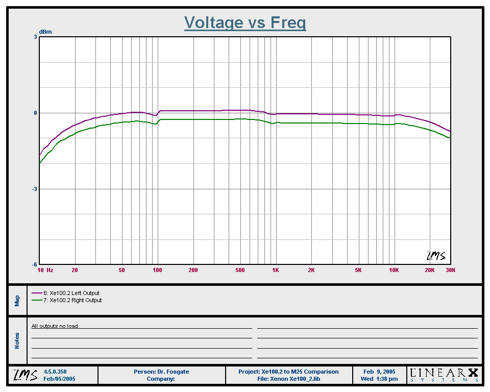

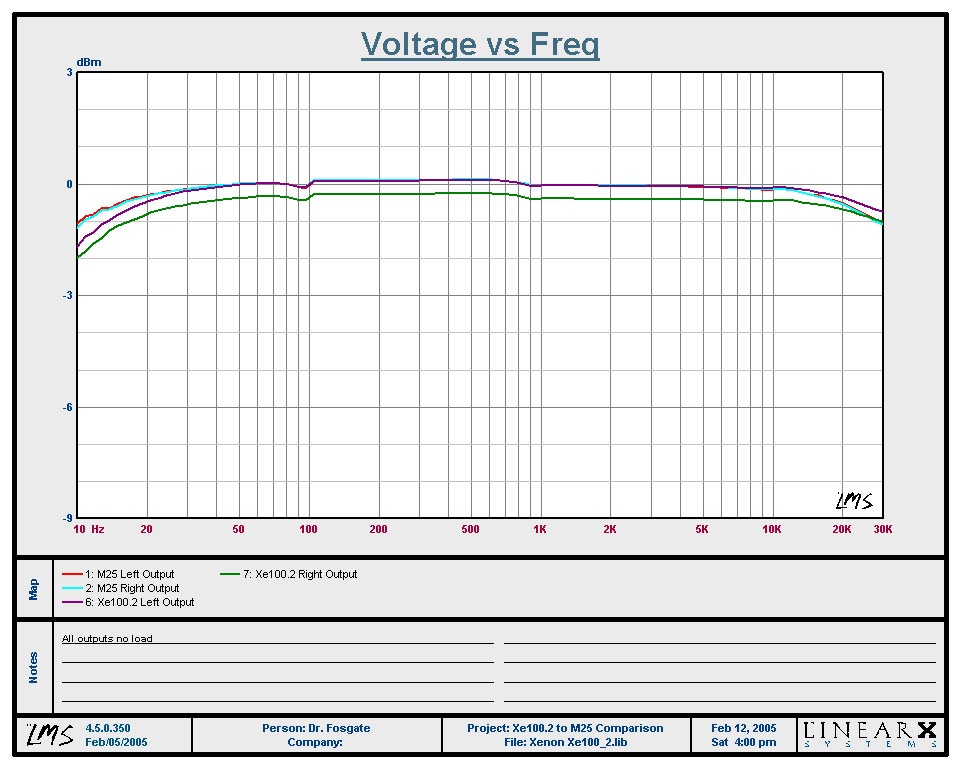

Frequency response was great. My reference amplifier is a M25. It is simply the best sounding, and best measuring amp I have come across. Mine is beat to death with all the paint falling off, but I still use it as a reference. These response plots done with my LMS show how the Xenon stacks up.

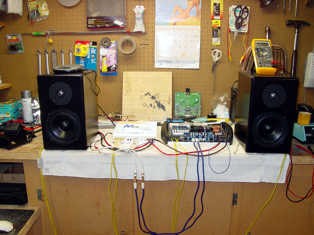

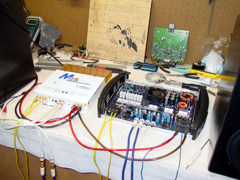

I hooked up the M25 and the X100.2 for an A/B test. You can see my setup below.
I must note I have listened to many PG amps. ZX, M, and MS. All of them sound the same at low levels. This makes perfect sense, as they all use the same basic design. The only differences between these amps are features and power levels. The M25 is a solid amp, with no onboard processing other than a bass boost, and it uses the bare minimum of parts, thus the bare minimum of inconsistency between parts.
A friend of mine who is really into audio also came over for his impressions too. I matched the gains of the amplifiers as close as possible with a DMM and a 1kHz tone. I used my DIY 8 ohm home speakers which have been measured to be a near flat response with very expensive test equipment, while I worked for Rockford. We played an assortment of CDs, mostly Rock, and Pop.
The results were as follows: We were consistently inconsistent, if you get what I am saying? This testing was done blind, with one of us running the switching, and the other listening. I picked one I liked better, then at a later time picked the other amp. He ended up doing the same. He was fully confident he knew one was better, but his choice changed randomly. This went on for well over an hour, and I developed a headache from trying so hard to hear any difference, there simply was none.
