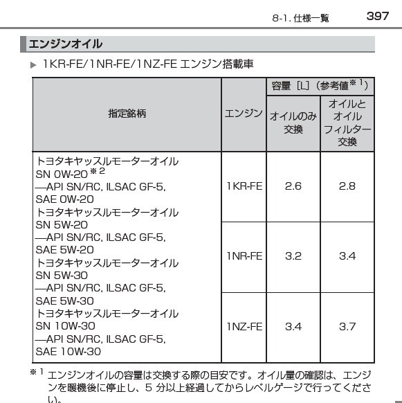

Picture taken from the manual of 3rd generation, 1st Facelift Vitz (April 2014 and onwards)
Here, new, improved and refined 1KR-FE, which requires 2.8L engine oil with oil filter change. So, I can assume that improved and refined 1KR-FE in Vitz was introduced in April, 2014 and onwards, in 1st facelift version of 3rd generation Vitz (my car; 2015 model 1.0F Vitz (manufactured in November, 2015) falls in this category, and all the things as per following owners / users manual will apply).
Recommended engine oil grades: 0w-20, 5w-20, 5w-30 and 10w-30 (with latest / current ratings, i.e. API SN with RC (Resource Conserving) / ILSAC GF-5)
So fellows, ZIC A+ 5w-20 (or from any other reputed brand; Shell, etc.) is fully and equally compatible with 2015 model Vitz. Guaranteed and confirm as per manual.
Source: https://toyota.jp/pages/contents/vitz/003_p_017/pdf/spec/vitz_201605.pdf page 399 of 440
(please download and save this manual. This is the manual which 100% applies to our models)
