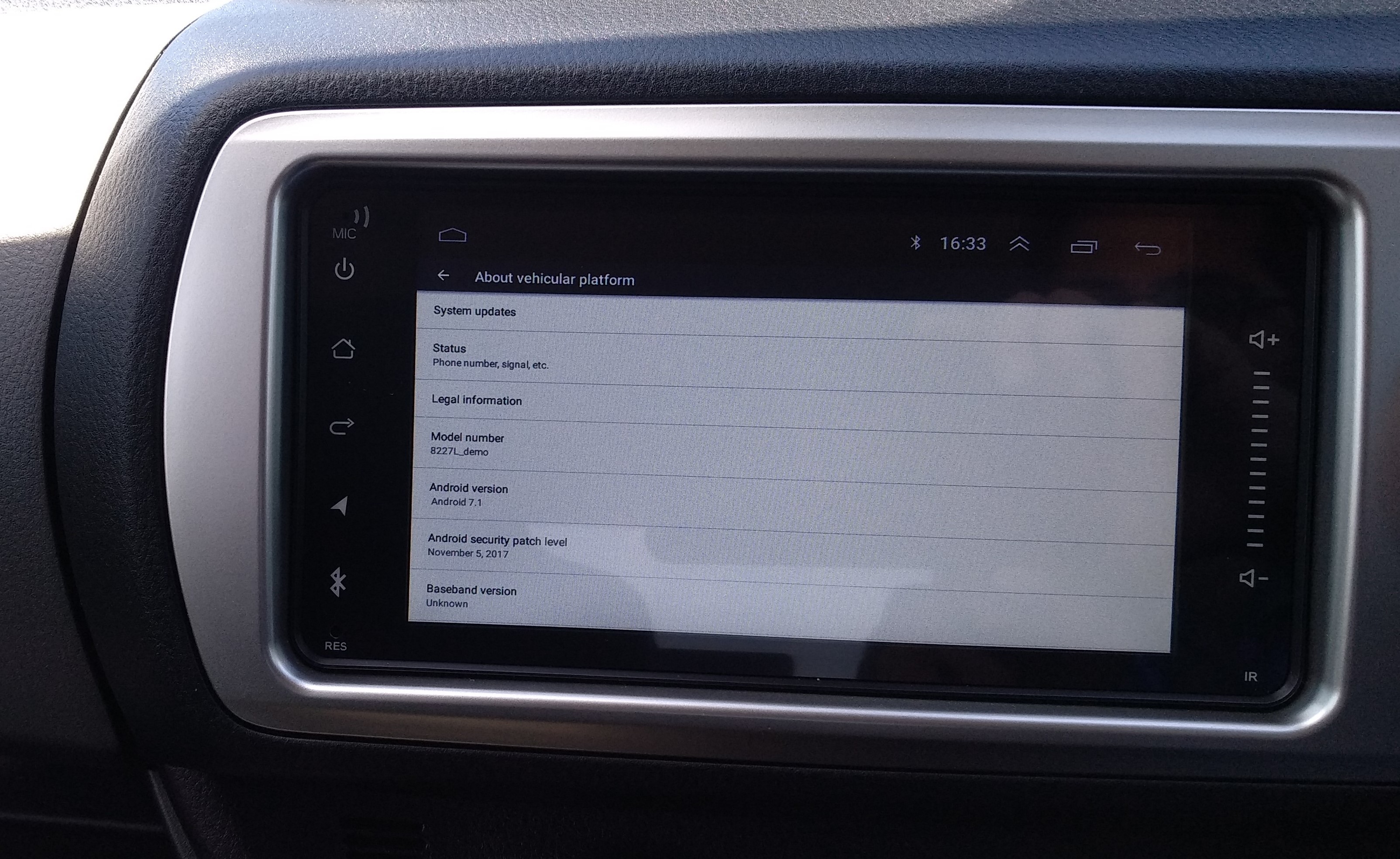

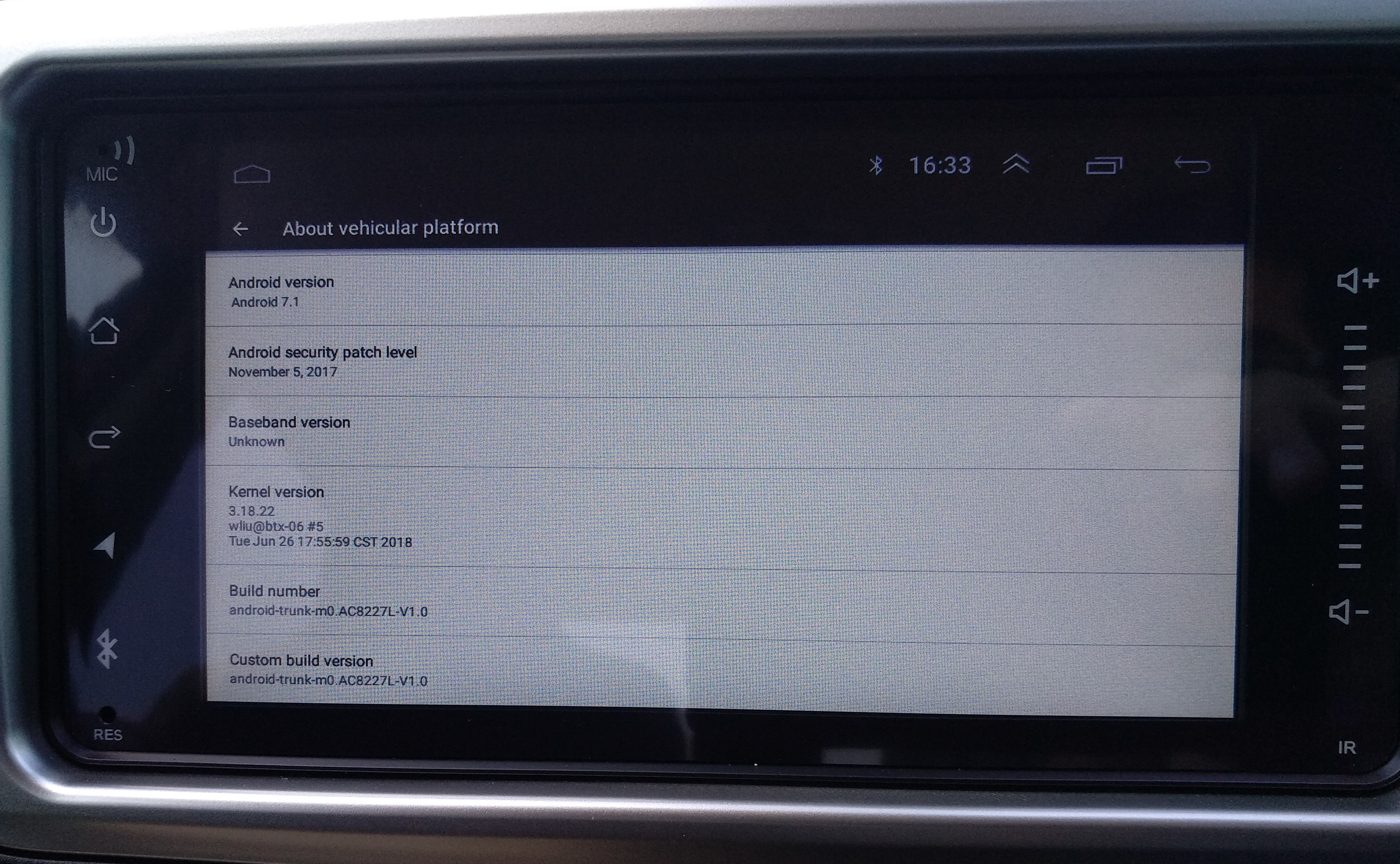

- Best quality one will be proper Android Head Unit, in fact Toyota Universal Android, with 1 GB RAM + 16 GB ROM, Android Version 7, reasonable quality, above all; grip-to-grip fitting. Of course, Navigation, GPS, Car speed at run time, Blue Tooth, WiFi, etc. are all supported (I am not sure about other 02, but this has 06 months warranty). Cost: Rs. 13,000.

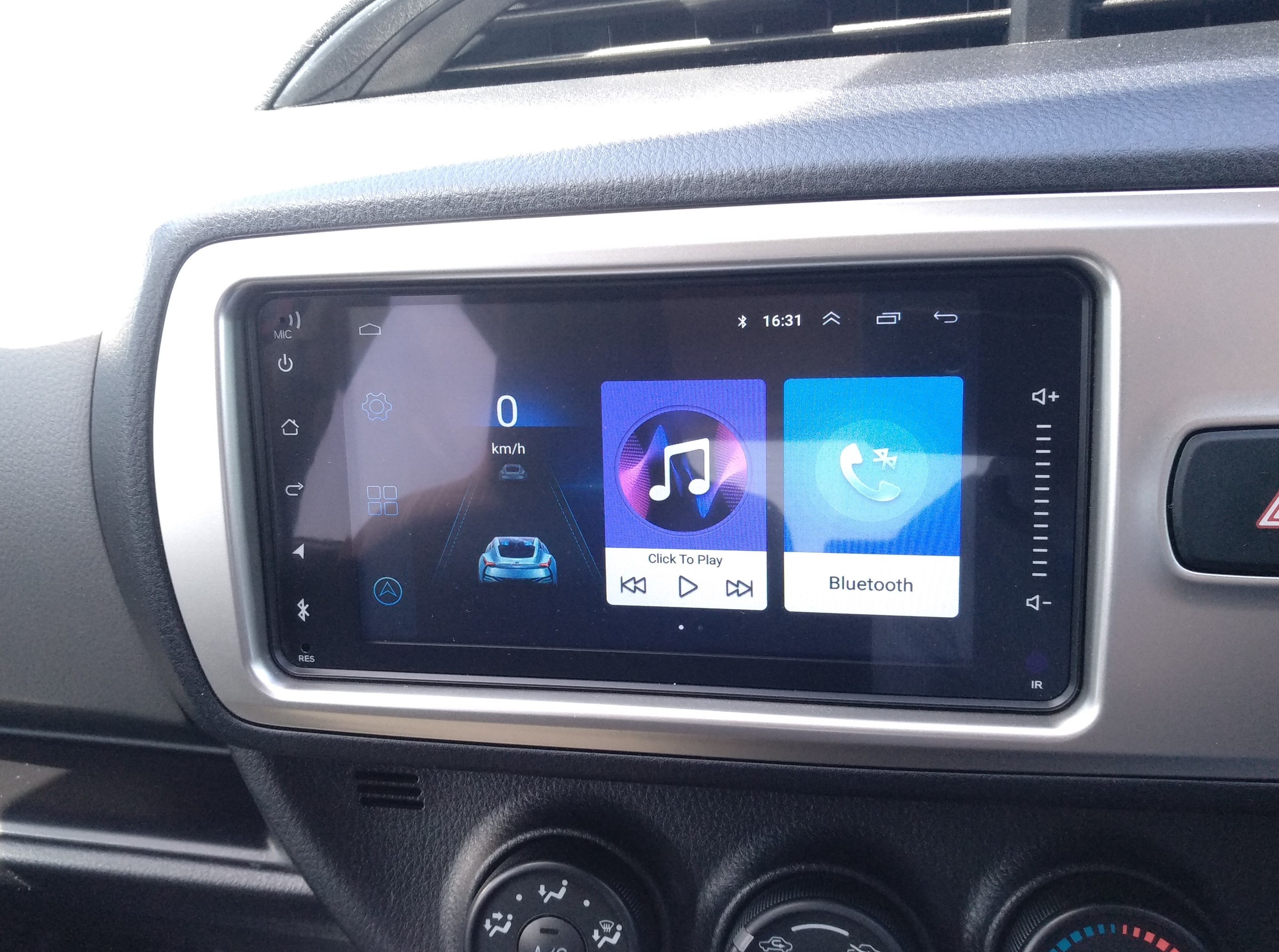

I have used my head-unit for some time, and the sound quality is MA SHA ALLAH, Superb. There is no lagging or slowing down of the head-unit, and no issues faced till now.

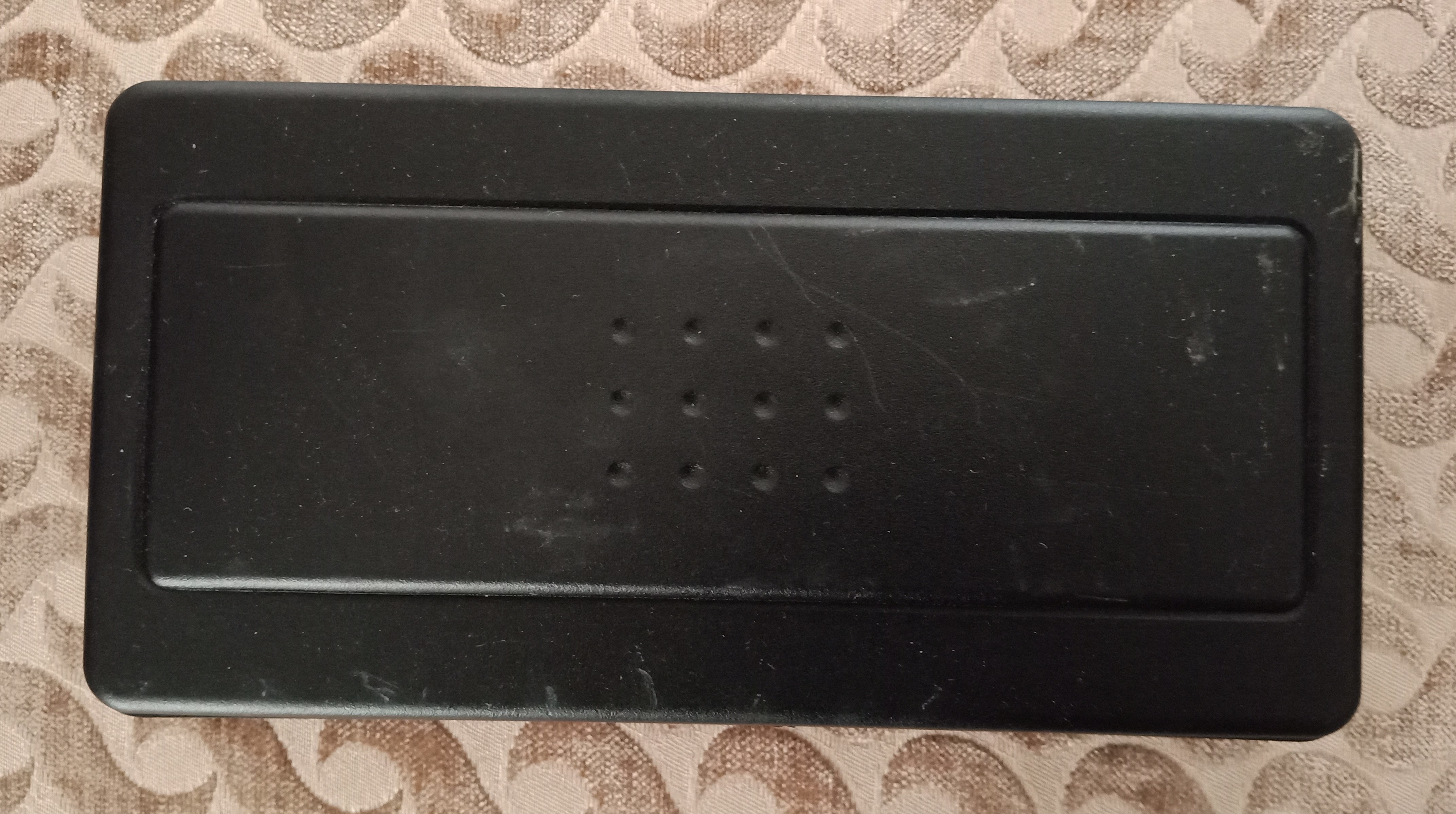

Box of the Head-Unit

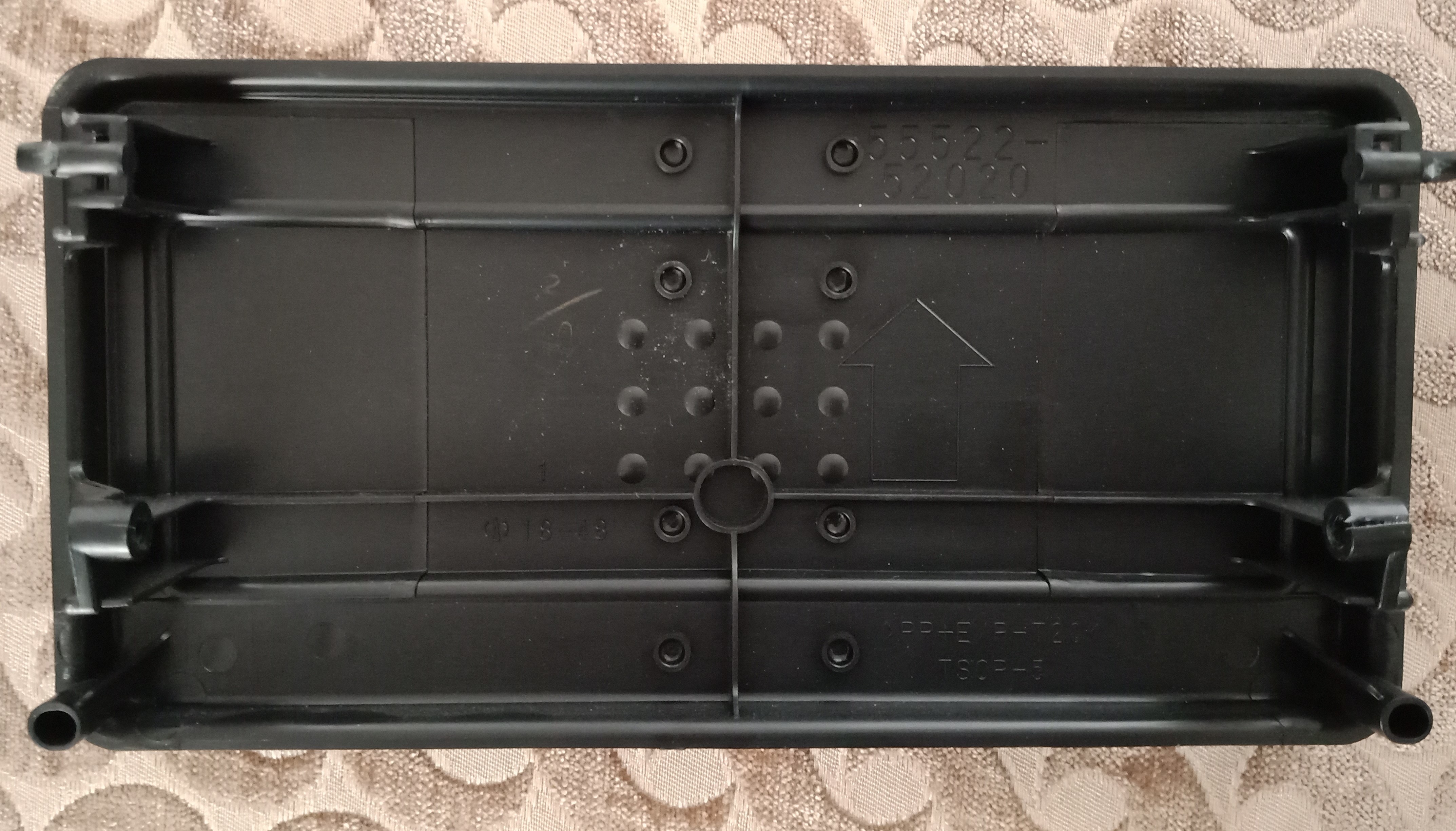

Casing / "Khool"
(which came from Japan)

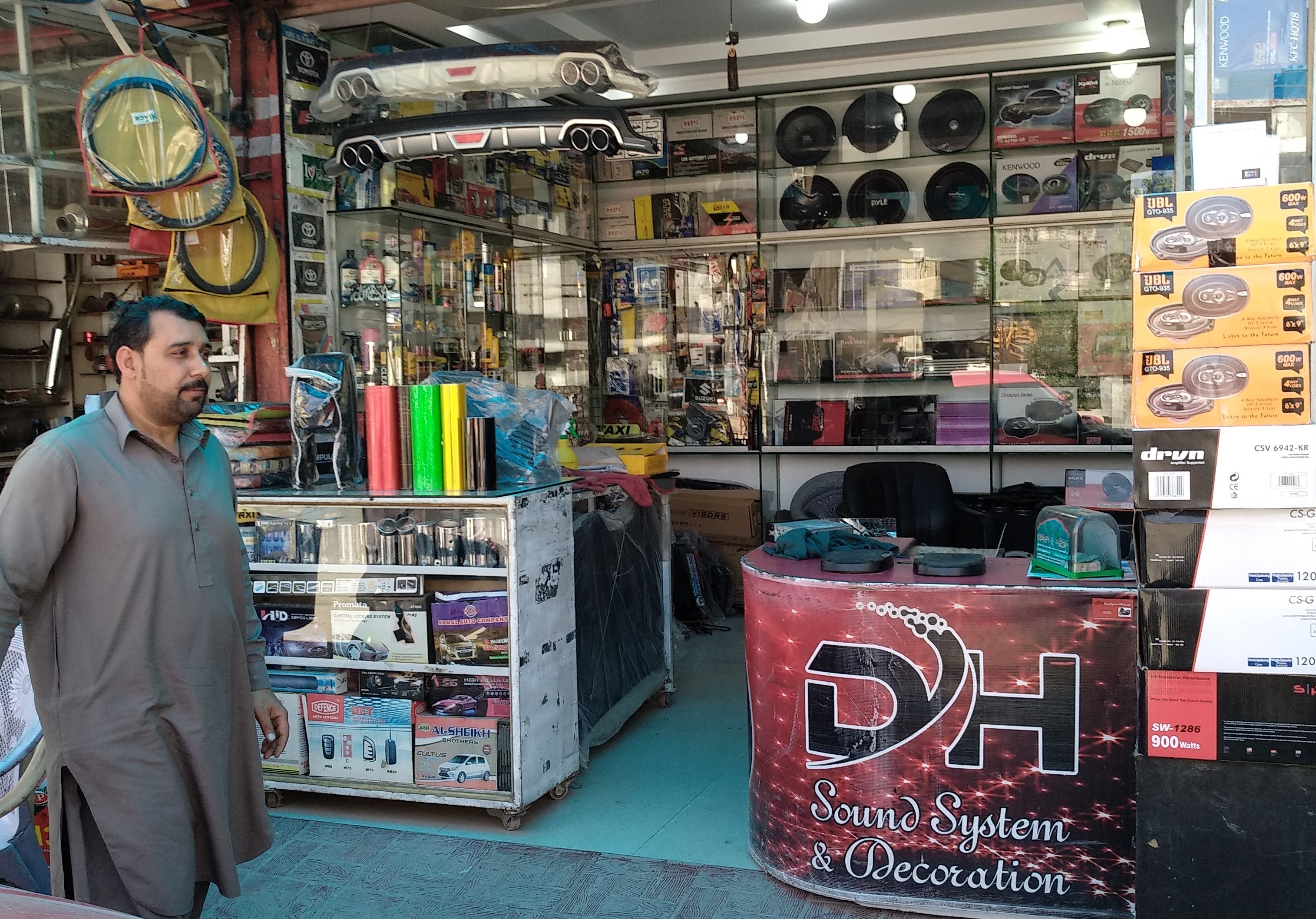

Shop from where I installed Tinted paper and Android Head-Unit
The guy is the shopkeeper, and also installed Android Head-Unit (I think, he is also the owner of the shop)

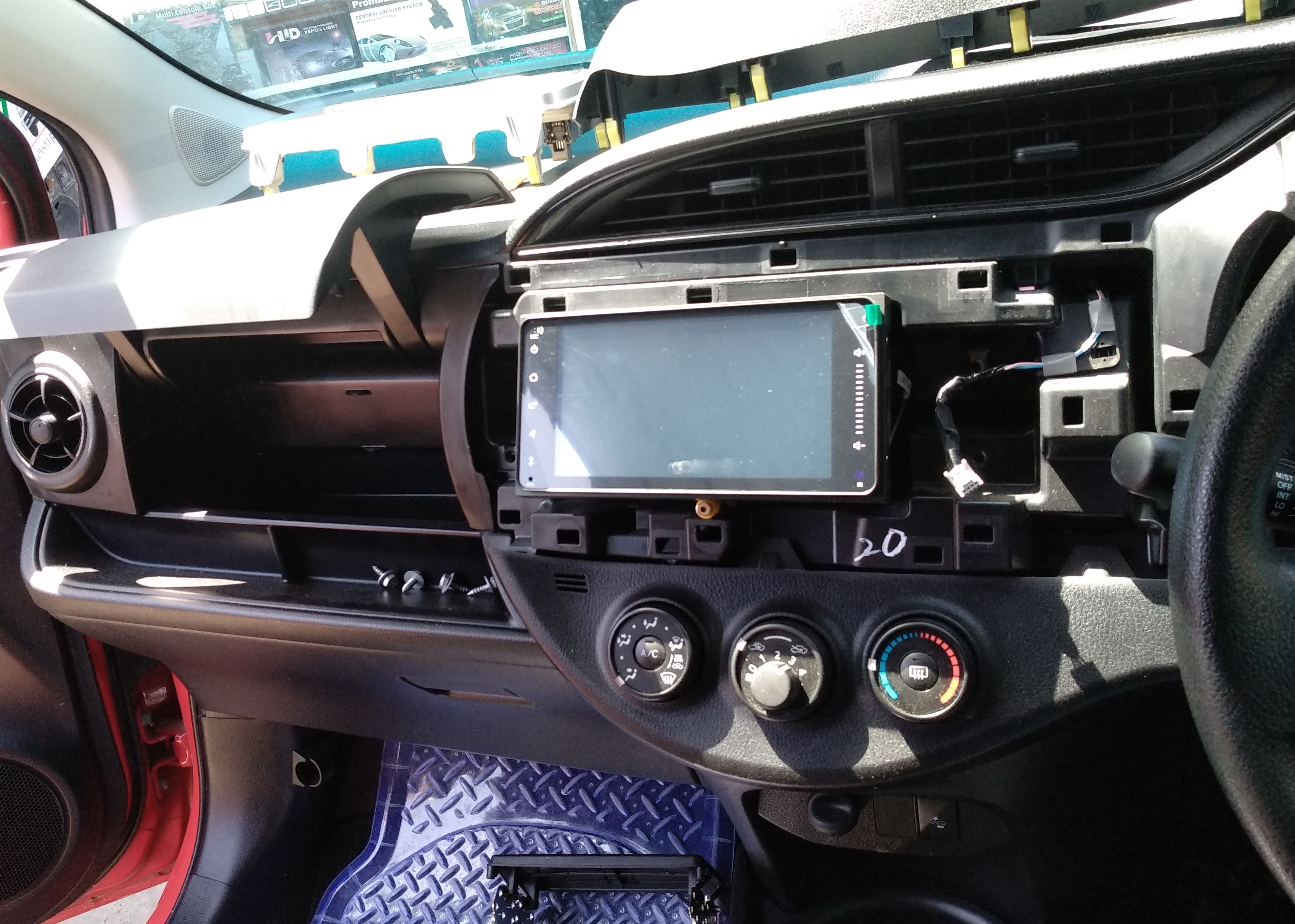

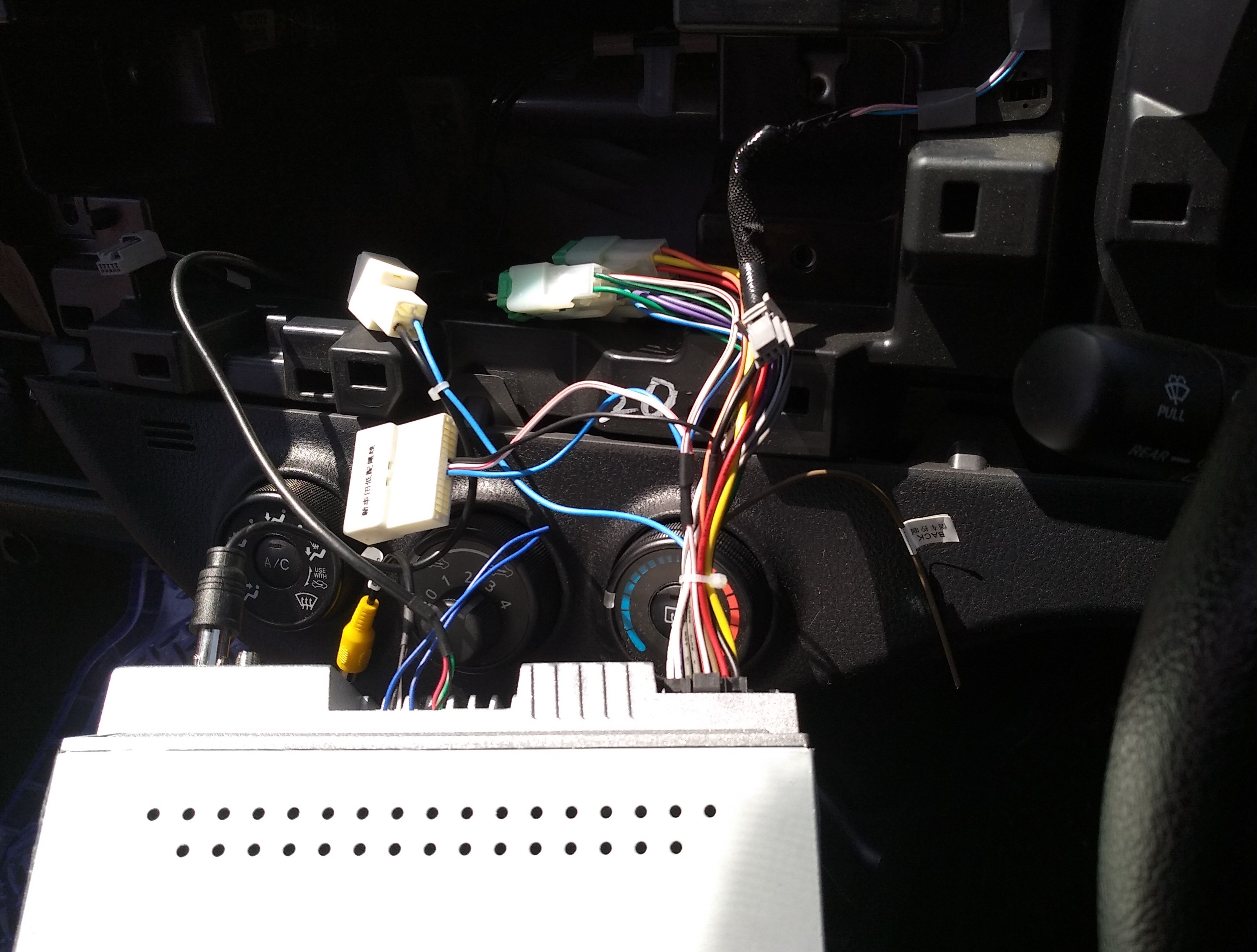

Installation works in progress...

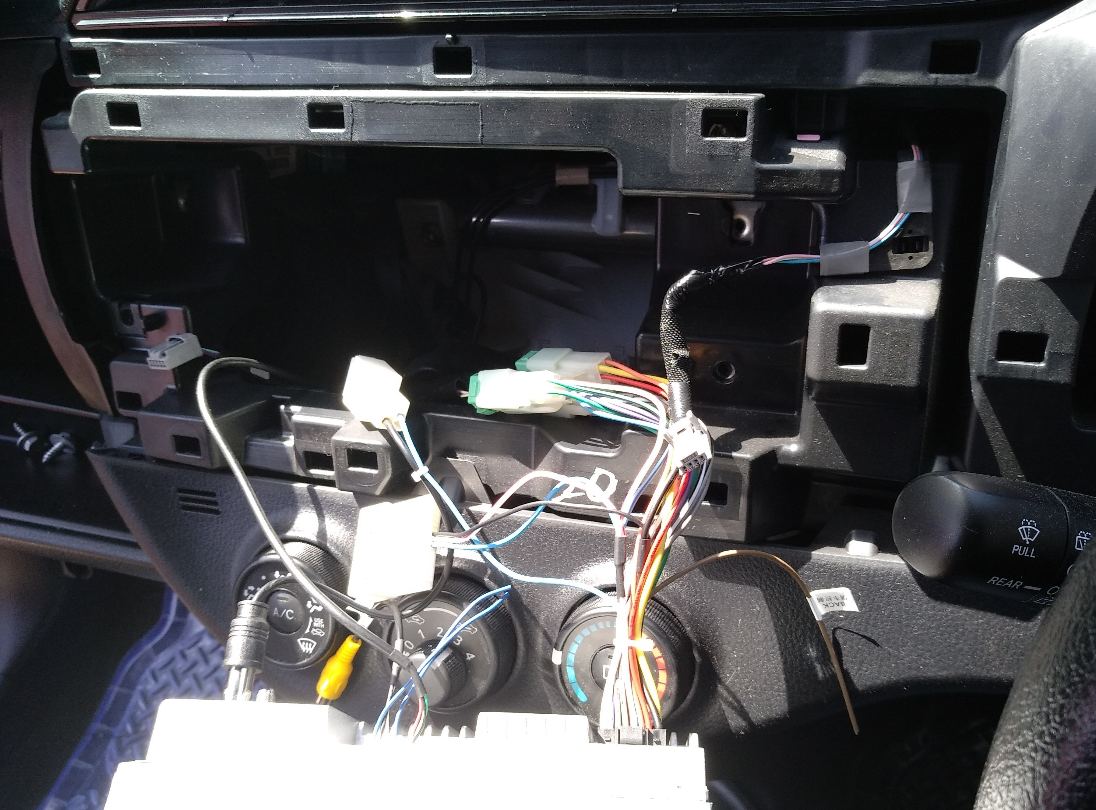

Still in progress...

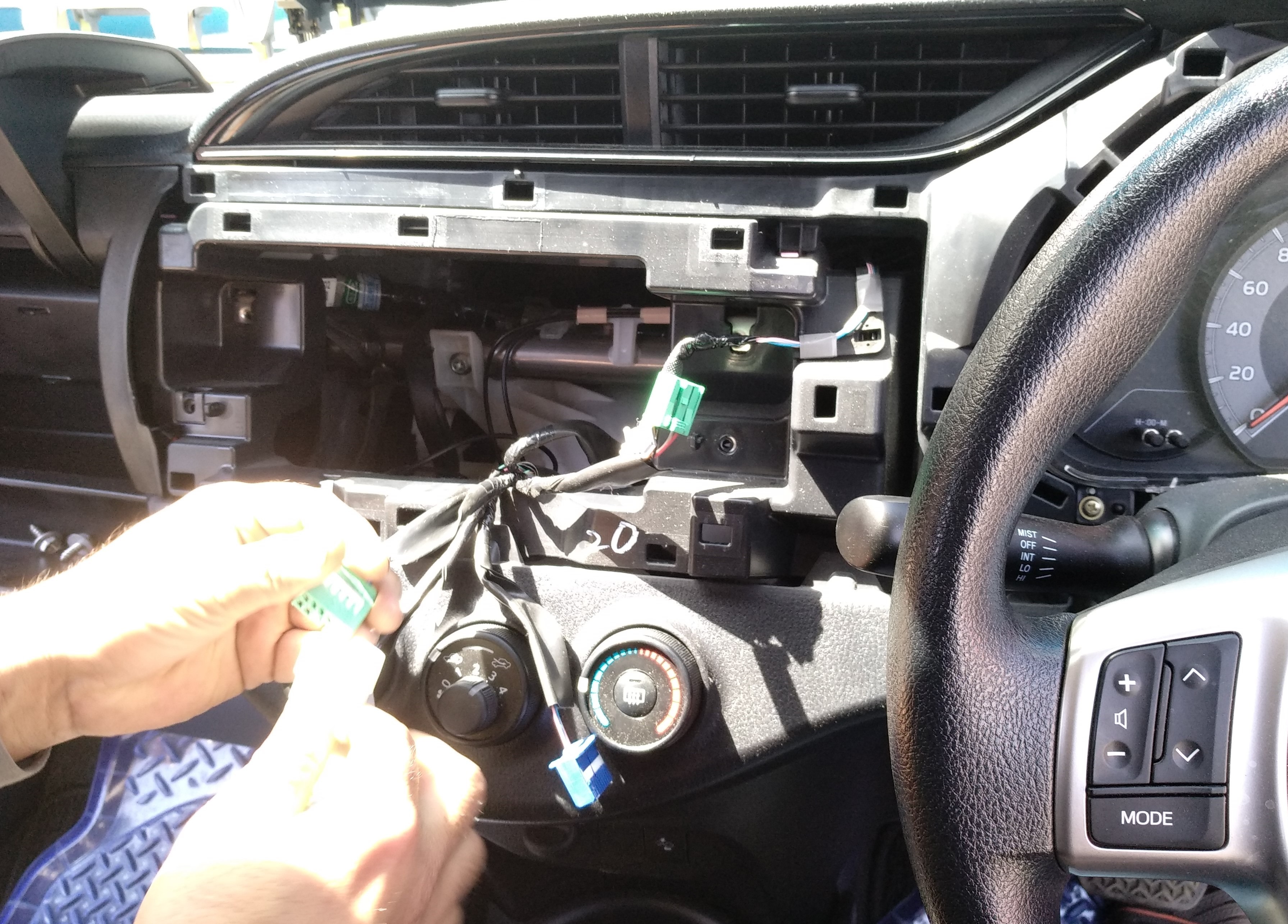

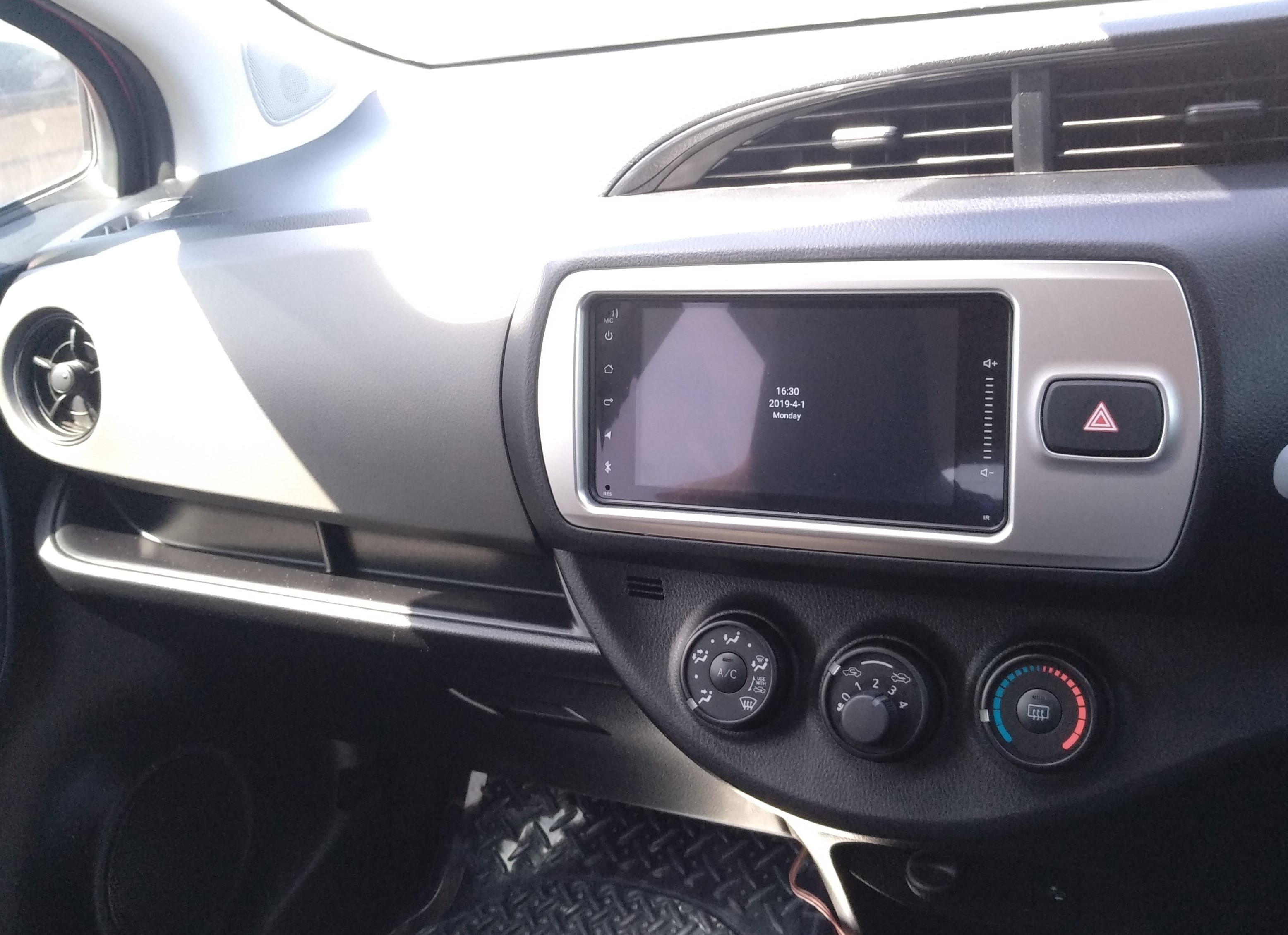

Partially completed and fitted
I did not let him 100% finish his job. He made all the connections; the panel was partially fitted, however, I requested him not to close everything, as I intended to bring my ride back to my home, clean the dashboard and other panels thoroughly via air blower, vacuum, and dashboard cleaner, from inside and outside, and then fit everything. I requested him to guide me, how to close it properly, and he happily guided, to which I am obliged to him (it may not be difficult at all, however, if the work is major or minor, usually shopkeepers do not tell their secrets to consumers).
Rear view camera connection took some time, as no direct connection port was there, however, the most difficult ones were the multimedia steering wheel connections. No direct connections were there. We had to rule out things one by one. It so happened that if 03 buttons worked, 04 didn't. If 04 worked, 03 didn't, etc. 07 buttons, and their full, proper working (all at once) baffled both of us, and it took us almost 2-3 hours to complete the whole job, from start, till partial fitting. However, at the end, job was successfully completed. AL HAM DU LILLAH.

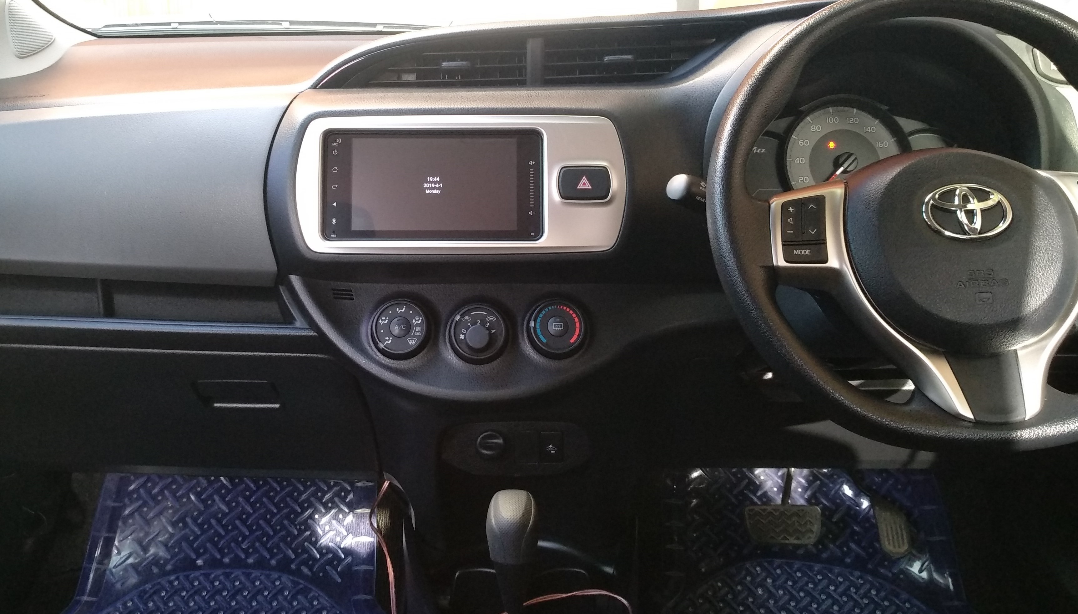

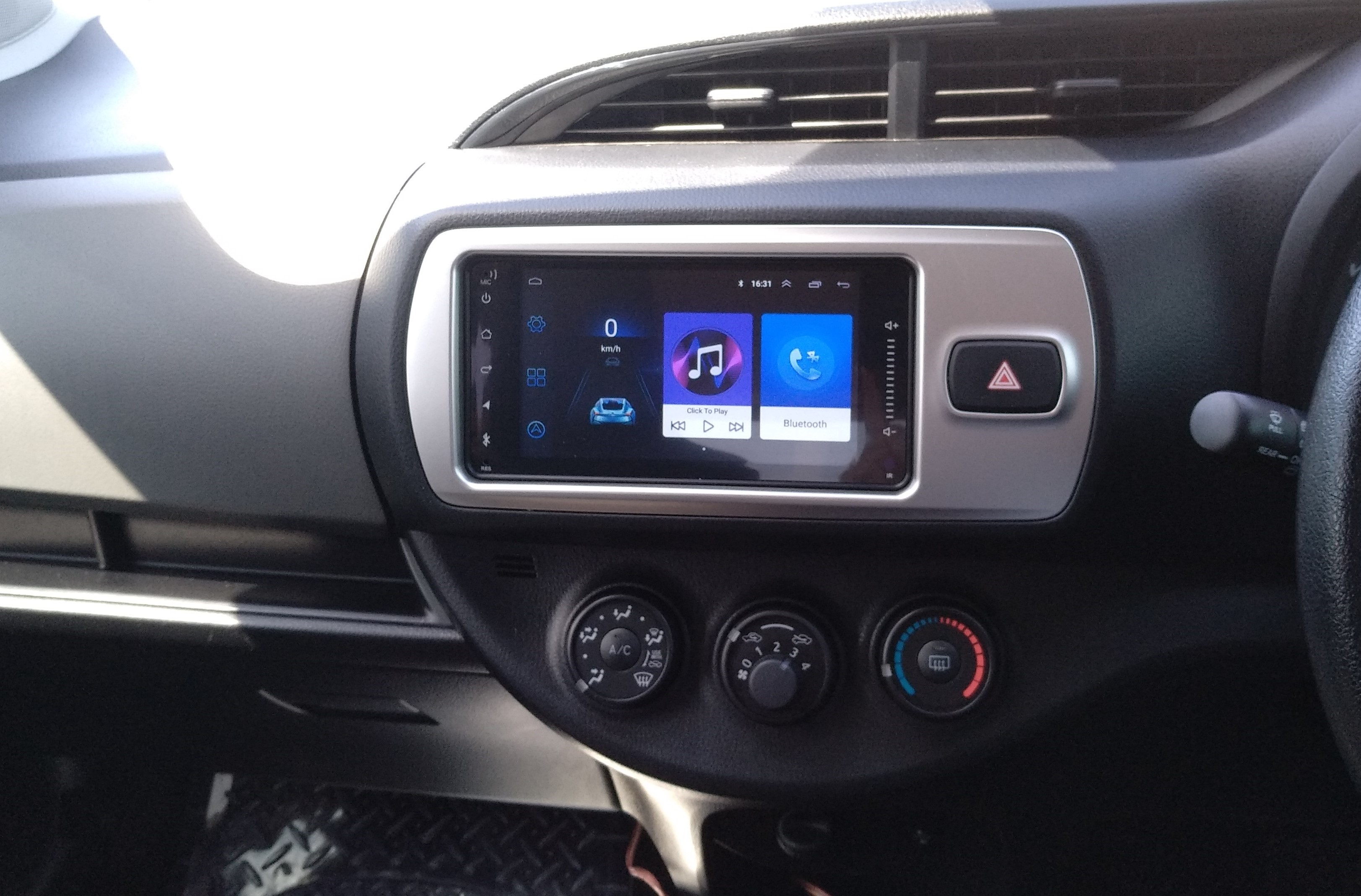

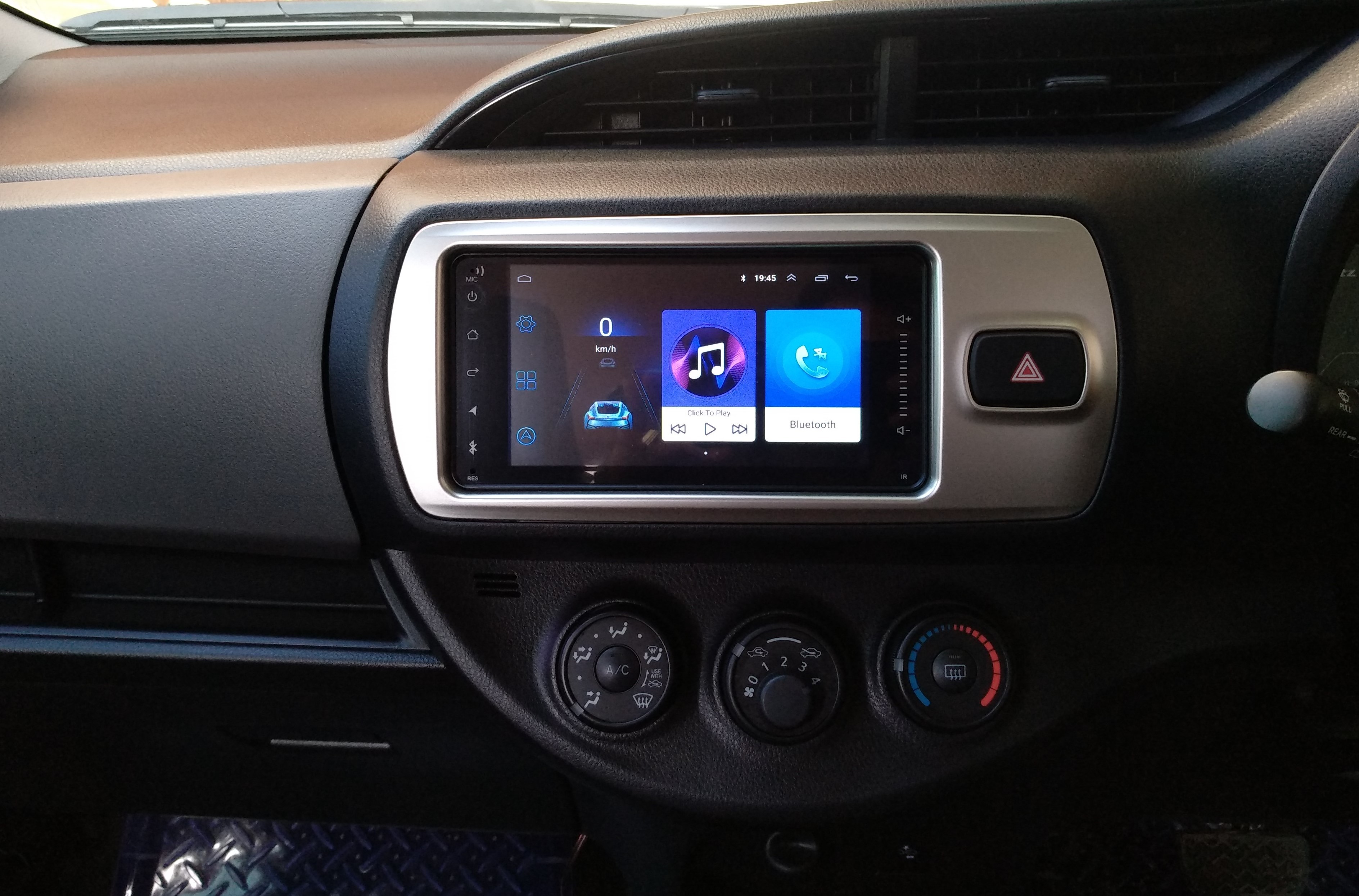

Final pictures after full installation and thorough cleaning of my ride (Interior and Exterior)

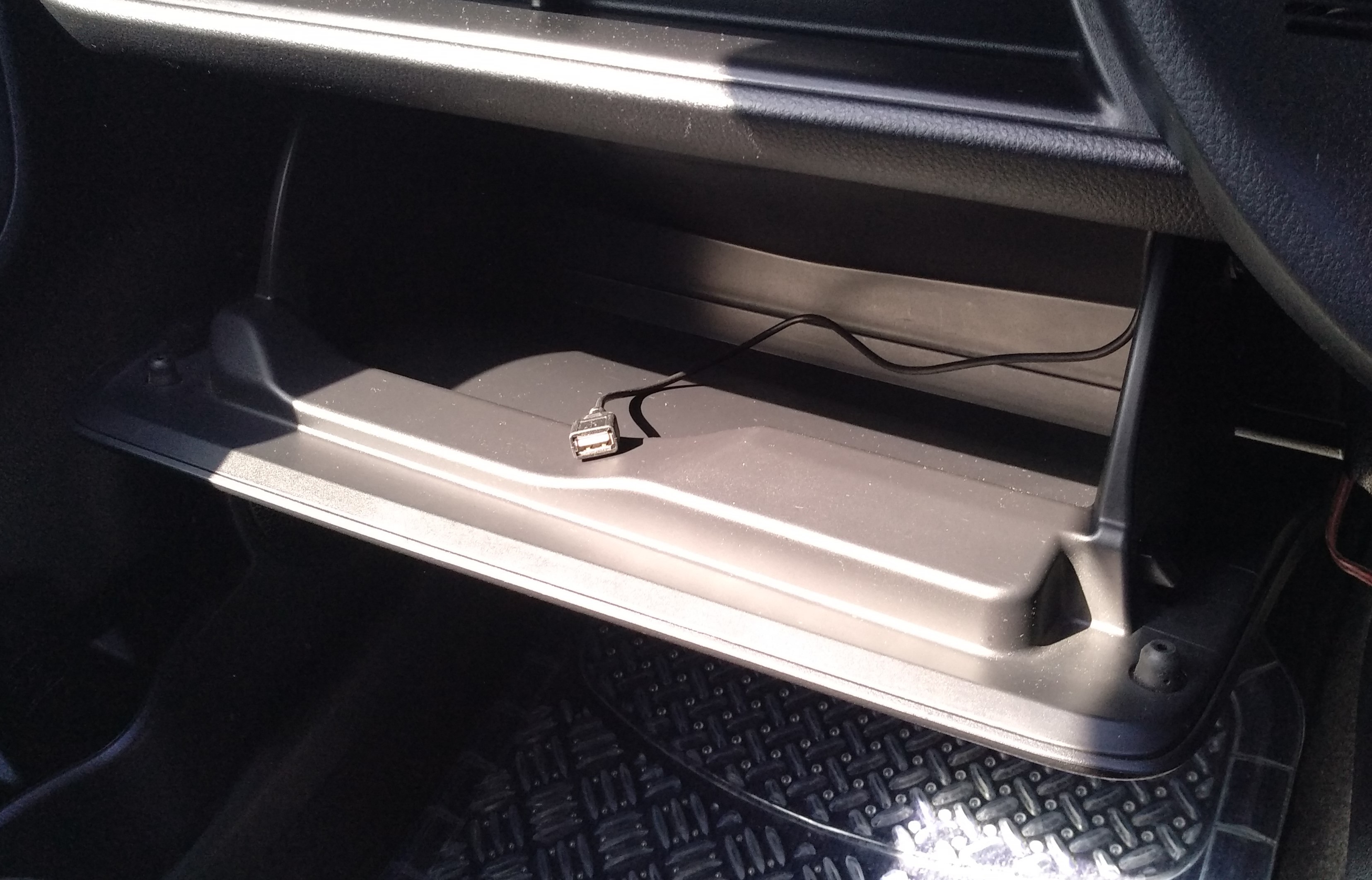

USB connection in Gloves Compartment

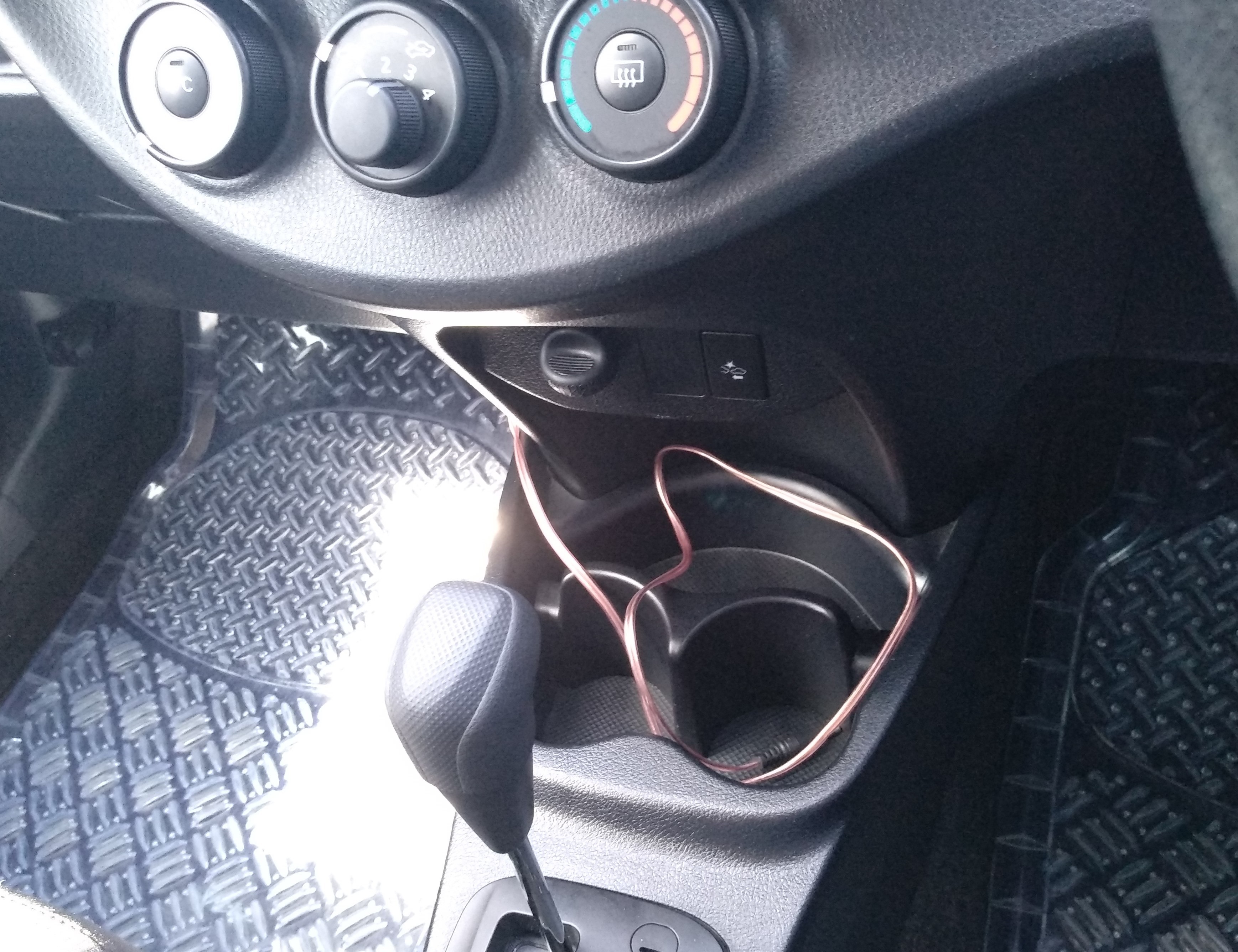

Aux Cable
