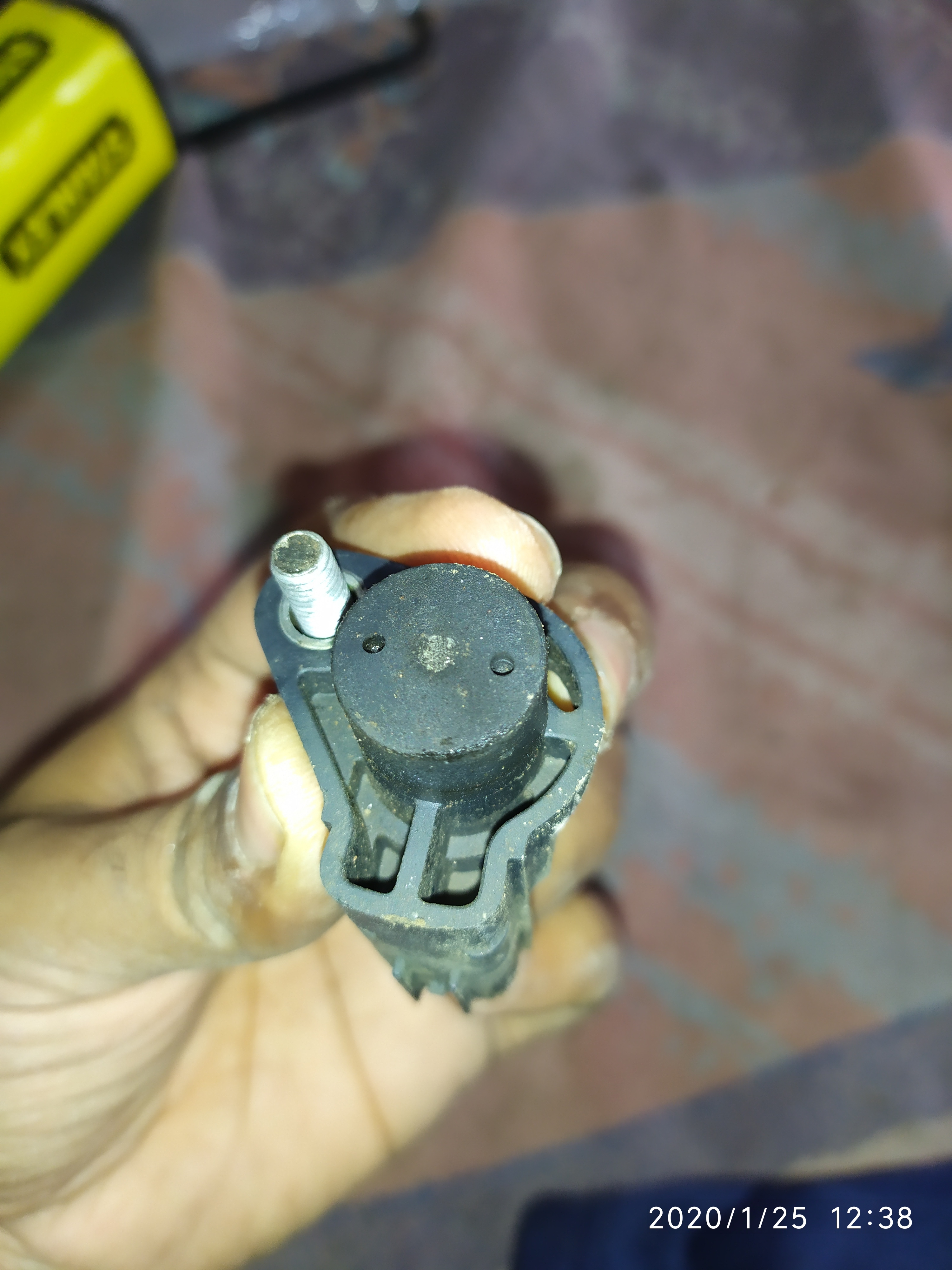

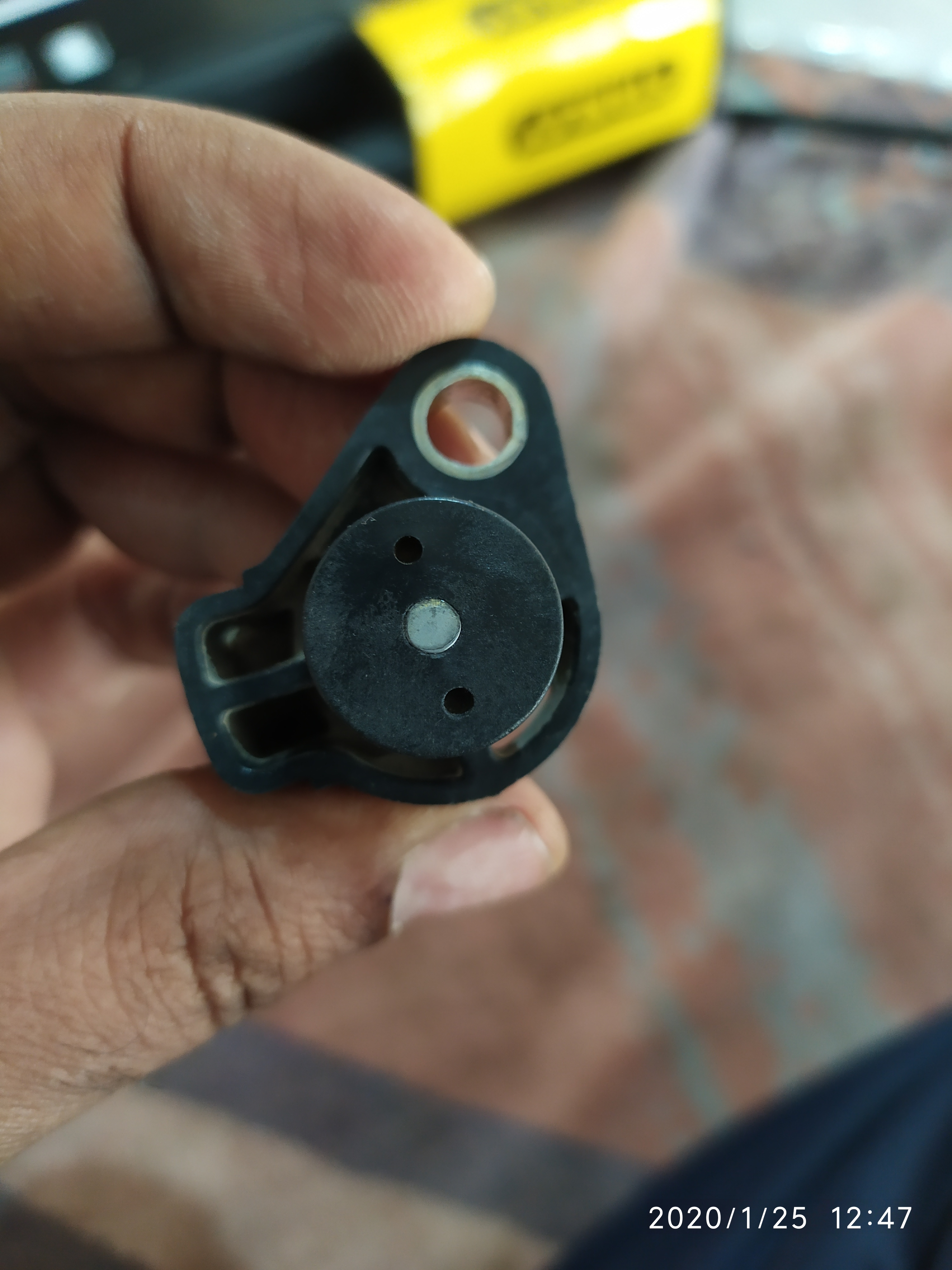

BEFORE AND AFTER CLEANING OF CAM SENSOR TODAY.RPMs were not stable.

Dear open IAVC also.idle RPM control by it if it stucks or dirty then RPMs disturb also
Also see throw out the flap if there is any gap in close position them RPM can't stable

Yes I have opened all and cleaned now rpm stable and running smoothly
