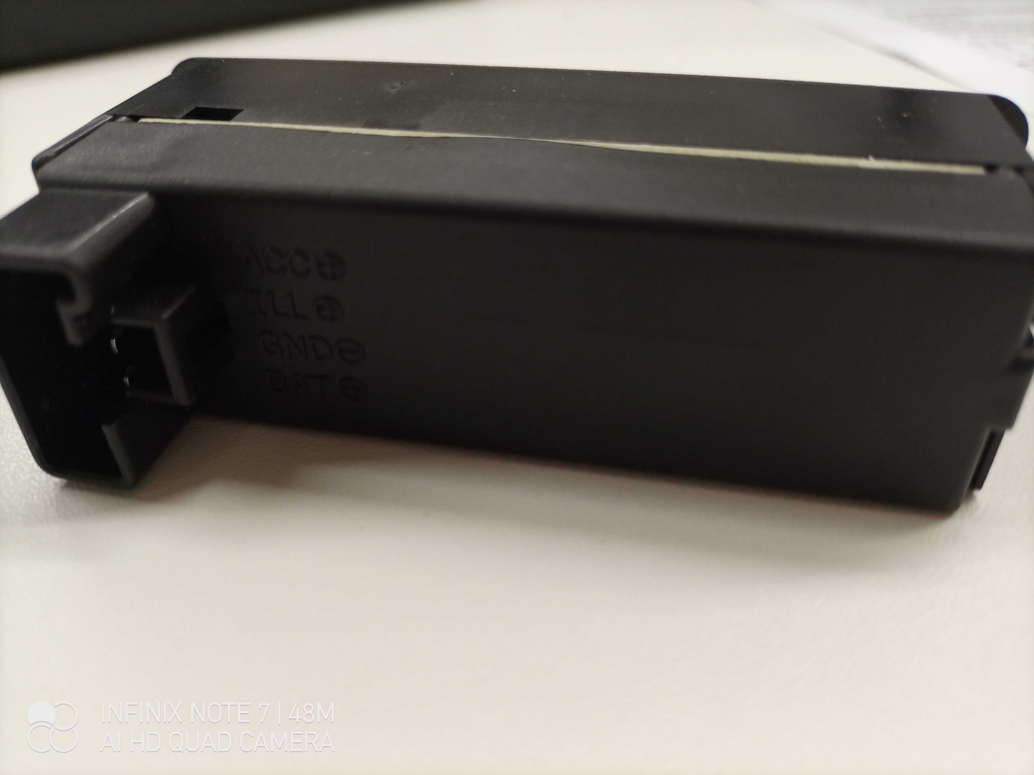

Is there a separate circuit for mirror retract in JXL, where it is located? I've shown mirrors to electrician he checked the wiring and told me that there is no retract box in the car, he checked retract current at switch level and it was available. He couldn't find circuit in car, I told him that I will find it's location. He says retractable mirrors don't work without that controller. Anyone knows about that controller? A member of Whatsapp group has simply installed a switch and installed 2 missing wires on both sides near mirrors below dashboard and it worked but he jas JXL which came with factory fitted power mirrors. Mine is JXR but wiring and grips are already there in dashboard and doors, so I doubt that controller must be there already, but where?
Difference between JXL and JXR mirrors wiring
JXL has grips at different points a. Grip behind main switch b. Grip near fuse box below dashboard near right door c. Grip near left door below dashboard
JXR has no grip, the wires coming from main switch is routed directly to both mirrors below dashboard through doors rubber pipes
