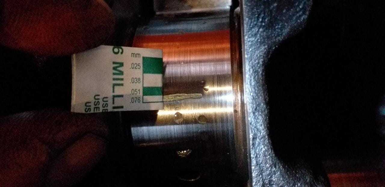

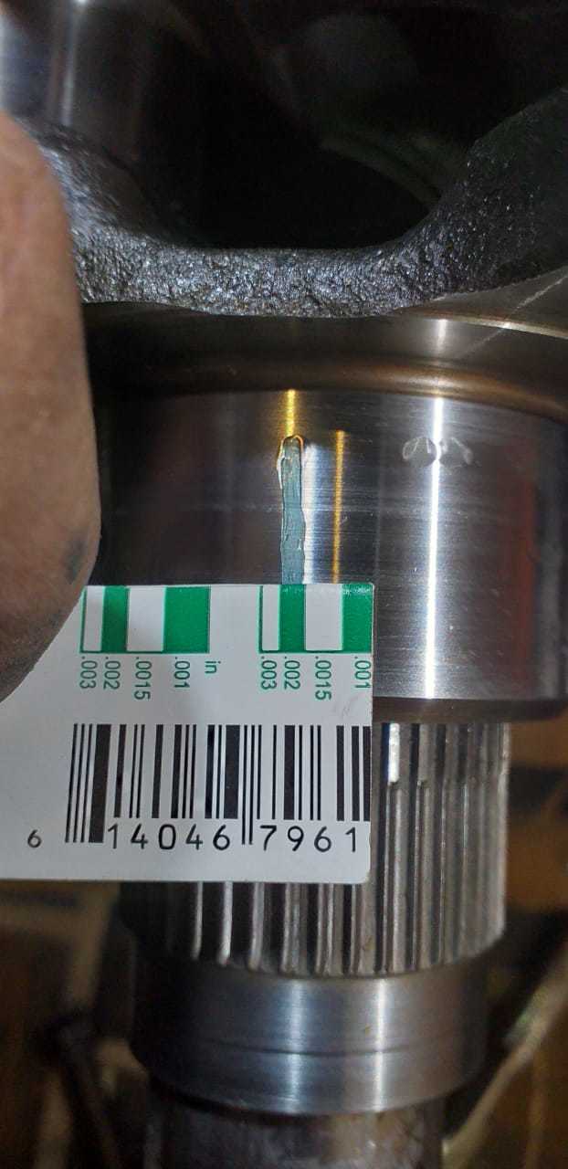

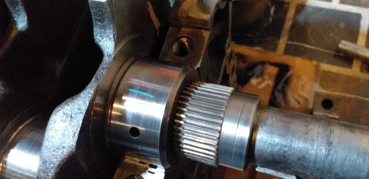

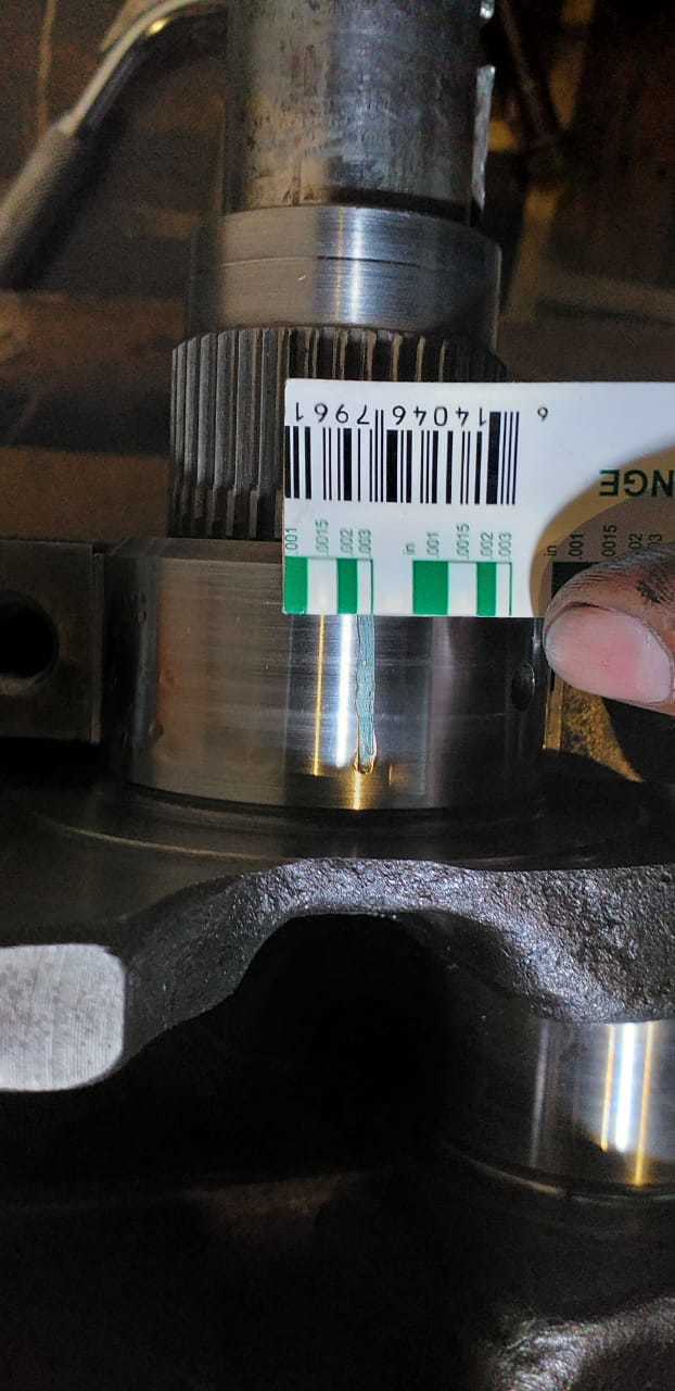

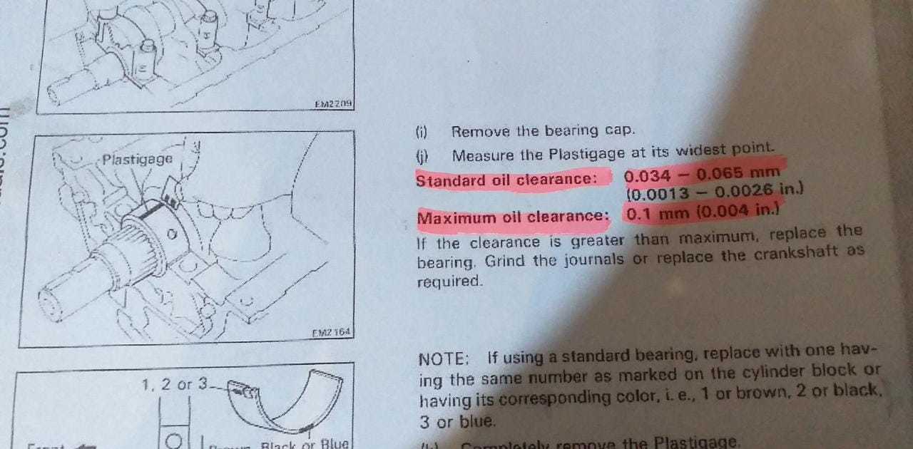

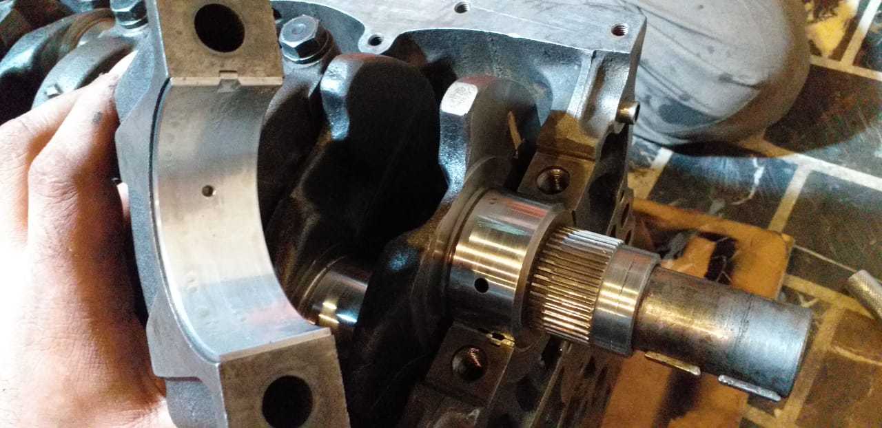

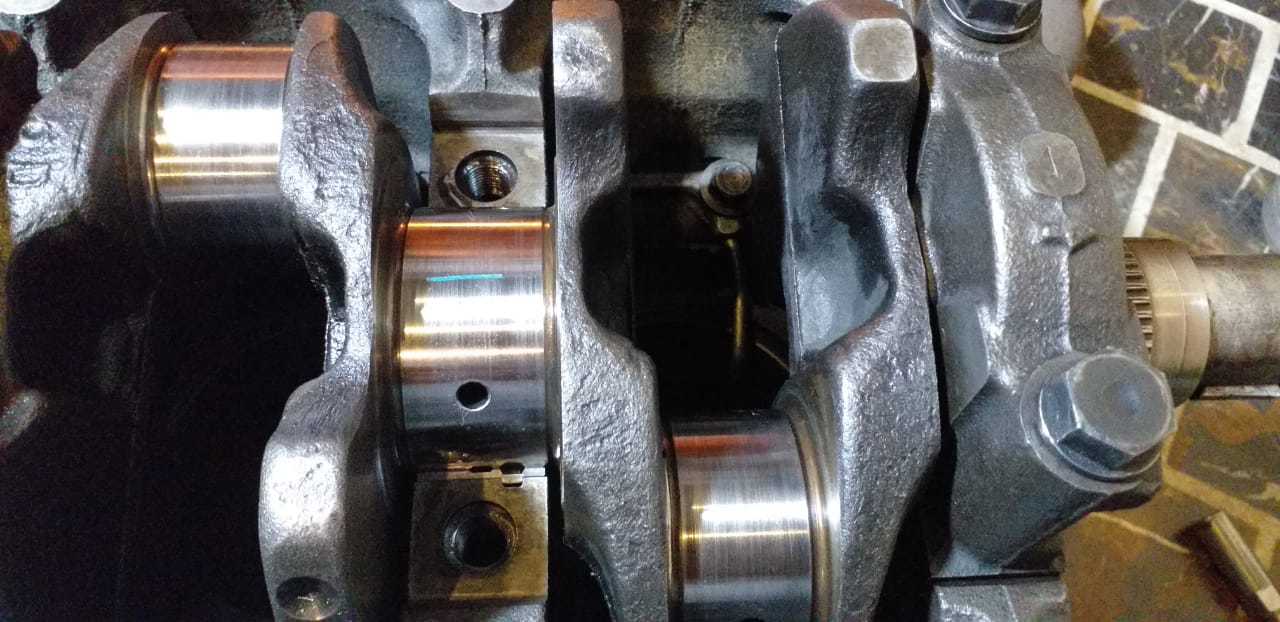

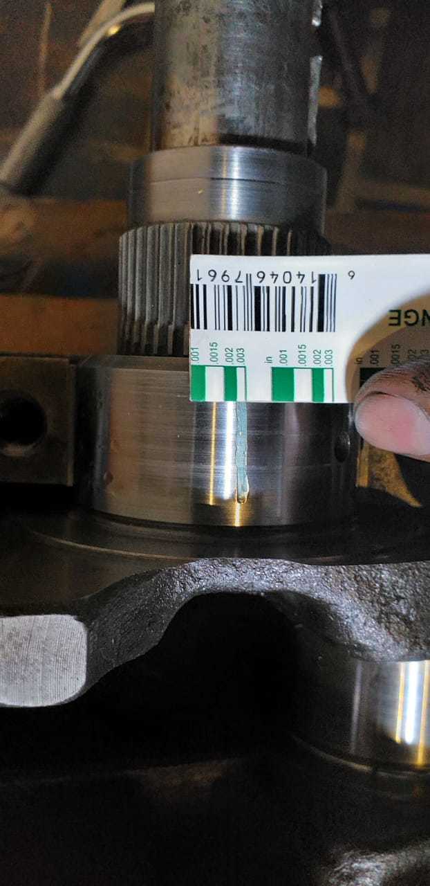

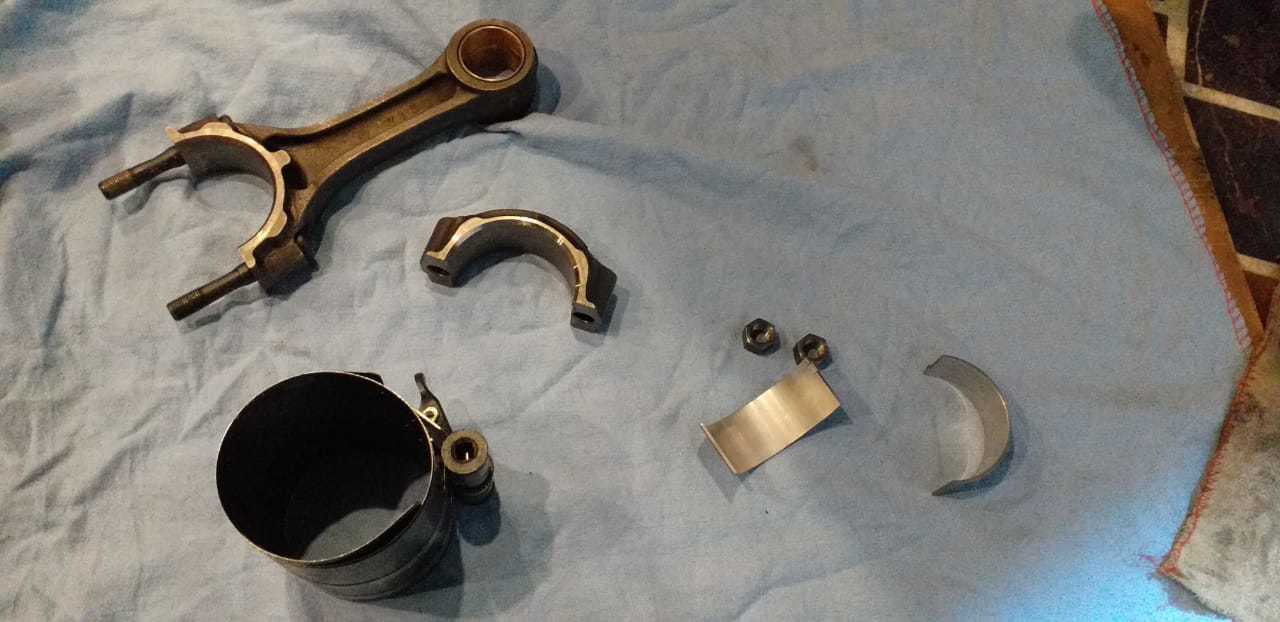

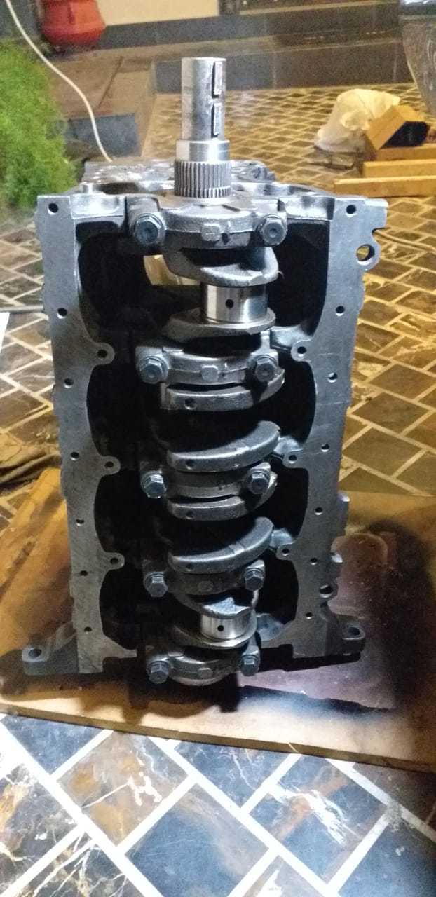

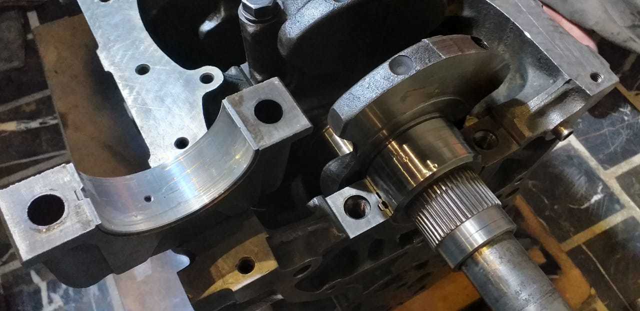

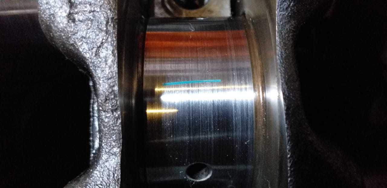

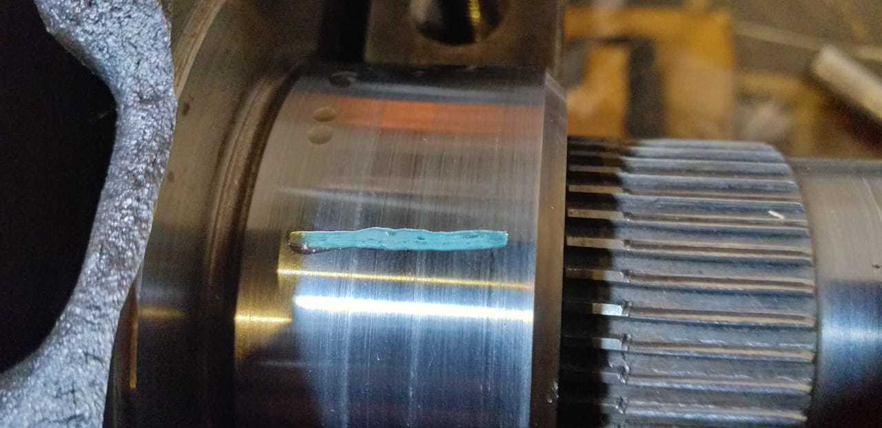

also measure the crank oil clearance with plastigage ,,,,,,, find it within specs but at the least corner ,,,,,,i havent grind the crank ,,,,,, just polished it and use the same size bearings i,e 0.25 ,,,,,, i havent grind it because of a reason ,,,,,,, machine shops here in isl/rwp have no idea about crank balancing ,,,,,,there work is also not as per my mark ,,,,,, my original plan was to take lahore ,,,,,, i know a guy who know how to handle all this ,,,,,,,, going there for this old engine was not a good option ,,,,,,,,and that guy charge atleast 4 times for his optimum work ,,,,,, he do have ability grind the crank 100% perfectly,,,, can also balance it later on along with the 4 sets of pistons/rods ,,,, can check the connecting rod bend tolerance,,,,,perfectly hone the cylinder walls ,,,,,,,, here they have absolutely no idea about all that ,,,,,,,,,
