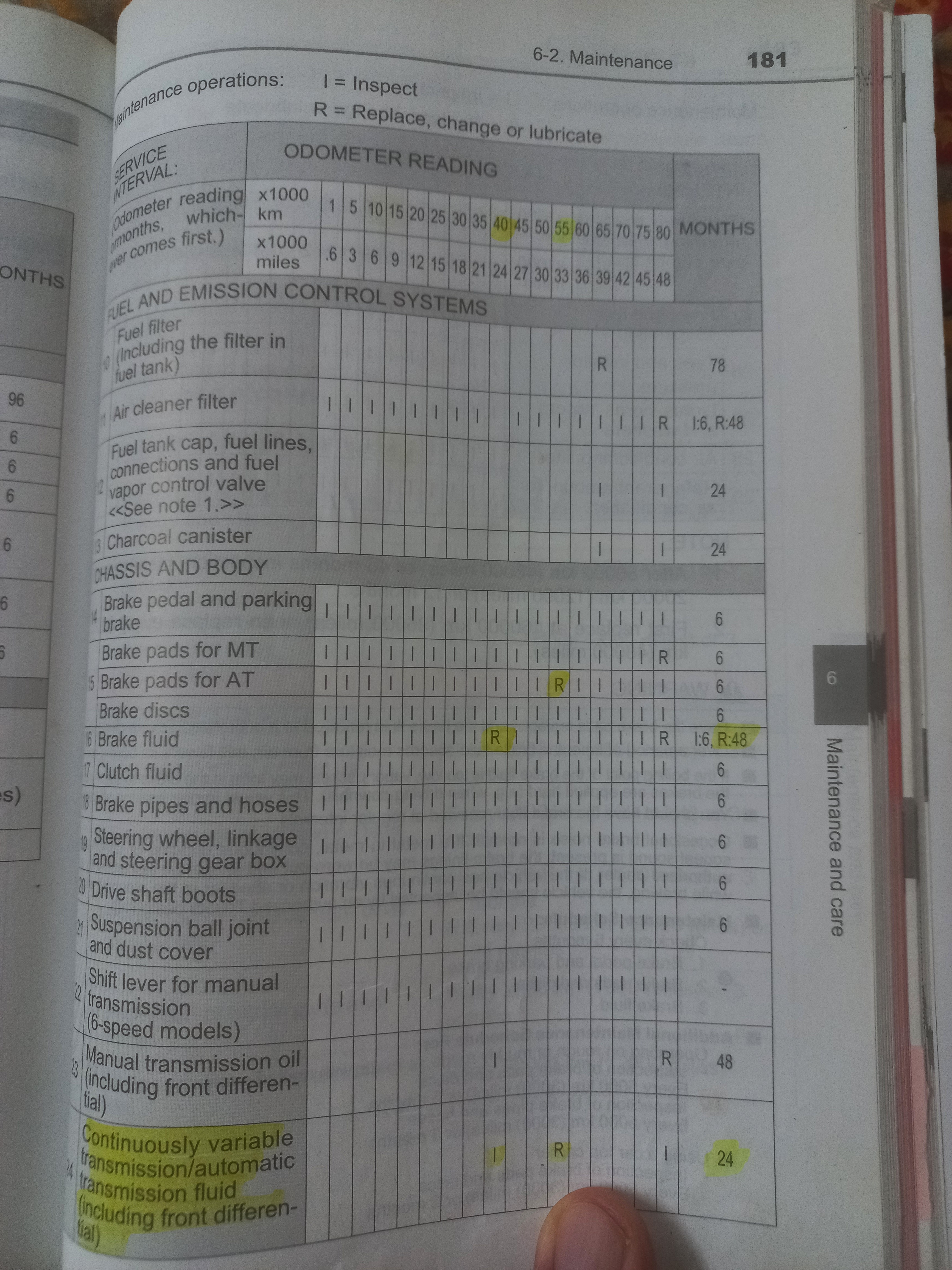

I bought a 2016 Corolla 1.8 two months ago with 105,000 km on the odometer. After the transfer, the previous owner moved abroad, and I forgot to ask when the CVT oil was last changed.
I contacted @bridgedoctorali personally , and discussed some queries I had in my mind about this post. To ensure there were no mistakes, I read the K313 Toyota manual thoroughly, as transmission failures are common in cars with neglected CVTs.

Added 1.1L more oil, as specified in the manual.
