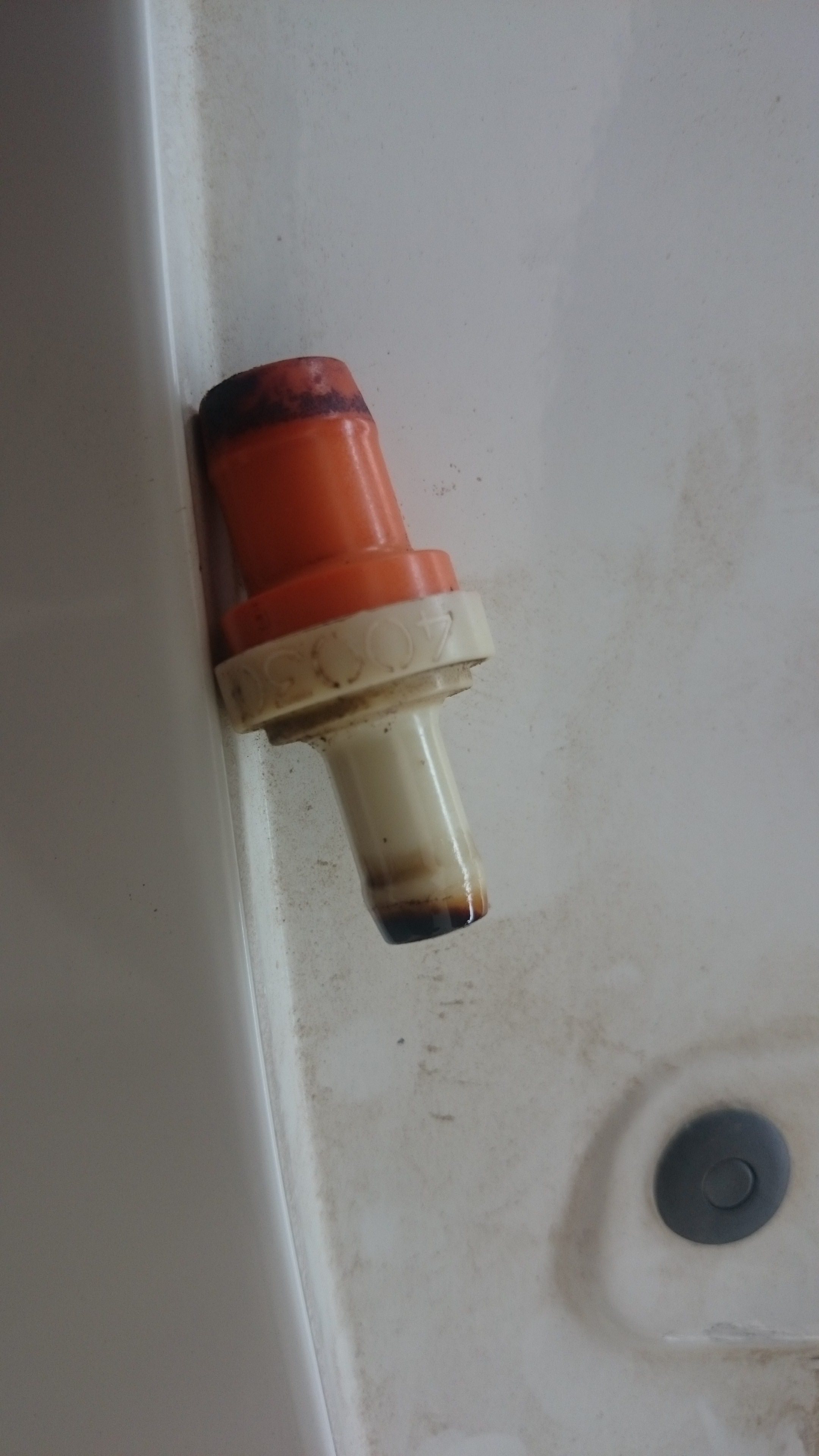

However, the car is giving blueish white smoke at around 5500+ rpm
Upon googling the matter and checking various forums, one of the simplest suggestions was to change
the pcv valve.
As you can see from the pictures, the valve was badly choked
I have never had any mechanic check this valve in 6 years of owning this vehicle though on other forums its recommended to change this often

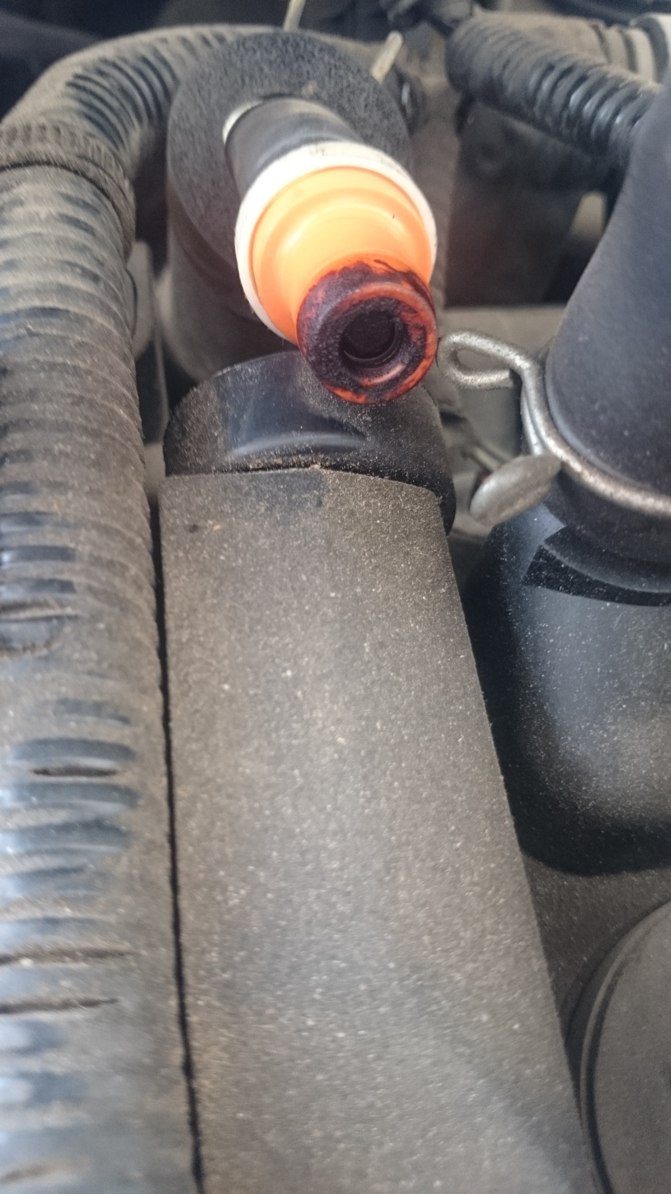

I couldnt find the valve at either local shops or toyota eastern .. so i installed a similar valve for suzki baleno
changing the valve probably halved the smoke and reduced the vibrations
but there is still smoke coming out
