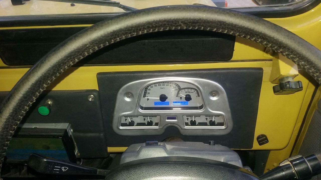

Speedometer: Dakota Digital speedometer imported from USA and installed.

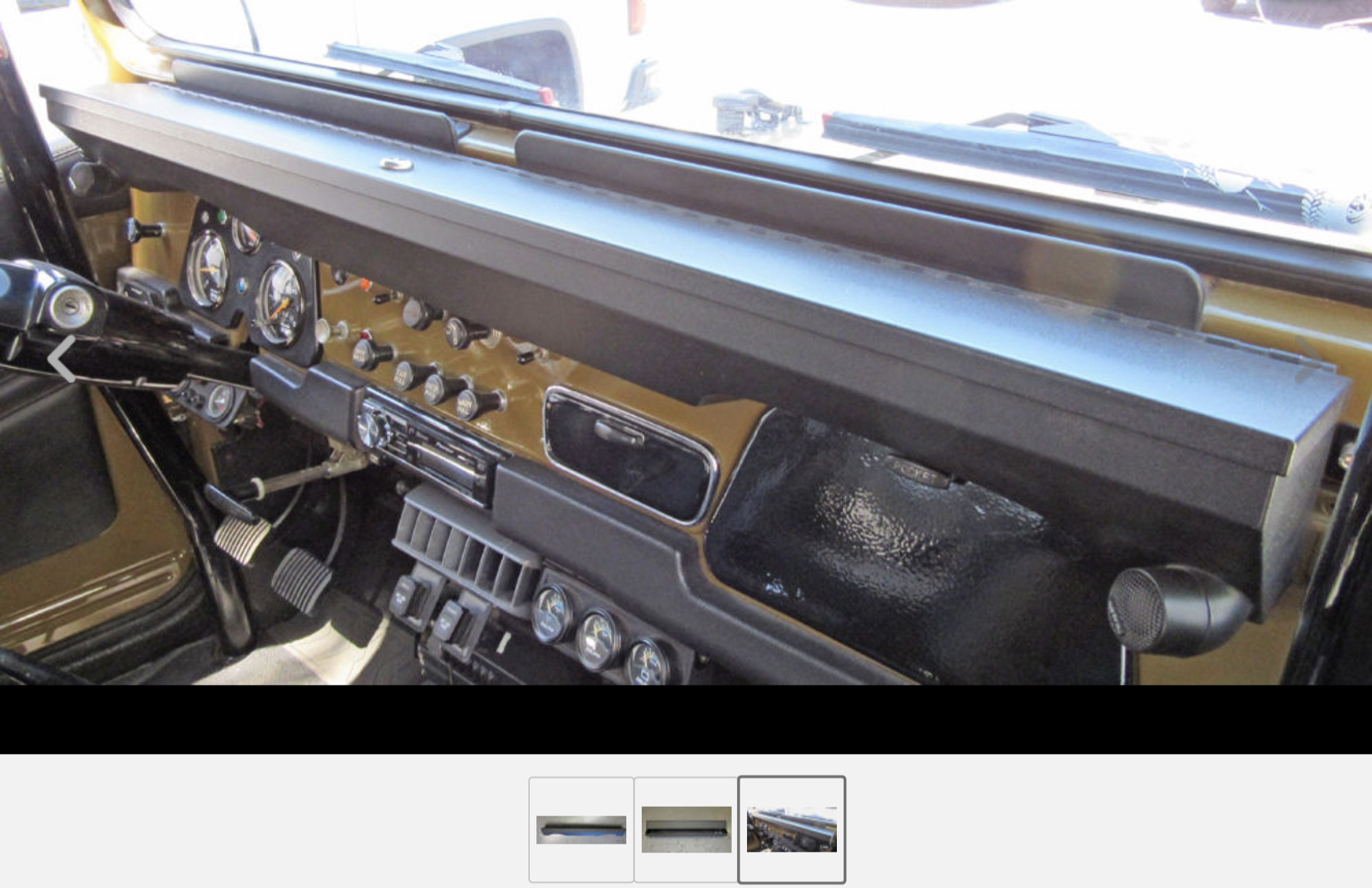

Visor storage Shelf made by CCOT USA imported and Installed
