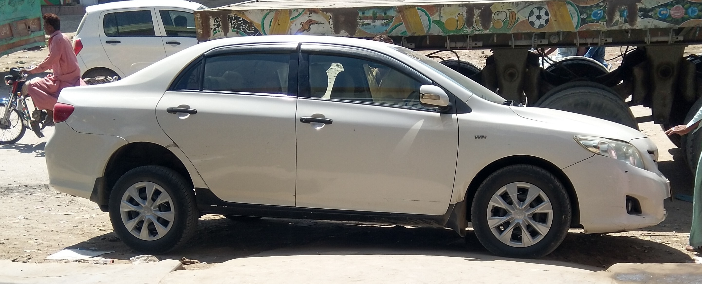

Today i purchase corolla xli 2009 and surprised tosee that here is no any stuff about that model...so i think here is need to make a separate topic for it.
My brother already have a corolla 2008-09

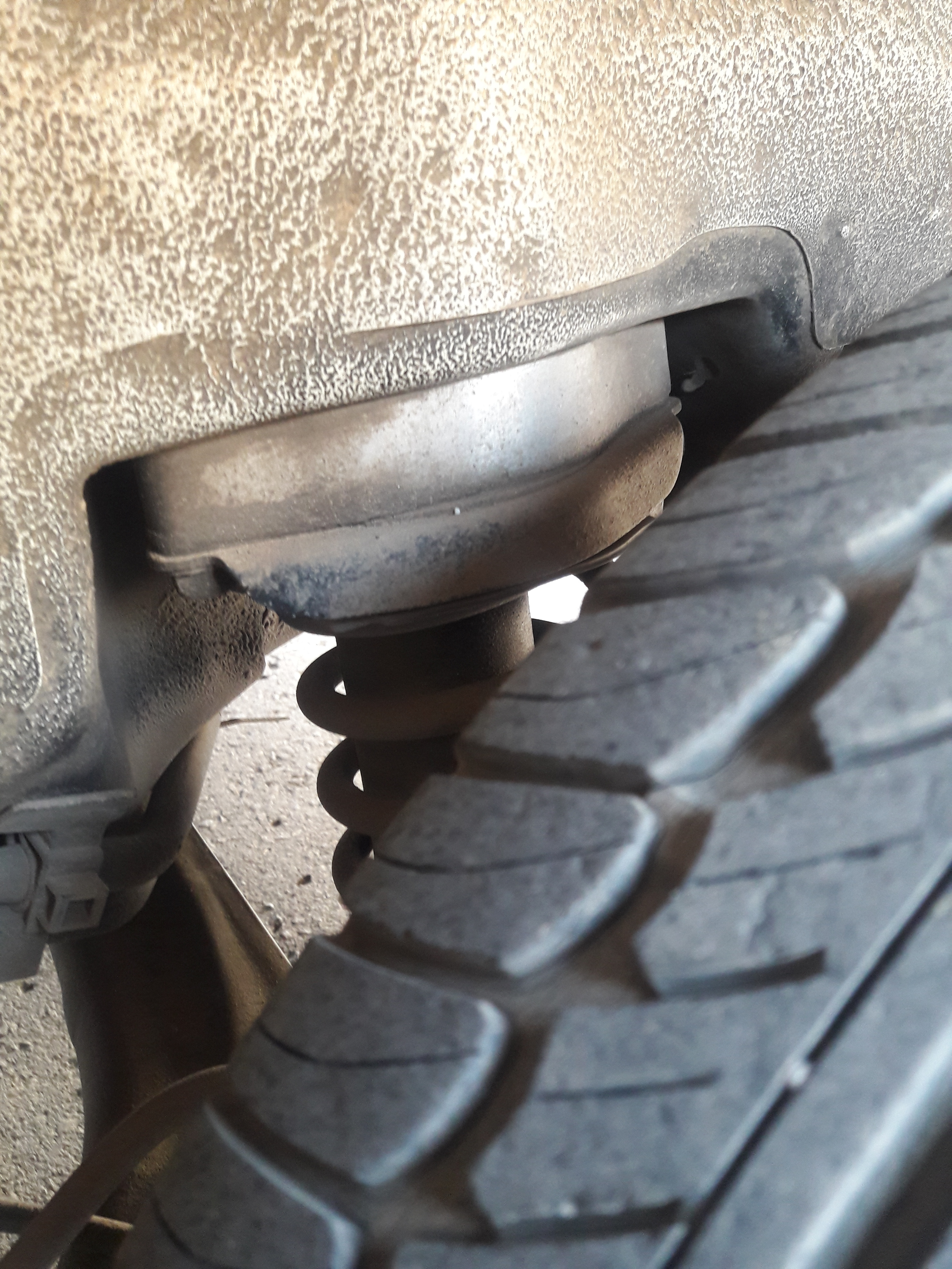

CNG installed but not in use since 2014. Thinking to remove cng cylinder. Is it safe to only remove cylinder only?

Yes. Of course safe.With it be sure that there is a extra "gutka" at the top of both rear coil springs for balance the extra weight of CNG cylinder. If so please remove that too with cylinder for balancing the car.

Yes u r right. I have seen that spacer too. Shall i remove it too?.
