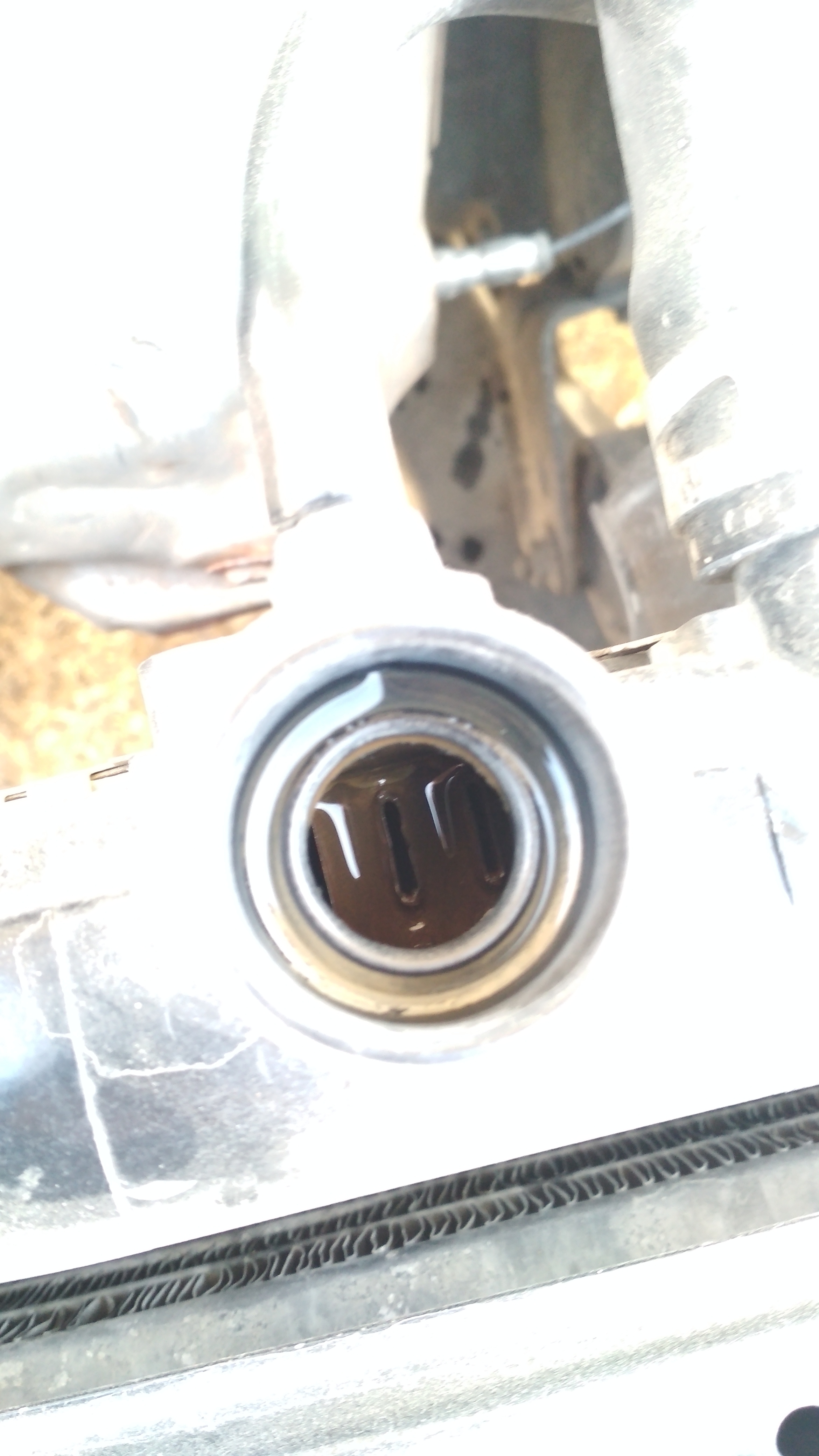

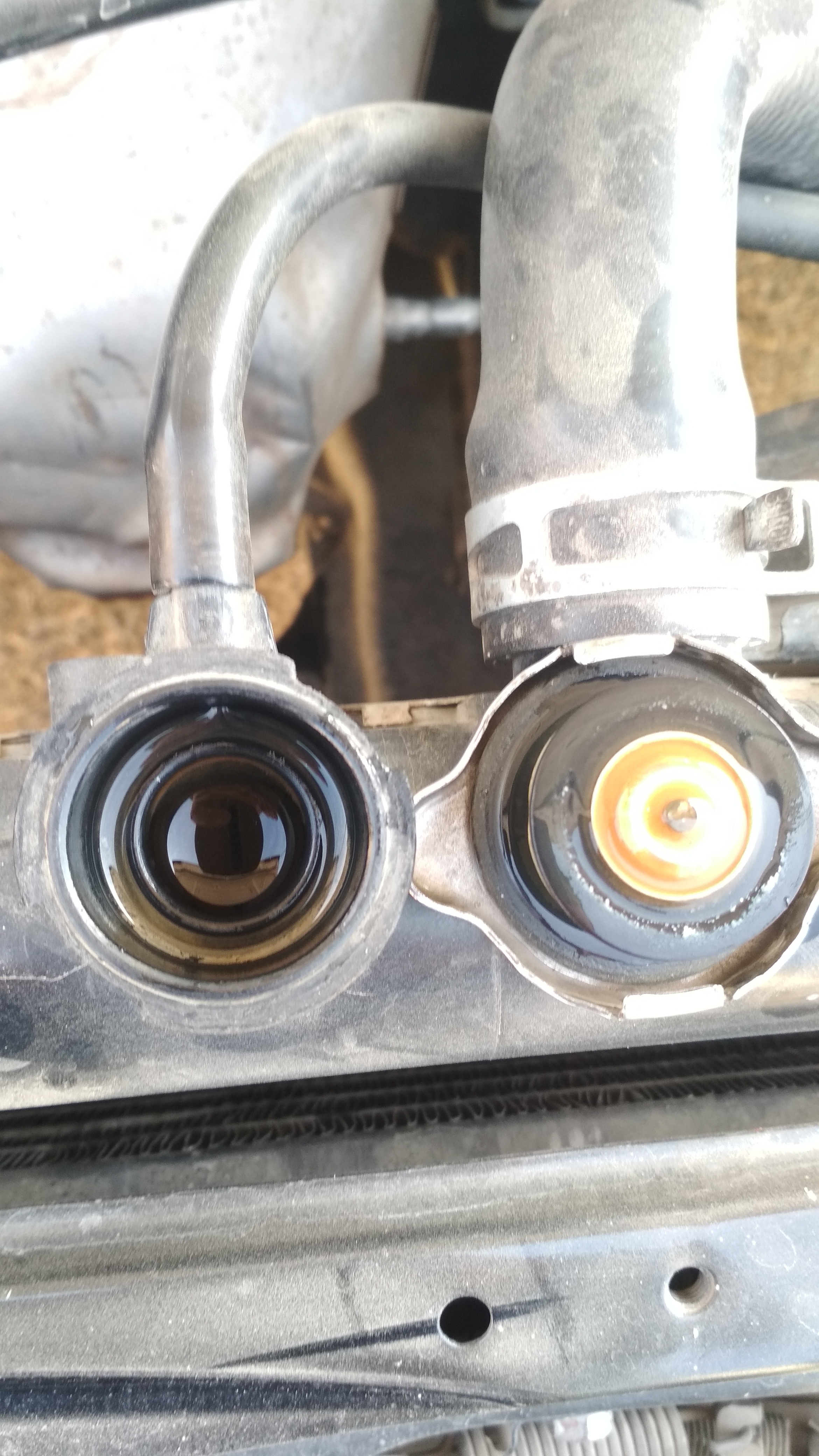

I had drain the radiator 2 times with water in December and put distilled water. It was running fine and was clean from any rust or dirt.
Here is the condition pic taken today.
Without water.

So put half litre coolant in empty bottle and added half litre distilled water in remaining coolant, mixed it up.
So packed every thing closed and also filled up the reservoir bottle.
Started the car and filled the remaining coolant.
Radiator + expansion bottle took total 4L.

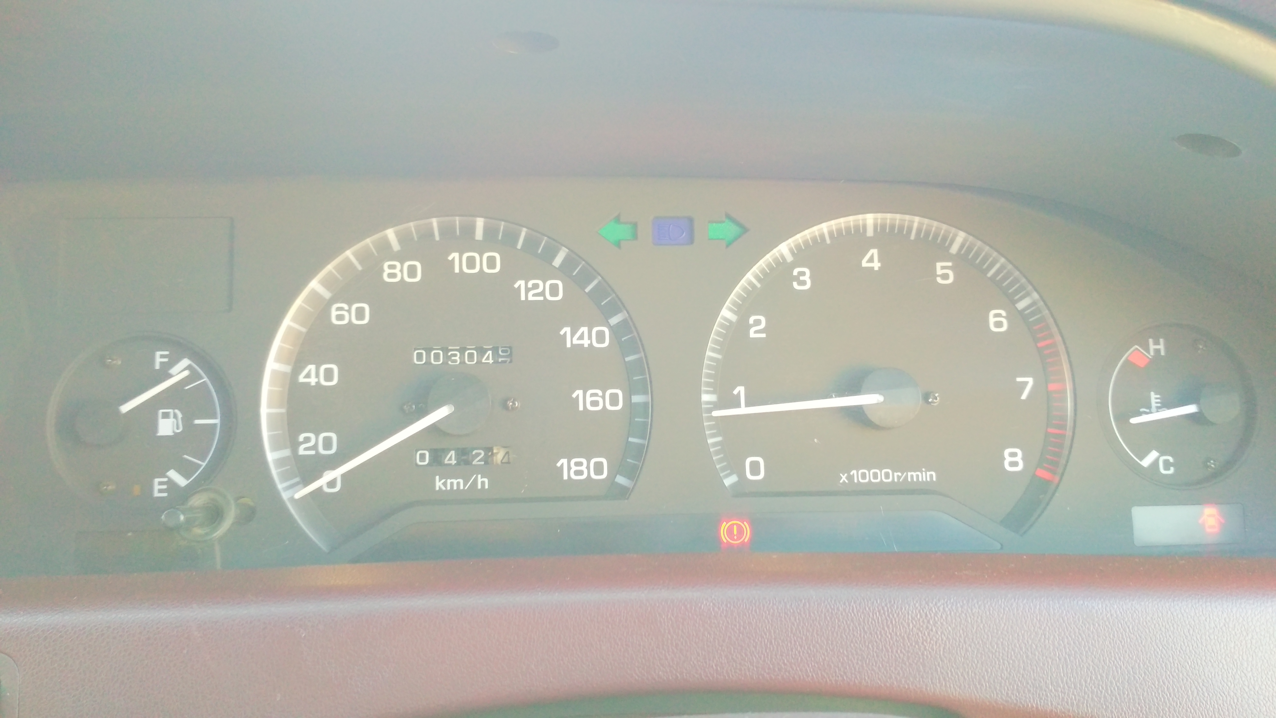

Took a test drive and everything seems fine. Ac is good, heater also working. Temperature needle in middle same as before. Hopefully radiator will be good and rust free for next 50000 km.
