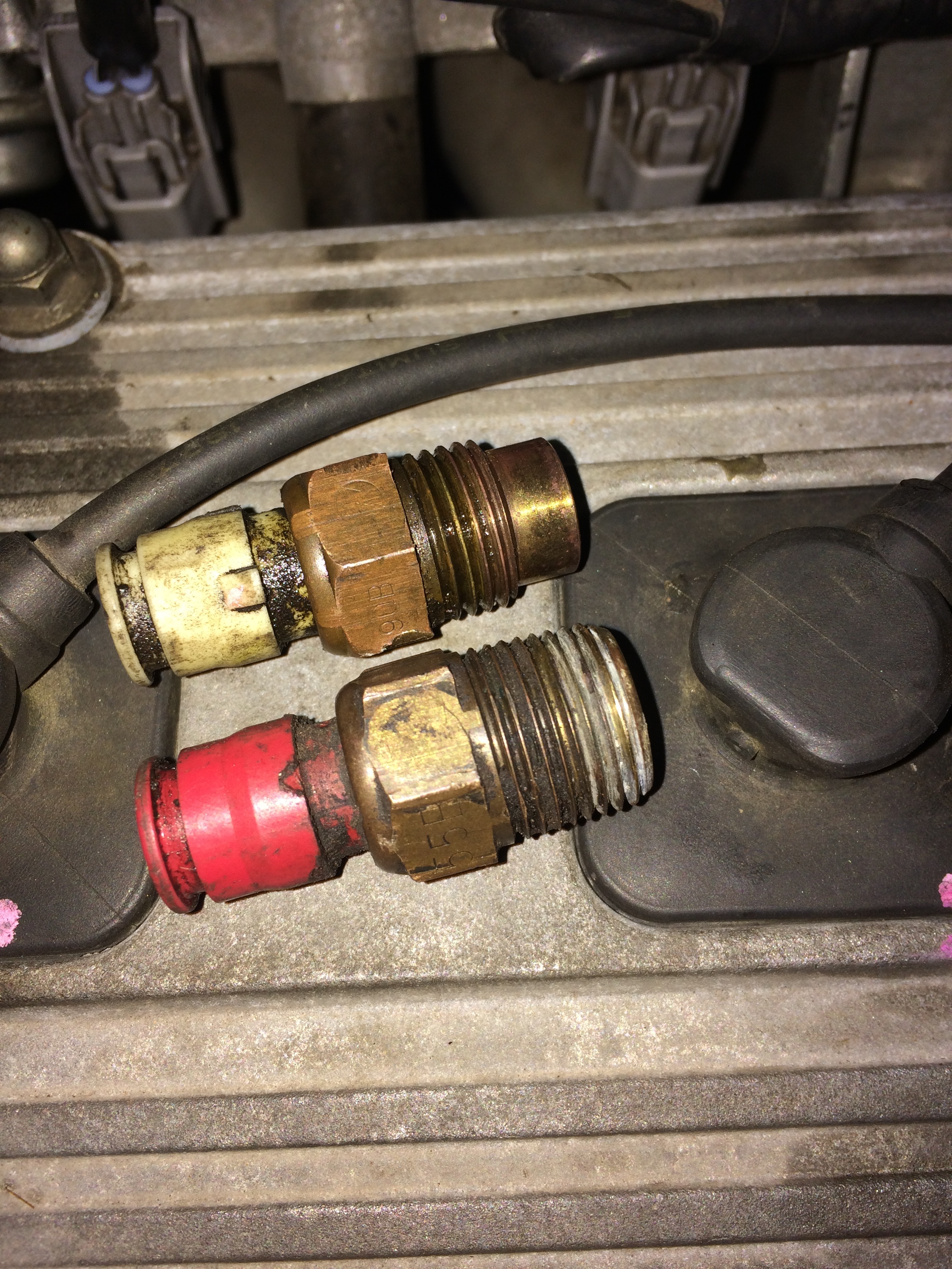

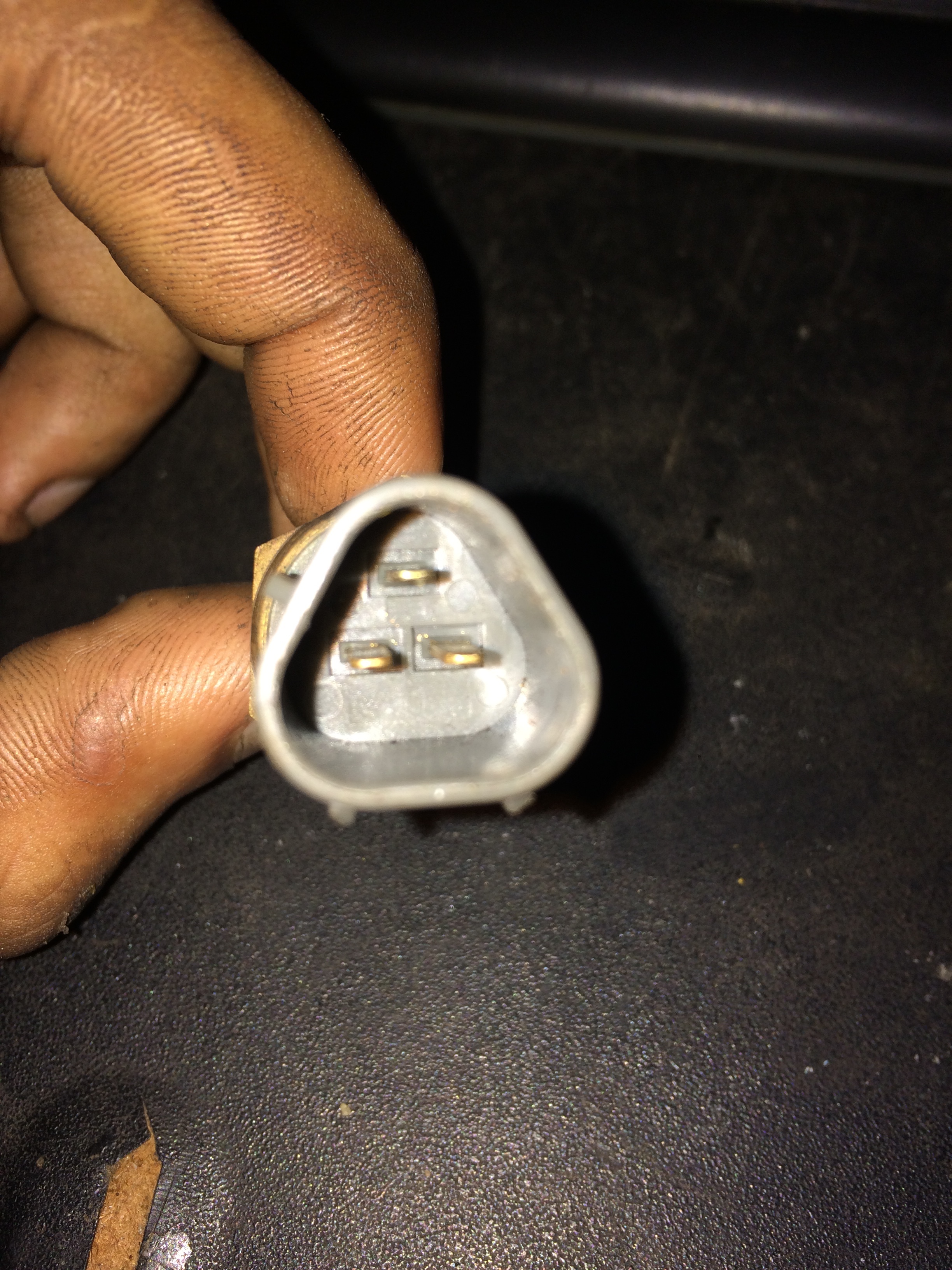

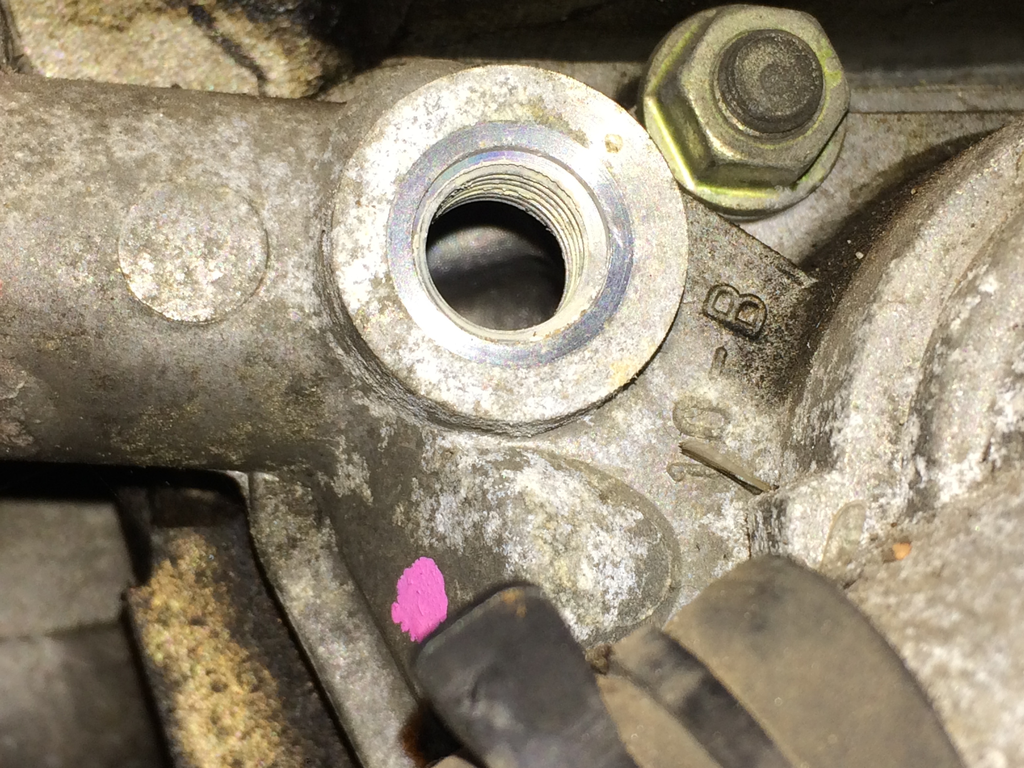

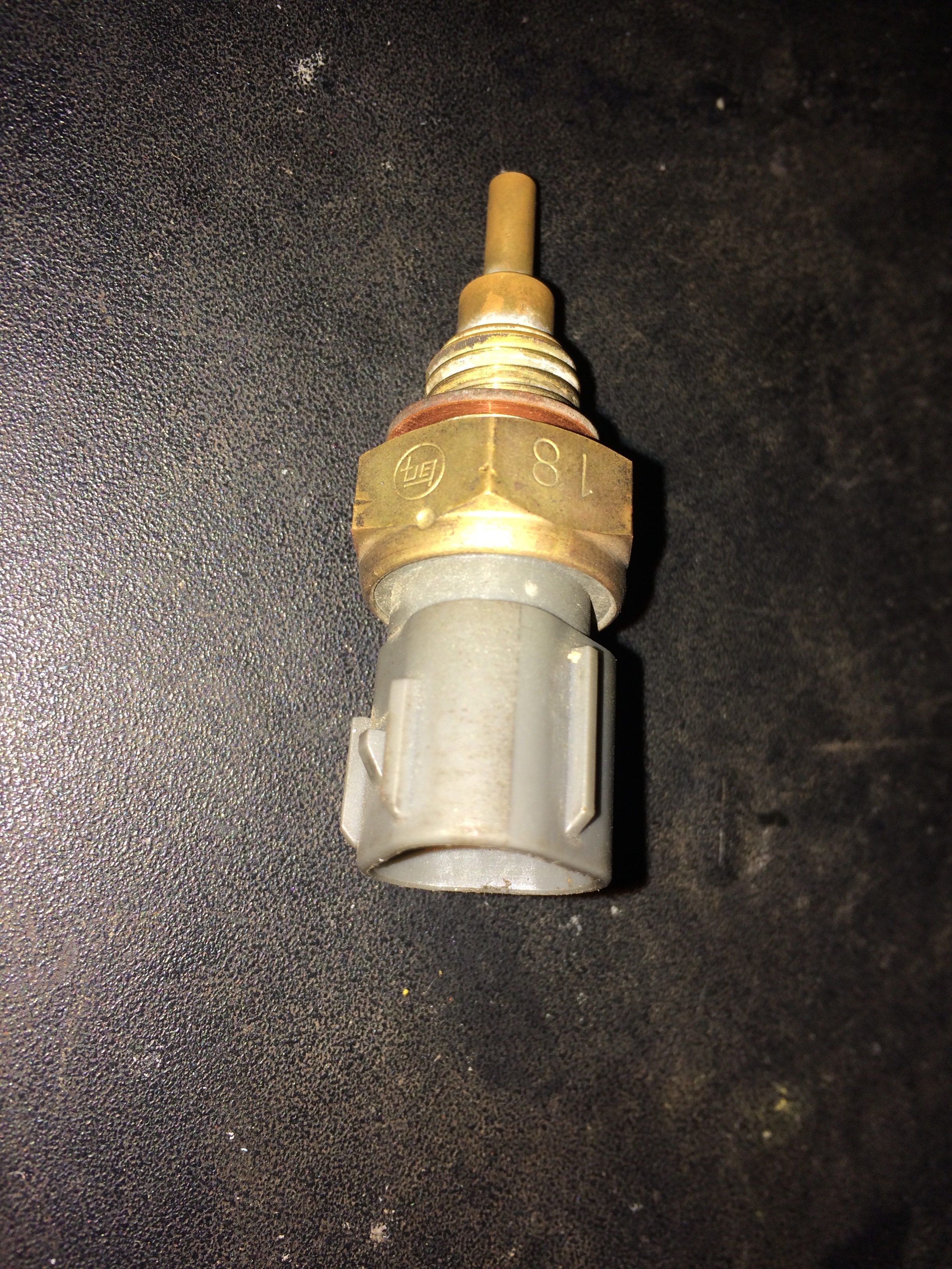

and bro how to wire up the coolant temp !! i have 3 pin socket near the thermostat and single pin connector from the back !!
Share the pic of the connectors
