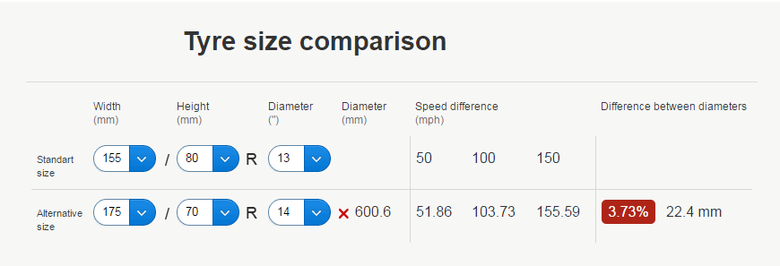

I am changing the rim and tyres of Passo 2011Current Size is 155 80 r13Replacing with 175 70 r14Please comment
Im also going to change them but why you are changing them with Rim size 14, !85/75/13 of yokohama(Ecos & A drive) is easily available in market. Increase in rim size will Decrease fuel effeciency of car as well as suspension as we all know passo has built in rattling issue.
Go for 185/65/14. This configuration has been tried and tested by many PakWheelers including me. Improves GC without compromising fuel economy and does not touch fenders.

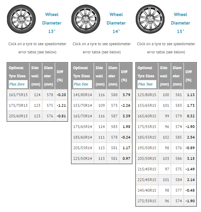

Just for information, you can use the following tyres in Passo:Calculation by taking 155/80/R13 as standardSource: http://www.tyresizecalculator.com/
Not recommended,
185/75/R13 also not recommended
Umar Tariq bhai then what is recommended
Recommended tyre sizes for Passo are
155 80 r13 and 165 70 r14
So i think there is not a big difference between 165 and 175
Dear,I have not personally experienced these tyre sizes, that are these good or bad. I am totally speaking with reference to what STANDARDS are. For recommended list of size, please see my post above.
