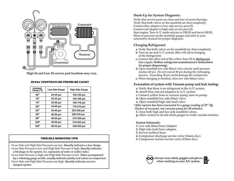

5. if the problem is only when using ac (very common in used JDM) than get the ac pressure checked, on a normal day i.e.40C outside temperature your ac pressures should be lower side = 30, higher side= 180. if your are getting something like 250 on higher side than your ac condenser or valve is choked causing the compressor to over work, get it checked -
Now this is something that I need to get checked. Any reliable ac mechanic that you would recommend ?
Although drop in pick is a new thing and could be because of the AC compressor choking, but fuel filter replacement was long due. I have been looking for one for so long but havent found yet.
