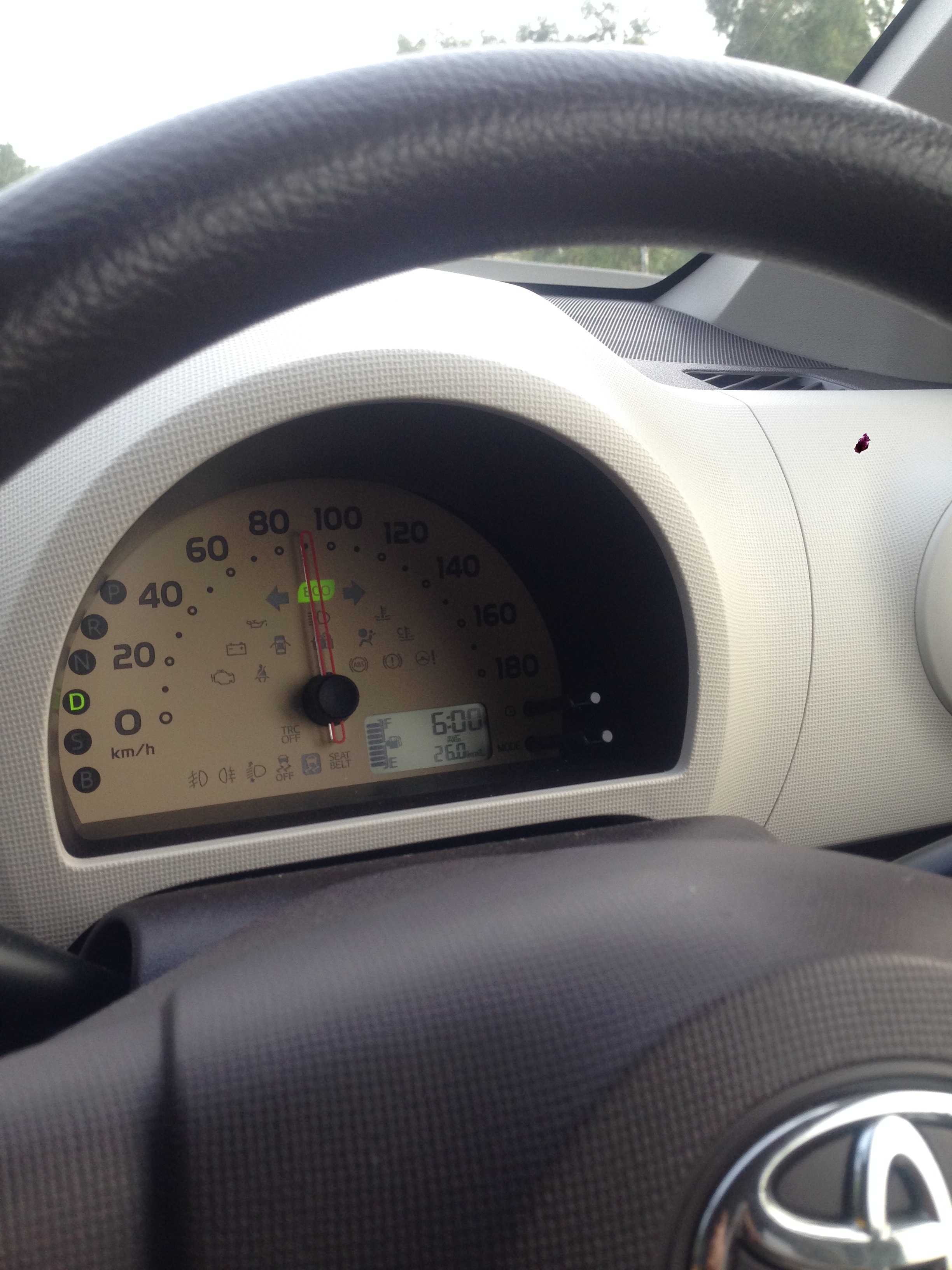

Amazing!
Great average brother. Have you ever rechecked average manually(calculations)?
Yes i've checked it and the difference is max +/- 1kmpl.
