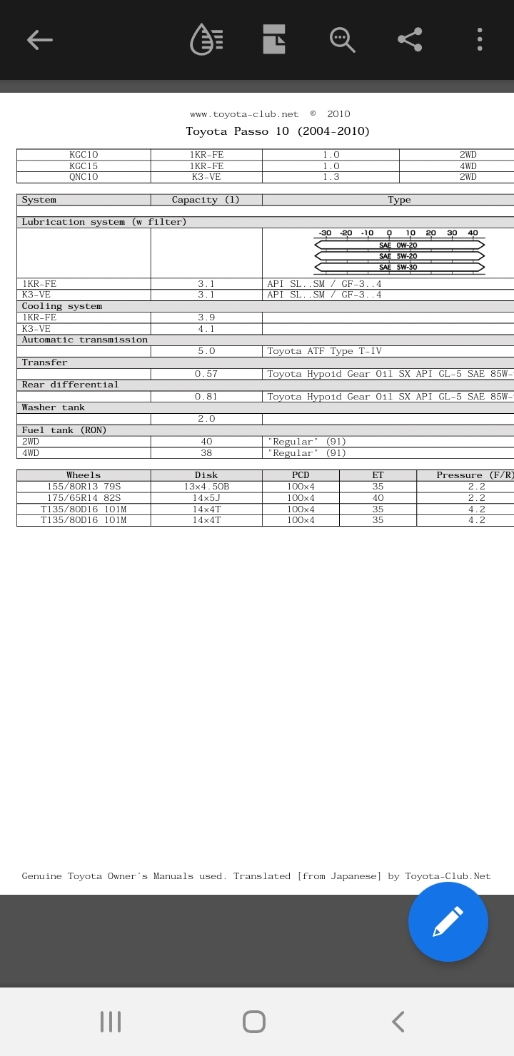

Passo 2004-2009 are non CVT....wit at transmission...atf t-IV oil and after 2009 onwards it's CVT needs CVT-tc or CVT-tf

Engine oil changed to zic 10w-40 now what about transmission oil and brake oil? please recommend me.thank you.
If your car is equipped with CVT, then Toyota Genuine CVTF-TC (or FE) would suffice, and if you are tight on budget, then you may also look for Caltex / Havoline CVTF, with details as follows:

What is the oem alloy wheel size of 2015 passo, can any one guide ?
Alloy wheel size is 15 regular steel wheels were 14 inches.

Alloy wheels and steel wheels both are 14" in 2015 model.
