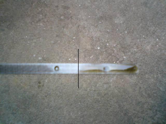

W.S. Dear Salman.
I have read your concerns, and can say that this much oil reduction is fine, and nothing to worry about IMO (in my opinion).
Simply top it up, and change engine oil + oil filter , only after it has clocked 5,000 Kms / 06 months, whichever comes 1st.
If on ZIC A 10w-40 fully synthetic, there was no oil consumption, or comparatively less oil consumption, and you were comfortable with it, then from next oil change, you can switch back to 10w-40, however, IMO, 10w-30 by Caltex / Havoline is also fine.
