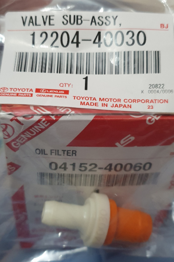

pcv se kafi fark para, parts central imported it for me from japan.that is the reason that now it is consuming less oil on 0w20 when compared to oil consumption on 20w50.

Agreed. PCV should be changed after some time on these engines but try to get the orig pcv valve by part number.

I have not measured it in ml but previously with clogged pcv and 20w50 and then 5w30 it used to drop very fast on the dip stick. you can say bari tezi se level girta tha and I used to change on 3000 or max 4000 now after pcv and on 0w20 I buy 4 litres can and pour in 3.1 litres and then use the 0.9 litres for top up and stretch it to 5000 Alhumdolellah
This is the thing I got. Sharing it for you so that u can have an idea and also note the part number
