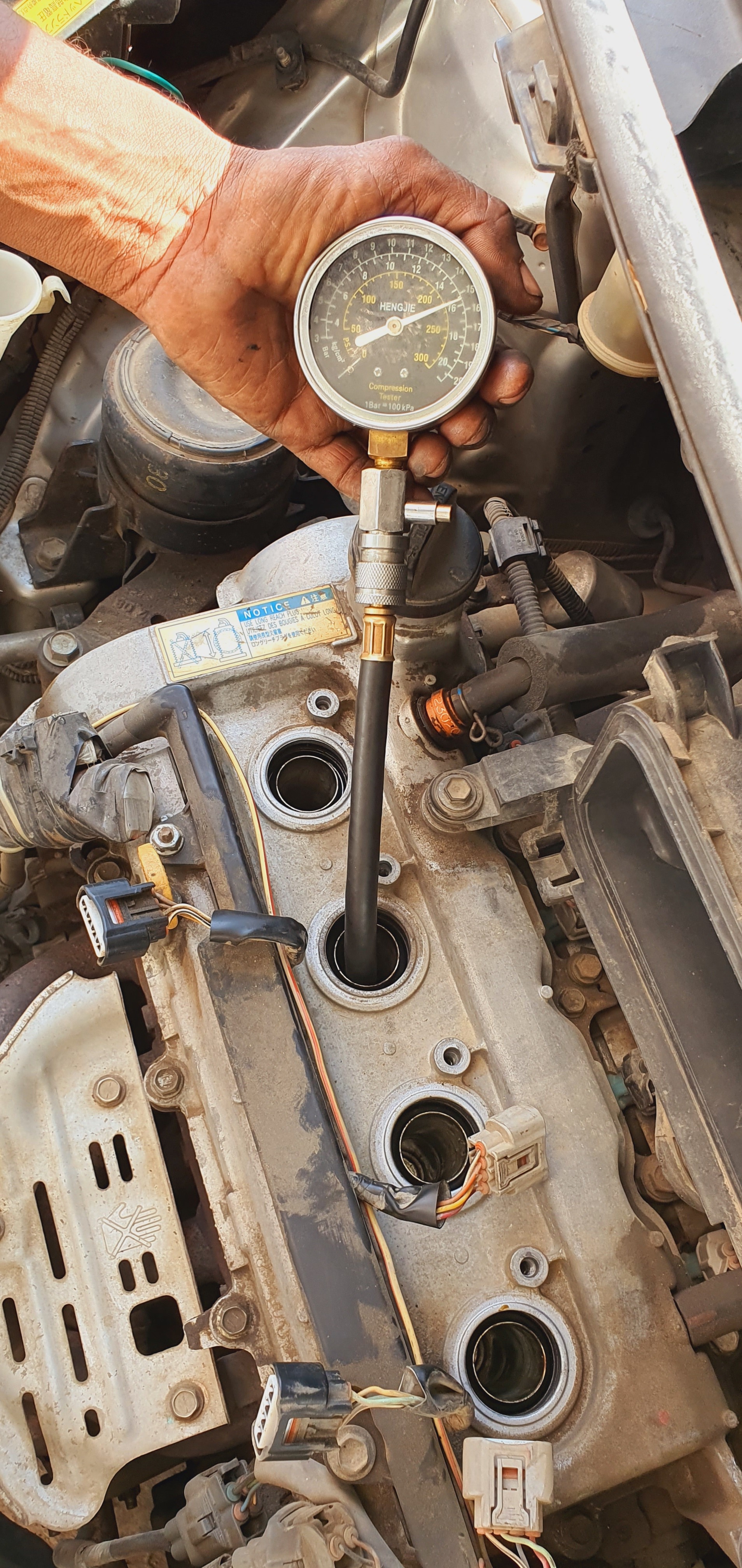

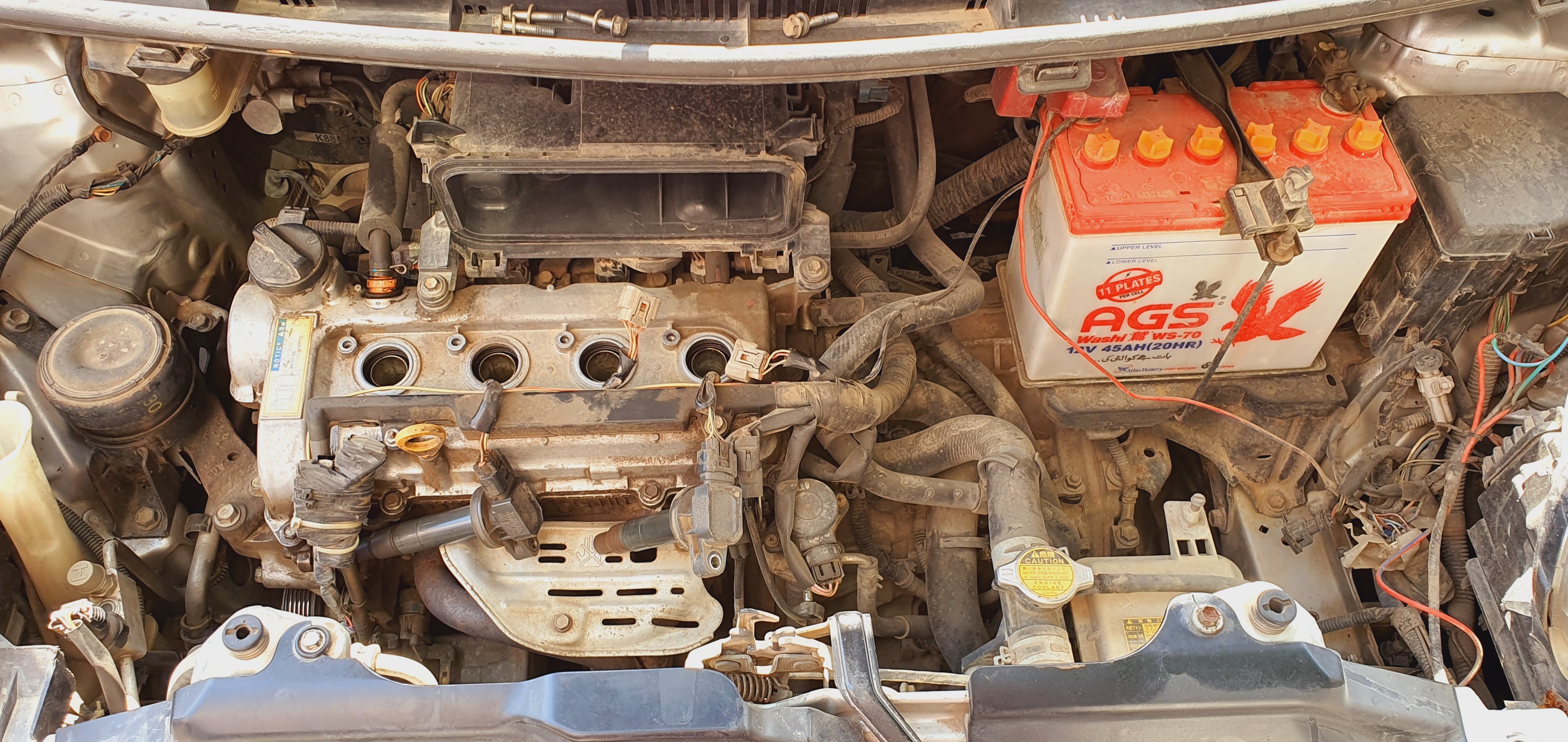

Dear Pakwheelers,
I bought 2007 Toyota Ractis from my brother in 2019. I need your expertise to help me diagnose acceleration issue in my car. Its SCP100 with 1300cc 2SZ-FE and CVT transmission, has done 230,000kms. I am third owner, 1st and 2nd owner are within family so I know it has been maintained well. In a straight line it can't keep up with mehran/Alto 660cc. Top speed is 140km/h. When the pedal is floored, engine runs at high rpm instantly but speedo raises very slowly. Fuel average in city is 13km/l and highway is 16km/l so can't complain(without AC). Tires are 195/65R15(factory size is 175/60R16), catalytic converter, throttle body and VVTi system, all air and fuel sensors are serviced(read Ghusul-e-mayyiat) by desi mechanics, plugs filters are replaced on time. I use Shell HX6 10w-40 which is changed at 3000kms. Engine oil is reduced to 2litres from 3.5litre after every 3000kms. No oil leaks on floor even though bottom of engine is oily. I am tired to dumping money in the name of service and maintenance when performance is not getting better at all. Only reason of keeping this car is comfortable drive. I will be visiting a mechanic suggested by @capsat tomorrow and will keep you guys updated with the tests/solutions for fixing the power-loss issue in my car.
