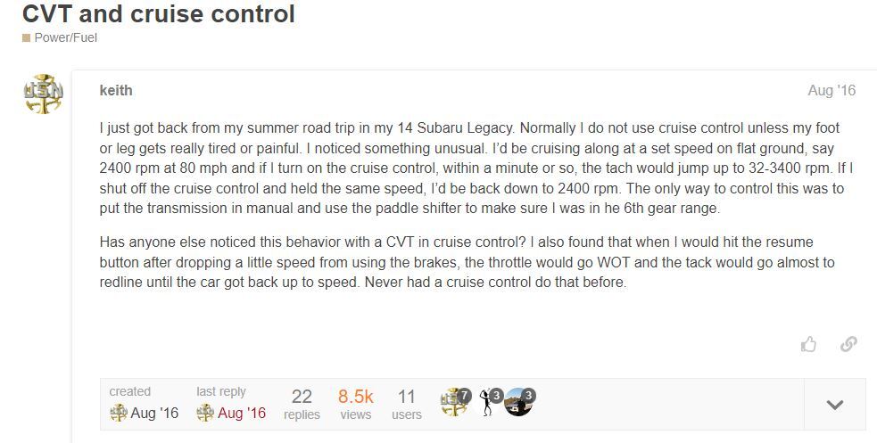

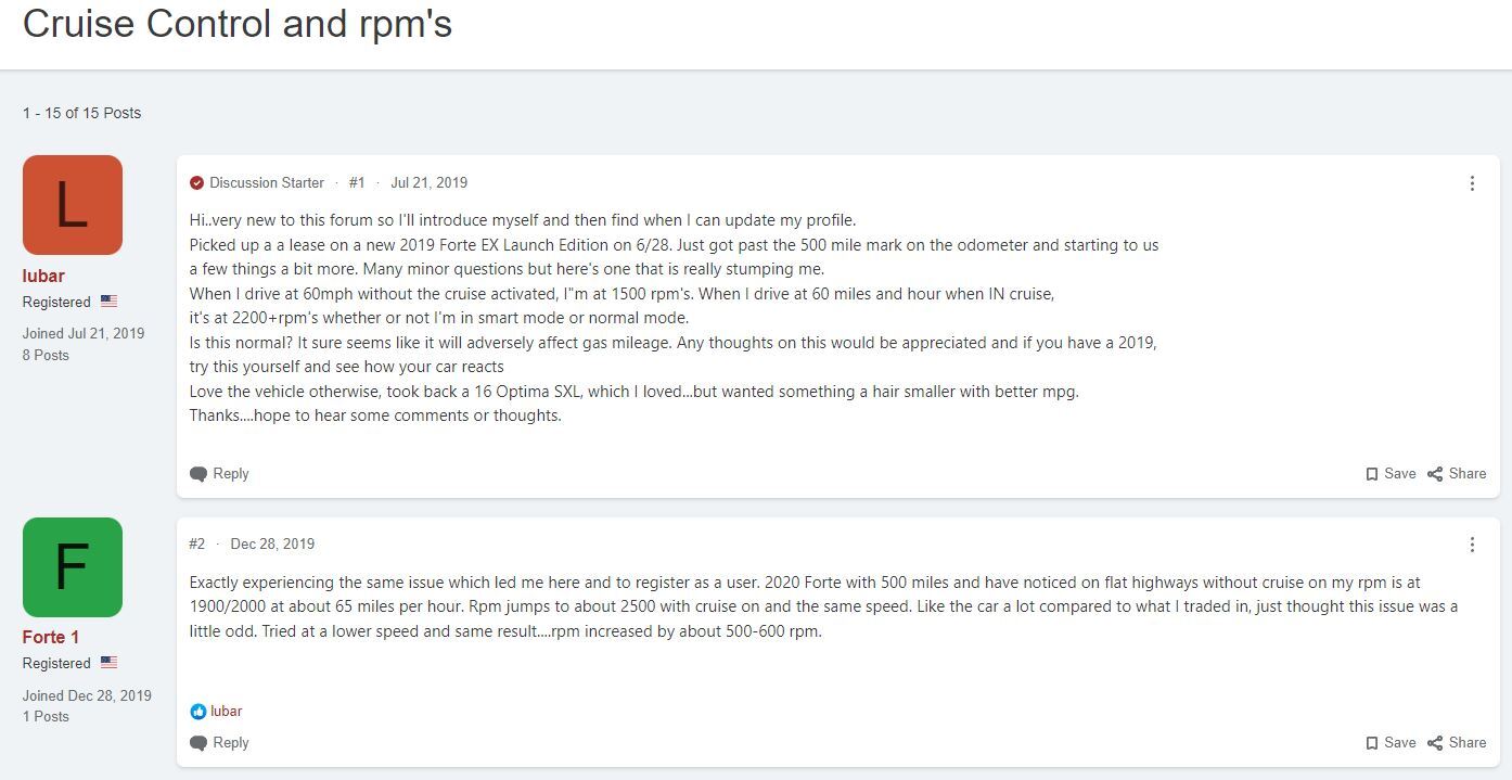

Yaris increases the RPM whenever (aftermarket) cruise is engaged no matter what is the road condition. Other Factory Fitted cruise control cars dont do it on same road.
