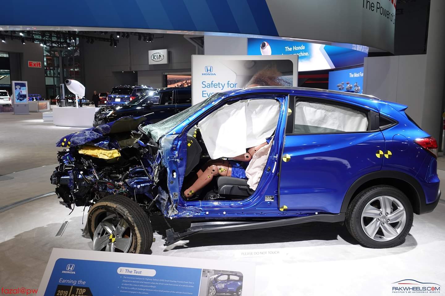

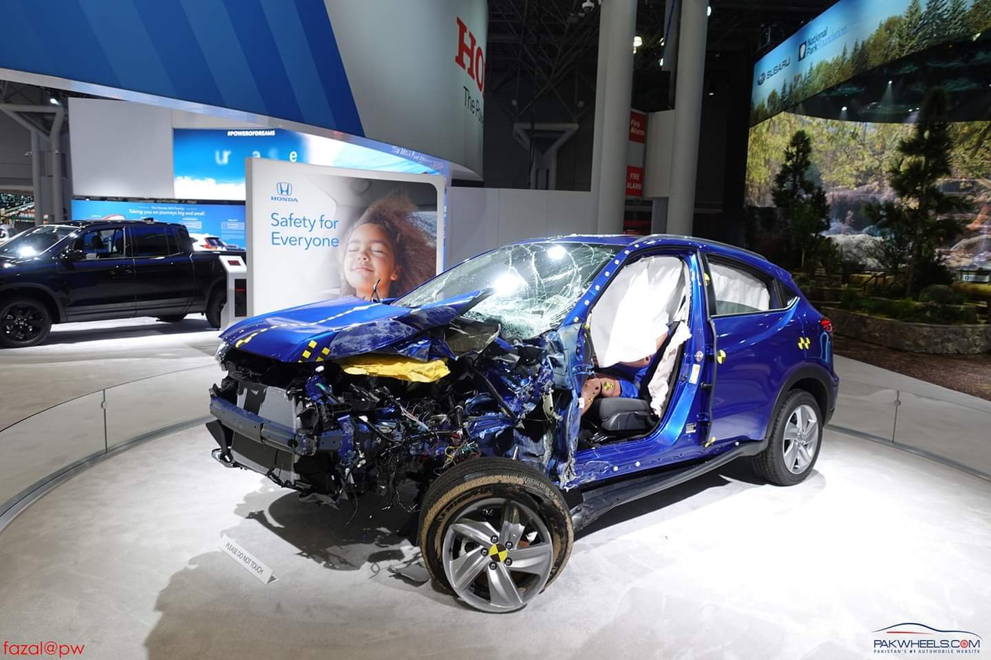

I was at an auto show last year and came across a display and will share pictures for readers. Normally you dont see a crashed car on an auto show BUT this was one of the most important visual. An actual vehicle crash tested was displayed. It's completely disaster looking at it BUT the vehicle is placed into the highest ranking for one of the safest vehicle in its class. I will include the frontal crash test from IIHS for reference.
Stronger the structure, safer the car is a very common misconception as far as car designs. Normally after crash we make an opinion that how much damage the body of a vehicle got and make an assumption about its safety, but it's not the entire reality. Over last 15 to 20 years the car design has seen a very advanced research and development and the idea is to make car safer for the occupants in case of car crash. The priority is to keep occupants safer rather keeping body of the car safe. There is a lot more physics and metallurgy involved so we can't dive deep into that because we all don’t like physics.
Introduction of newer car frame design in shape of crash absorbing or crumple zones as we call it , use of high strength steel for occupants compartment at key locations along with safety features like seat belts, air bags have made today's cars more safer. Crumple zones at front and rear of the car are provided so that in case of a crash the forces don’t travel directly into the cabin rather are absorbed as much as possible in the shortest possible area which is the front end, from bumper till A pillar and from bumper till C pillar in case of rear end. Take it like throwing a brick on your foot with a pillow in between.
Again its highly advanced science and we can’t discuss here in a Facebook post but in simple words, stopping the forces as away from occupants as possible is the main idea. Obviously as driver we all should know that these safety feature dont give us license to drive crazy and careless.
The implementation of the design from the software to hardware of this science matters a lot as well. Means how well all the parts are welded and connected. An improper weld or bolt can ruin the safety and here comes the quality control. After all these design and implementation in shape of a product and which is a vehicle in our case, comes the testing and that is crash testing. Engineers and researches have a set standard and the vehicles are tested in that test and then evaluated. After the test data from dozens of highly sophisticated sensors is checked and the visual inspection is made for every inch of the vehicle.
