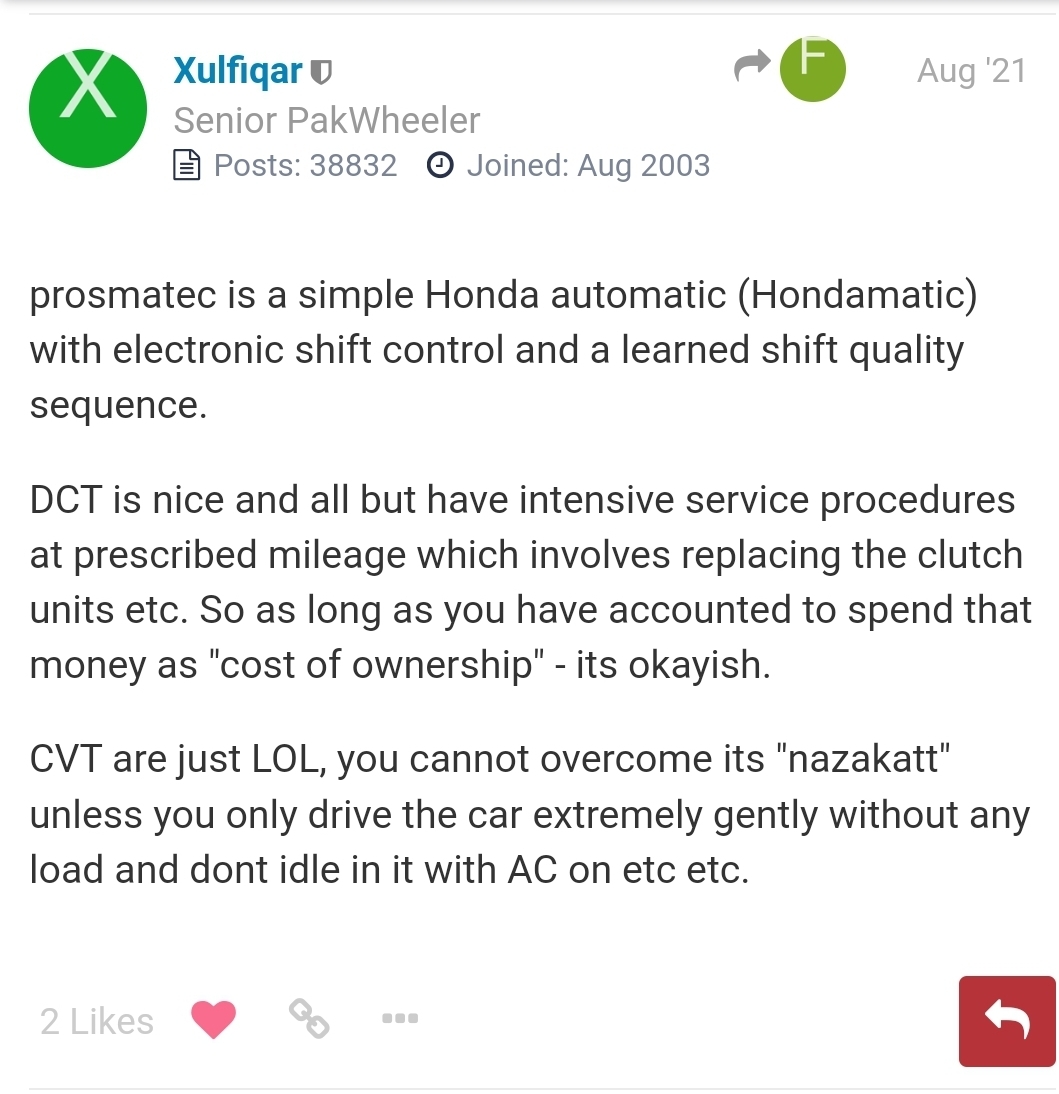

AGS clutch and pressure plates are easily replaceable, and they can be replaced for approx PKR 40,000 from Suzuki dealerships. I am not sure about the complete AGS transmission price since whole transmission failure is not common as mentioned previously. Similarly, clutch replacement for DCT could be done, but I am not sure about the cost. Honda Vezel owners can contribute here. Time will tell how far Changan’s DCT based vehicles can go.

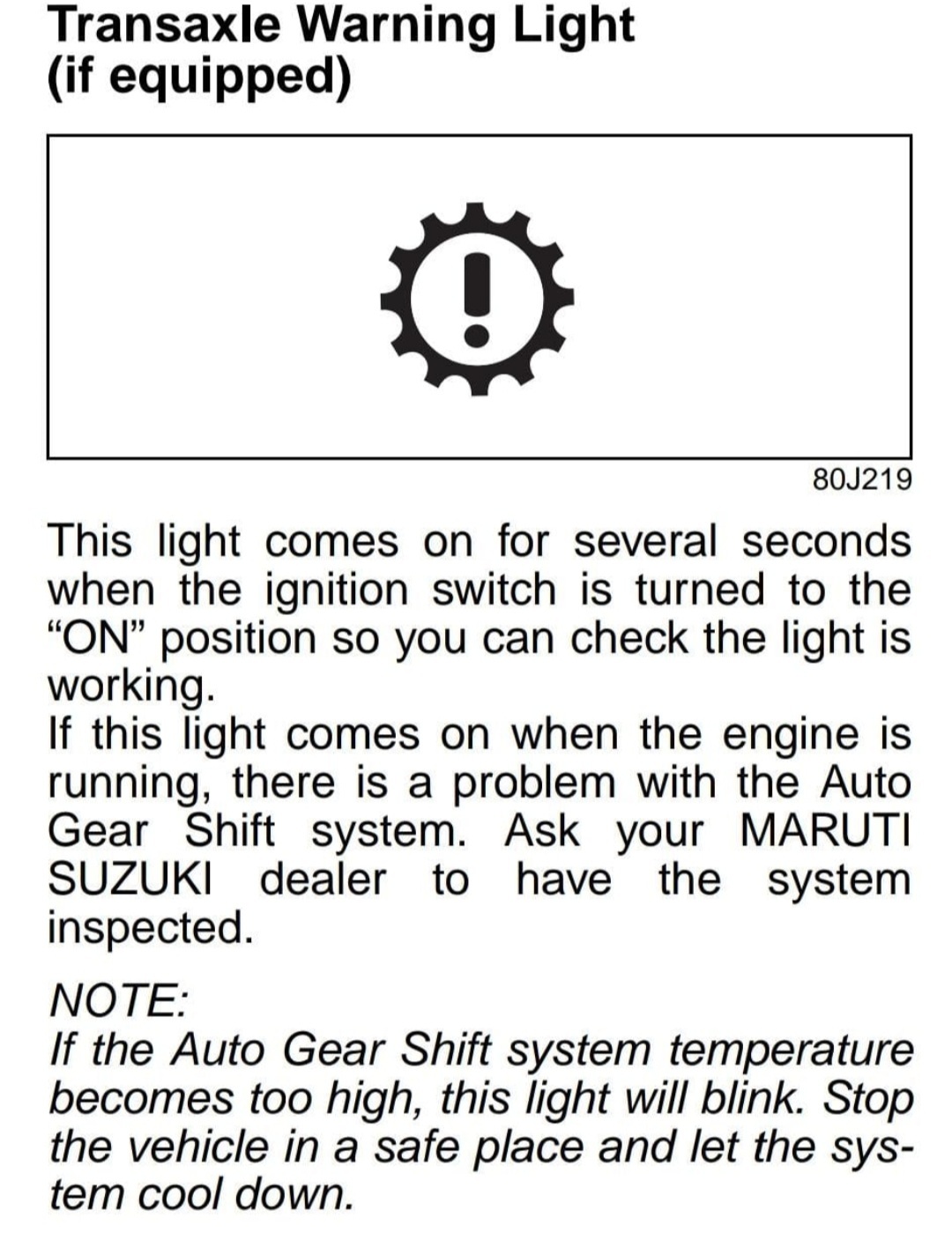

Usually people complain about transmission heat up issue in Alsvin, but this issue is common in all DCT based vehicles. If you don't let the vehicle release the clutch fully in stop and go driving, the clutch will heat up, and a warning sign will appear in the dashboard cluster. This issue can happen with Suzuki AGS as well, but Suzuki vehicles don't show any heat up indicator in the dashboard cluster. You can avoid this issue by adjusting your driving technique, specially in stop and go traffic. Avoid frequent accelerations and let the distance between your vehicle and the one in front of you increase. This should be done to give the transmission a chance to fully release the clutch. Apart from that, it's better to use manual/sports mode in such situations to avoid frequent changing of gears in stop and go traffic. If you don't use manual mode, the computer will not shift to lower gear and tries to pick speed by slipping the clutch.

When people move from any other transmission to a CVT based vehicle for the first time, they don't like the initial acceleration of the vehicle. When you press the accelerator, the actual acceleration starts with slight delay. This is known as the rubber band effect. Many manufacturers have fine-tuned their transmissions to reduce this as much as possible. So it depends how much rubber band effect you face based on the vehicle you drive. Some have negligible for a common man, and some have a lot.
