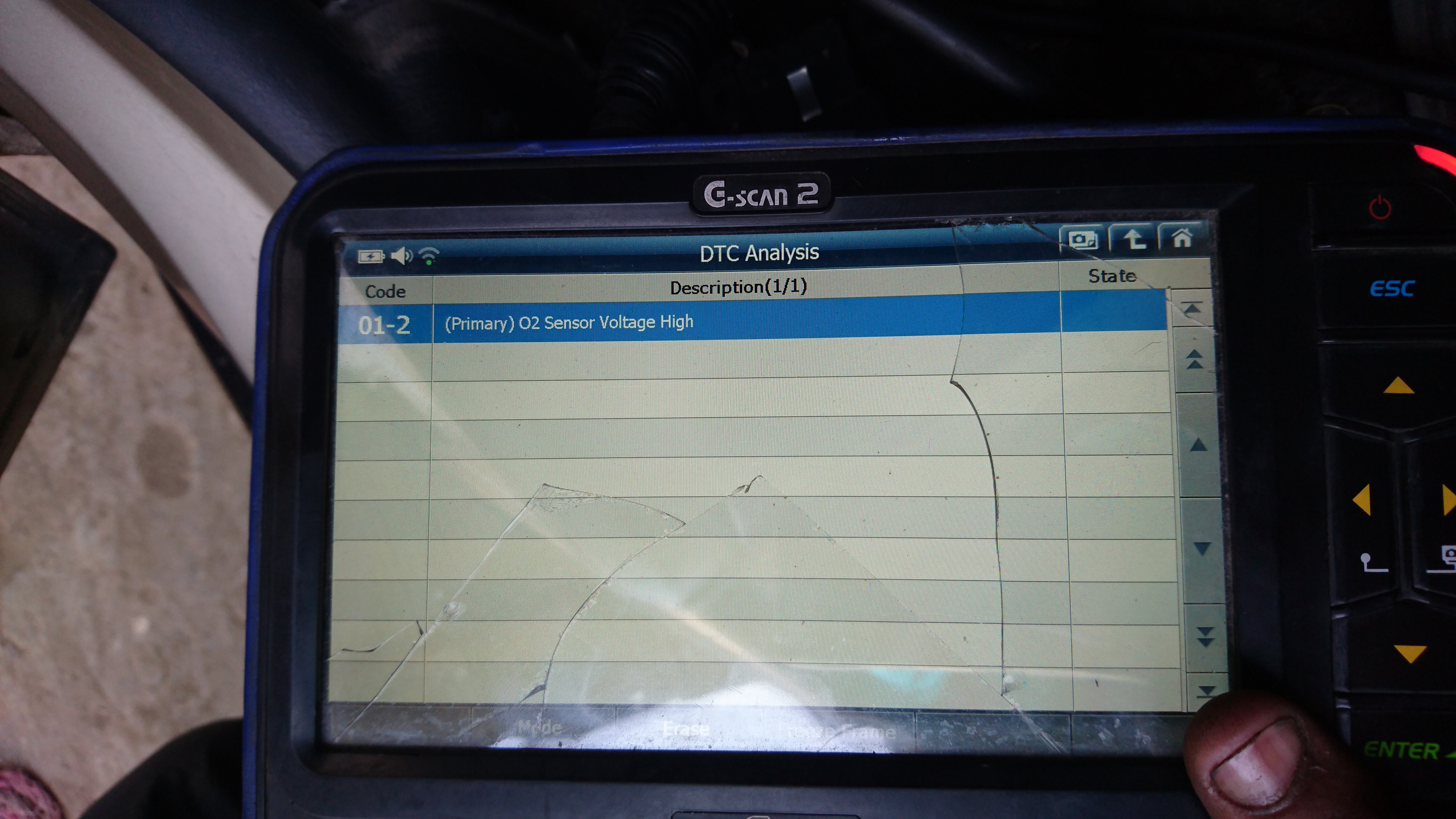

I have a d15b dual Vtec engine in my car and when I bought it it was running with original ECU. The car was consuming a lot of petrol and the power was not that good because the V-TEC were not working.
So I did a little research and read A fee topics on Pakwheels and finally decided to change my Ecu unit to P2j j63 or P2j j62 since my car is 4speed Automatic transmission.
I went to mithu Khan ka ahata in Rawalpindi and tried Ecu P2j j63 and the car was not running well and the performance reduced with that ECU, then I got p2j j62 and the performance got better, then the I took a test drive and the car felt much more powerful specially after 3200 rpms. There is no check light/fault code. Initially car was giving code 38 of second Vtec but that was resolved when electrician plugged the wire in correct pinout of the Ecu.
I asked the electrician if my car needed an O2 Oxygen Sensor but he said that its not required and the car ia not giving any fault code for that but if you want to install it can be done.
Is he right that all D15b dual Vtec engine don't have o2?
