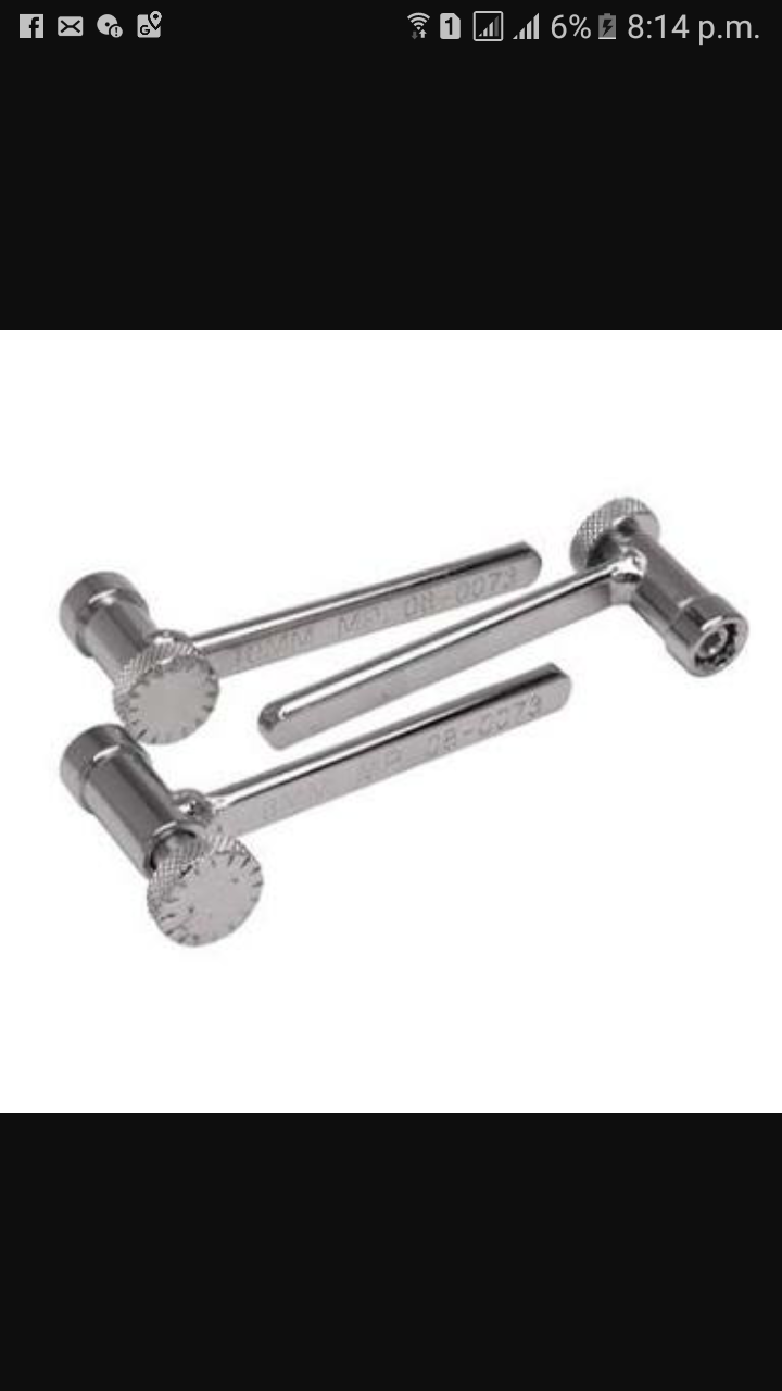

I finally got rid of that tik tik sound. I just right the exhaust tappet near 12. Fuel average is better than before but RPM isn't stable like I want it to be.
I will visit Bilal ganj tomorrow to get special tool for mixture screw setting and also will get tappet T to hold the tappet at specific position during tightening. Previously used plier but this is not effective.
