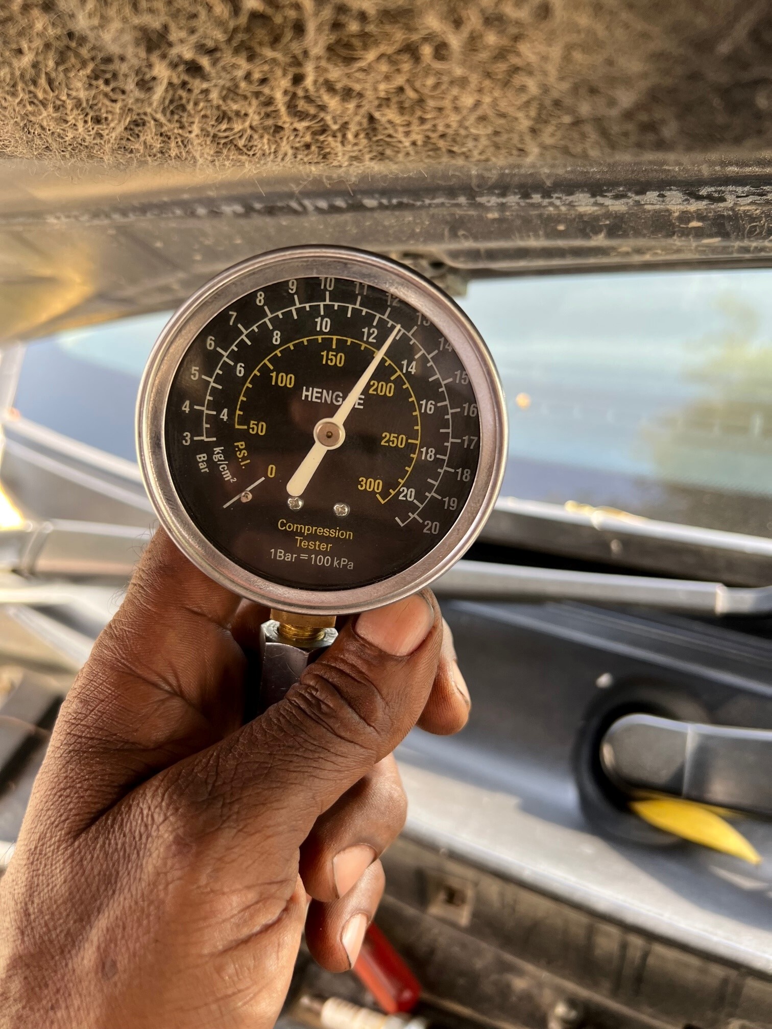

Comression Test.
The compression test on all 4 was between 170 and 180 which is pretty good so we moved to on the next item O2 Sensor.
